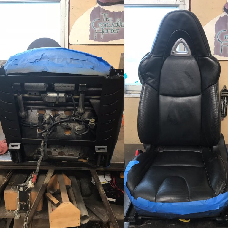

Are these seats with electric seat adjustment and seat heaters? If so, it would be great to hook them up :D

yes.. I plan on getting power to the adjuster motors but havent decided on heaters... not sure I want to be driving this in winter hahah

decided to go ahead and take a chance on the changes I had made to the design of the drivers mount.. tape measure measurements and guesses on the changes and voila... almost sits flat.. it is about an inch higher on the passenger side once seat is on the mount.. tonight I should finish up welding the seat to the mount...

Figured out the power to my driver seat last night.. not using the heated seat part just the movements...
