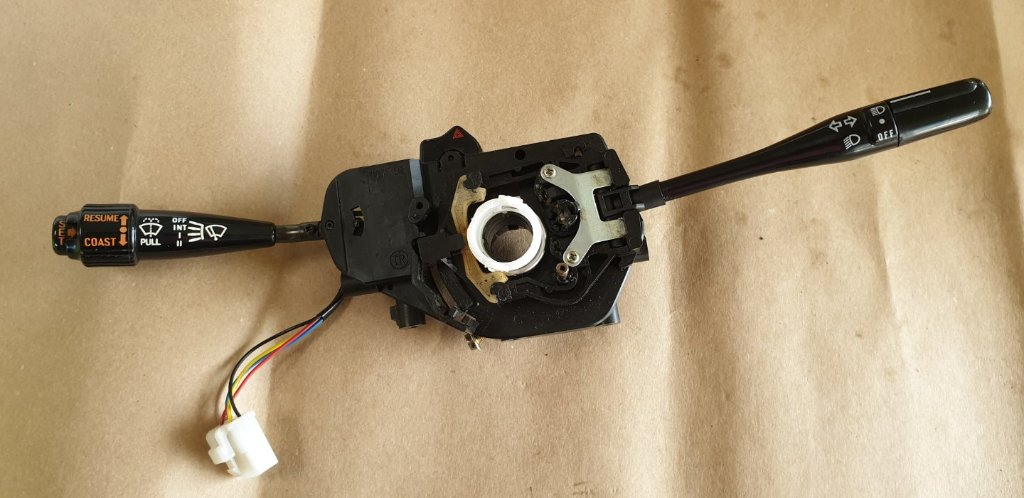

A quick little update which I thought you guys might like.
I rebuilt and restored my combination switch. I have been hunting for years and it seems like all LHD combo switches are obsolete and haven't been available from Mazda for years. I even tried buying one from dealerships in Japan, to no avail.
I found identical stalks from other models (including a HBSHE 929 sedan and the headlight stalk from a Ford due to the parts sharing that was in place in the early 80s!), modified them to fit the RX-7 switch housing, removed and took apart all the switches and cleaned all the carbon off the contacts (headlight contacts were toast as expected) and re-greased all the springs and bearings.
Before
After
I took a bunch of detailed photos and I'm going to do a comprehensive how to guide which I'll publish on AusRotary and link here.
