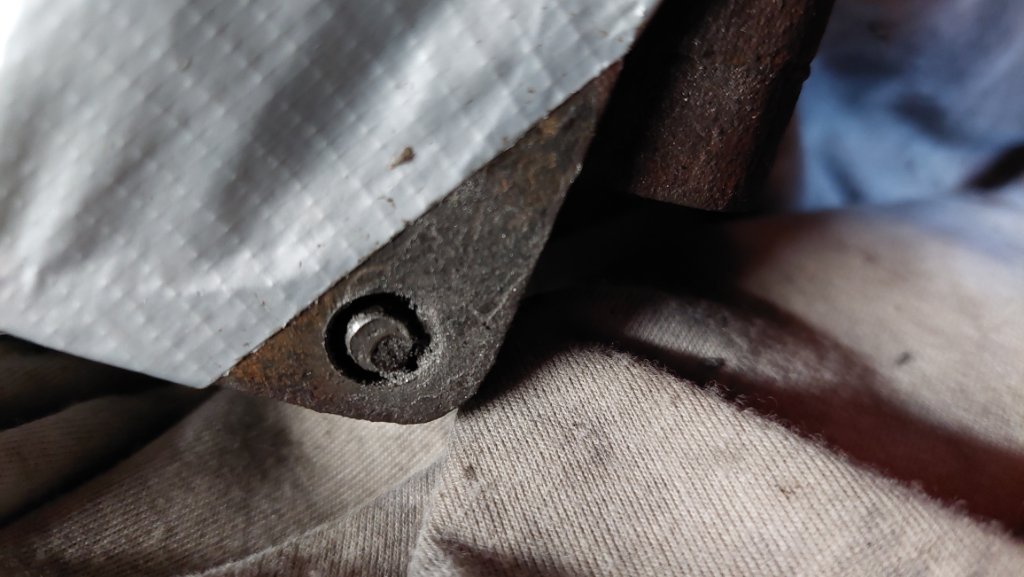

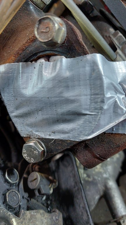

However, I managed to shear the lower thermostat housing M8 bolt, despite being very cautious
I then tried to removed the bolt with an extractor, which promptly sheared inside the bolt
I decided the best solution was to use a JCB Diamondtech 8mm core drill (Toolstation, £9.86) and, if necessay, retap for an M10 bolt.
I got lucky though, the drill bit cut a clean and quite fast core to a depth of about 8mm, which I was able to remove (so part bolt and part extractor gone
). That left a remnant of M8 bolt in the blind hole which drilled out quite easily with a 6.5mm cobalt drill. It was then a matter of retapping/cleaning the remaining. lower part of the M8 thread. To be safe I drilled a few mm deeper into the blind hole and tapped the M8 thread a bit deeper too. It's all cleaned out now and a stainless steel bolt tightens up in there nicely.

I did the same to the lower bolt some time ago.
Fast forward to a few months back and I removed the thermostat housing very carefully to replace the stat and then ended up stripping the thread when reinstalling it

Amazing isn't it, we both knew that there could be issues and were cautious, but both ended up with problems. I shall use a torque wrench when tightening and go to the minimum I can get away with as I only have about 5-6 threads only on the lower bolt. Worse case, if it strips, I will retap for an M10 bolt as there is plenty of metal there.KiwiDave wrote: ↑Tue Oct 05, 2021 5:30 pmI did the same to the lower bolt some time ago.I ended up installing my spare water pump housing as the bolt would not budge
Fast forward to a few months back and I removed the thermostat housing very carefully to replace the stat and then ended up stripping the thread when reinstalling it![]()
