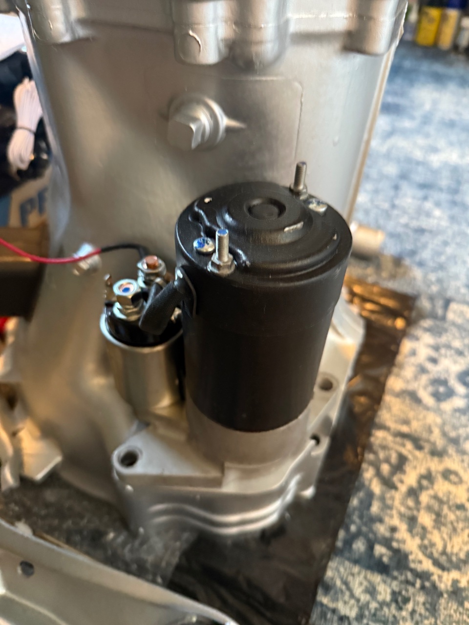

Hey all .. just an update. I bought a S4 2kw starter from the Auto non turbo and swapped the nose cone out for the new 1.2kw one I’d bought. It still bolts up a treat and should give me 2kw of starting power when i eventually put everything back in ….
Re: S4 Starter motor in S3
That should help nicely aye. Looking nice and fresh too :o

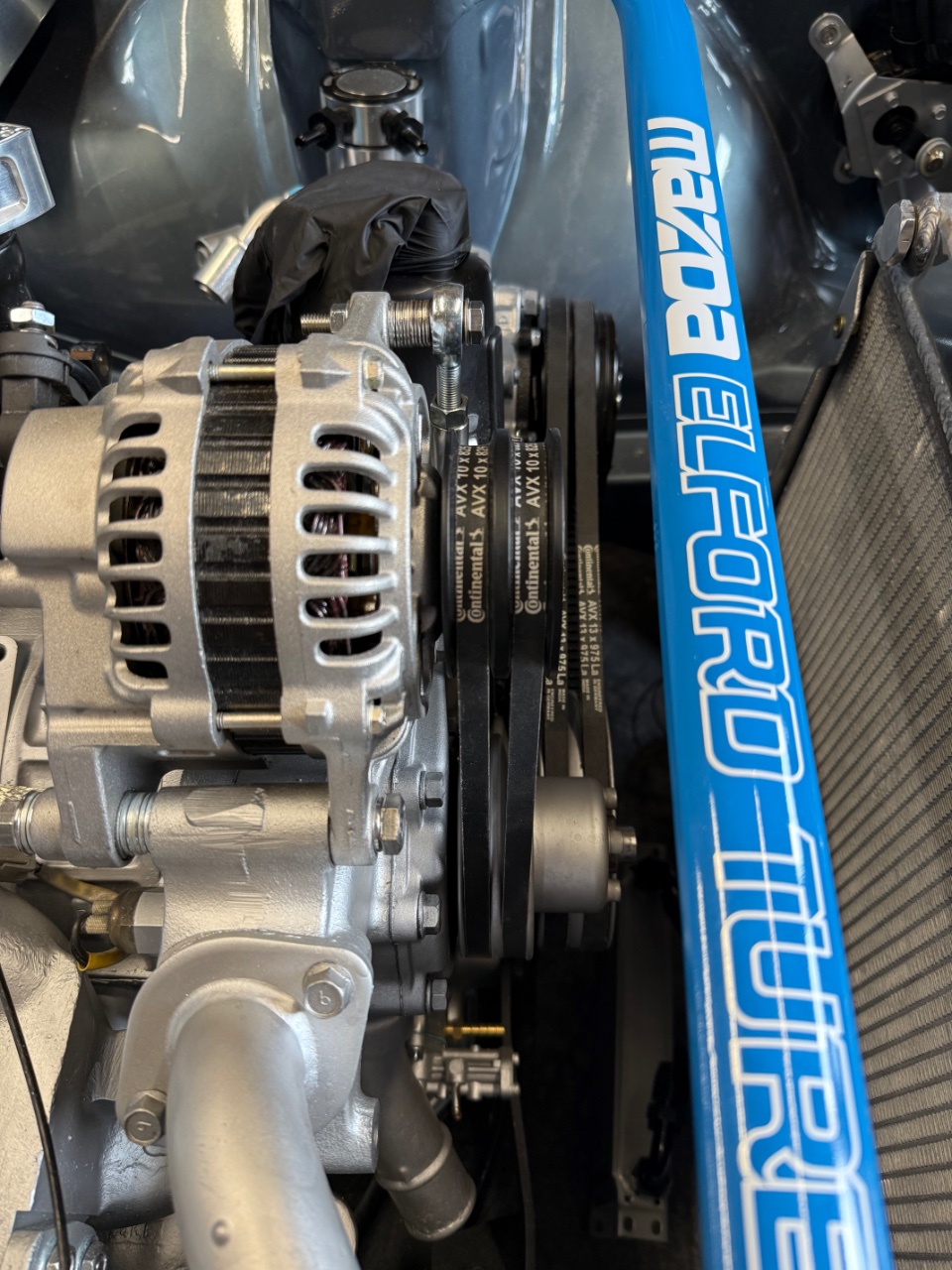

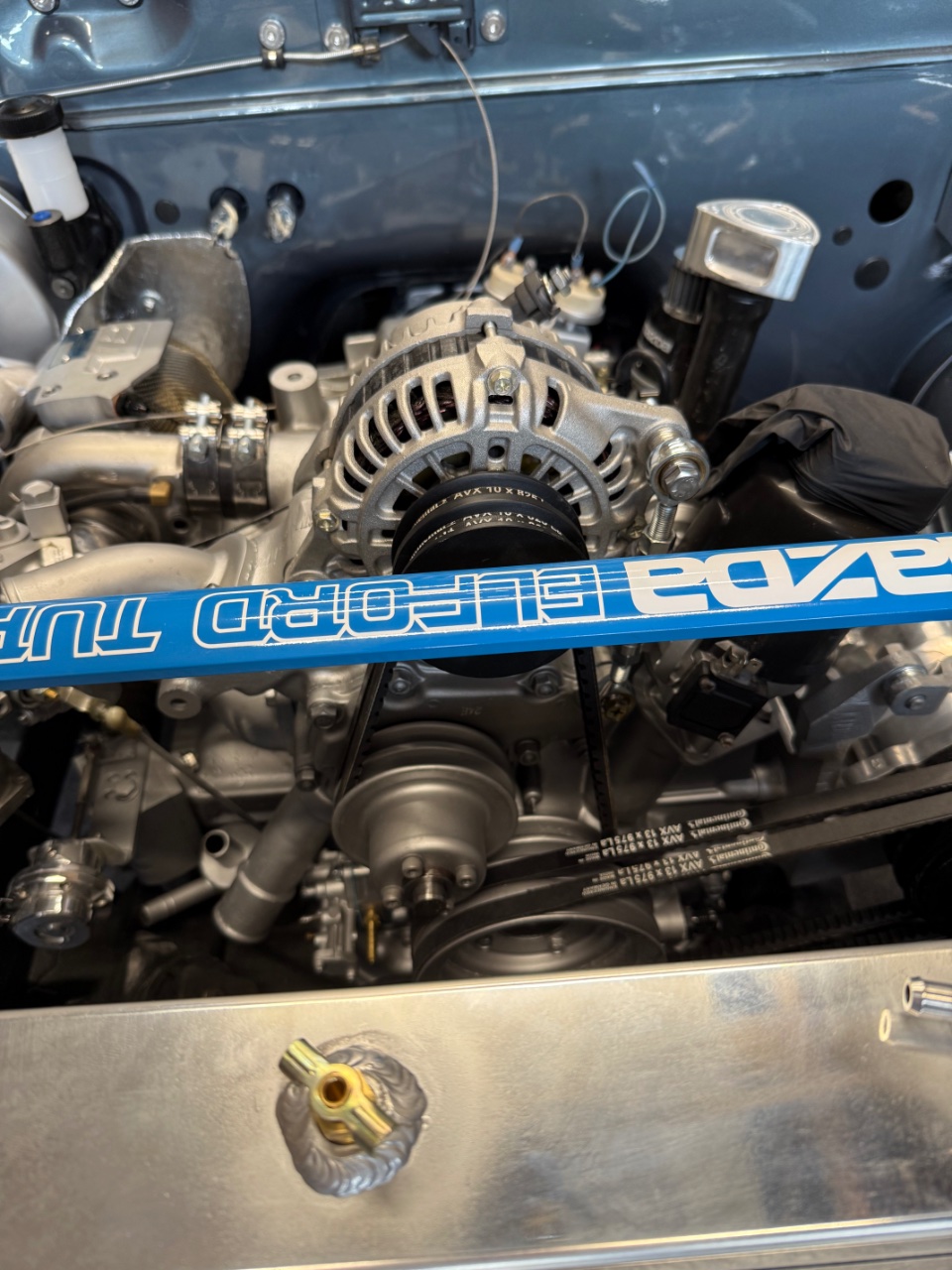

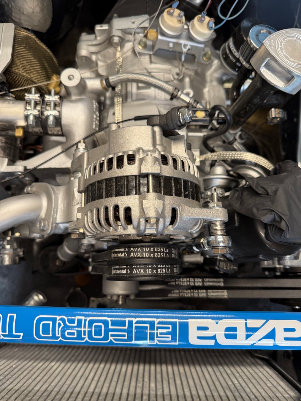

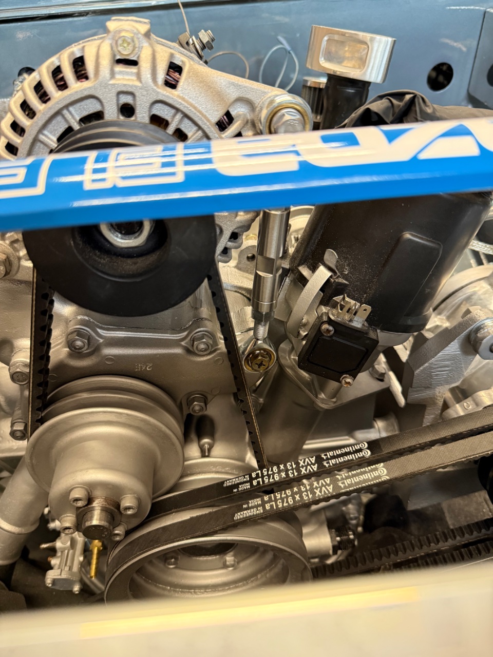

Unfortunately/fortunately, whichever way you look at it.. iv been working flat out this year so haven’t had much time to work on the car.
However…. It’s fitted. Nothings wired up yet as I’m routing the wiring through the wings to keep everything neat and tidy.
The alternator sits lovely.. I eyeballed a pulley which looks like it should work fine.
Iv also used a heim joint to adjust the slack. In hindsight I’d have chosen one about 30mm longer but this one will work fine.
Iv used washers to pack things out for now .. eventually il make spacers up.. but this’ll do for the time being !
The pulleys between the alternator and main pulley, and the aircon pump and main pulley are slightly splayed. But the aircon unit I pulled off the old parts car had the same effect on the belts and this worked fine for years. So I’m not too worried about that!
