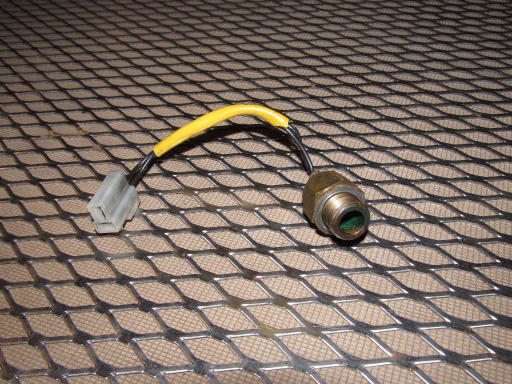

Re: Electro magnetic choke
I had an issue with the choke failing to hold. I was lucky and replaced this sensor and all was good again.
Probably overly simple since your now looking at the ecu
Rich
Rich
- IMG_9265_6fba6a9e-e32e-4989-bb01-a7bdcaba9806.jpeg (279.5 KiB) Viewed 6596 times
I know that water temp sensor is part of the system but I've never checked it out to be honest. I should probably just replace it anyway. Where did you source yours from?
Only investigating the ECU because the fuse is known to fail sometimes and it forms part of the circuit according to Tim at RX Motors.
Mine came from Jimmy's and is barely held together, they're quite rare to get as they're fragile now and the wires brake in the same place mostly. I'm sure in this day and age they're must be something similar that could work in it's place.
On my car the system worked fine I till I took parts off, broke the wire , so the cause was simple to diagnose... Self inflicted
