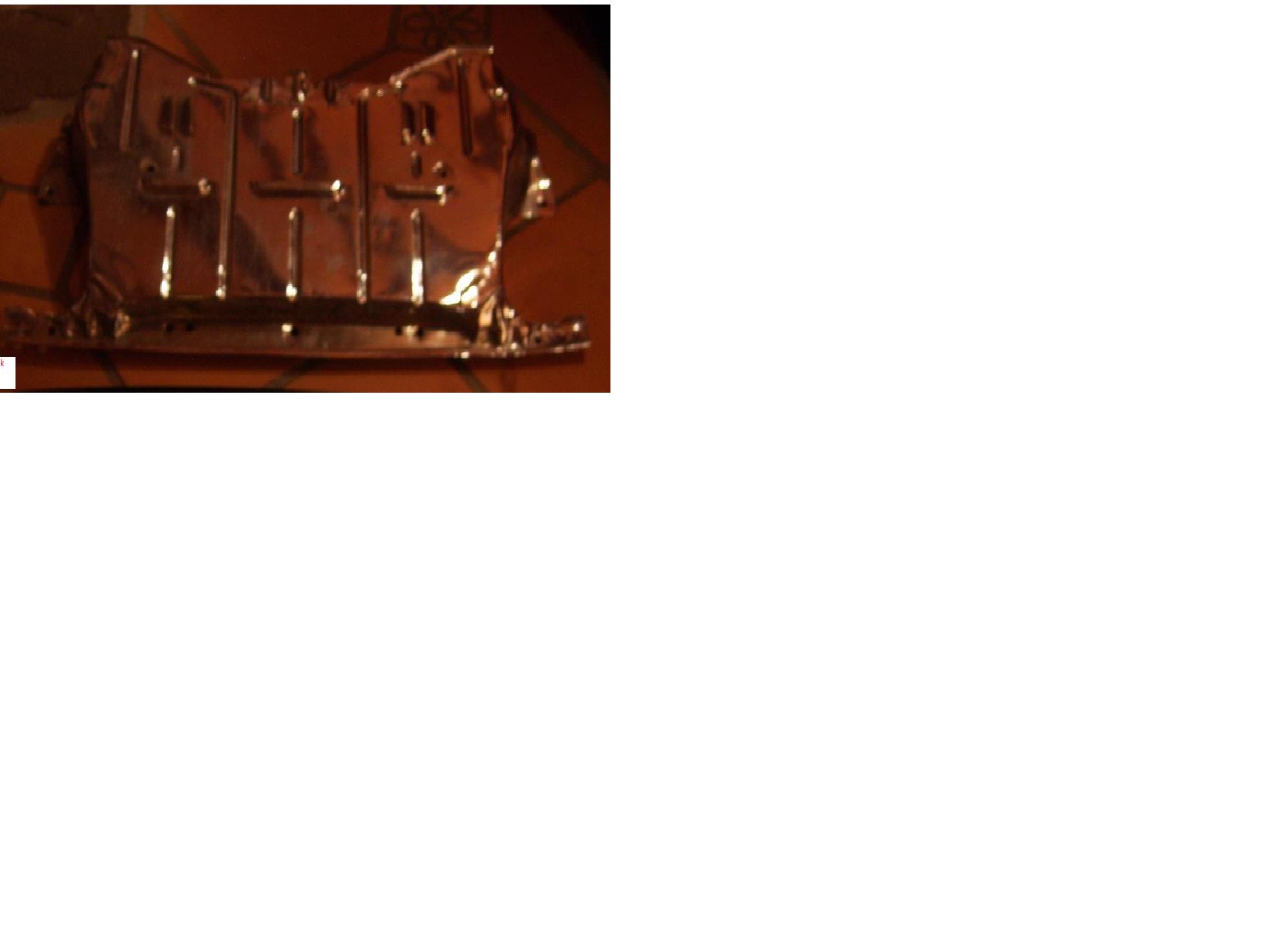

What do you think about german untertray?
- undetray.JPG (82.17 KiB) Viewed 3845 times

Re: Nars GSL-SE the 'White Comet'
ooo shiny! I'm not a huge fan of chrome though. That's not stock is it? (I have little knowledge of what they did with RX7's overseas)
- Posts: 1895
- Has thanked: 473 times
- Been thanked: 253 times
>I'm not a huge fan of chrome though<
I'm a huge fan of durability so I benefit from sth. what I doing cheap 25 years ago.
mazda make a lot of parts only yellow passivation you know. This is not as good as chrome.
