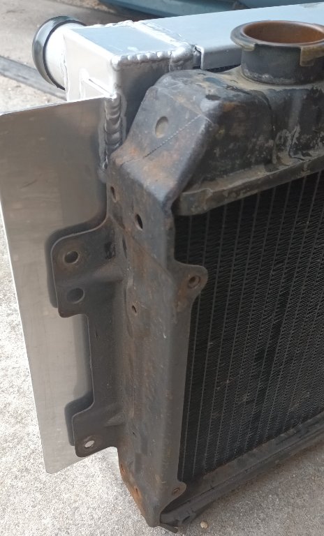

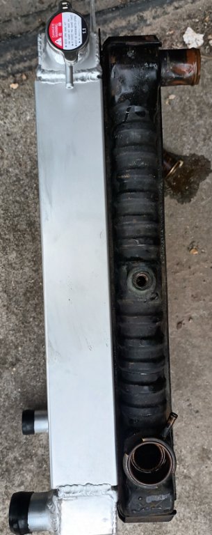

Oh and the Mazdatrix race radiator I fitted, when I added coolant, has a hole in it, so that needs a bit of welding this weekend. Is the car trying to tell me something ? Oh and don't believe that it will just be a straight, fit the end brackets need a bit of sculpting and drilling to fit.
Ok, I will have a spare set at the end of the work that will be rough, but if it gets the car back working, it's only money into the pit.
