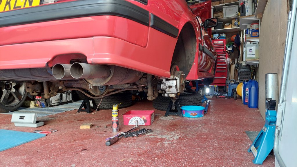

First task was to crack the wheelnuts all round and get the car up safely on stands, then all the wheels off.

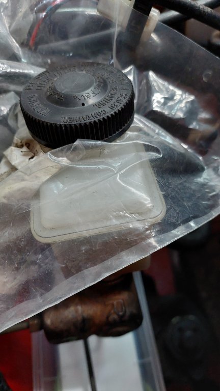

To stop the fluid leaking out too rapidly when removing the hoses, I placed some plastic under the master cylinder cap to create a vacuum.

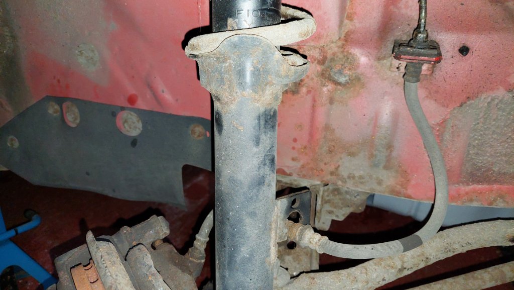

The next day I applied another dose of penetrating fluid to all the fixings and then started on the front passenger side by removing the spring clip holding the centre hose support to the bracket on the suspension strut. The hose can then be freed by jiggling the hose support forward, then down through the notch in the bracket.
(Driver's side shown)

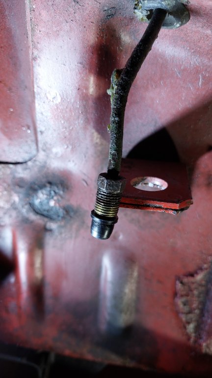

The next step was to crack the flare nut on the bulkhead bracket and the hose into the caliper. Using a good quality flare spanner was essential, as the years of exposure to road grime had created quite a bond between the hose and the flare nut and they were reluctant to part. Once both had been cracked, I unscrewed the flare nut completely, capping the end with a bleed nipple cover, which successfully stopped it dripping. The spring clip can then be removed (tapping with a screwdriver and hammer needed!), and the hose fixing pulled out:
The hose can then be unscrewed from the caliper end and removed.

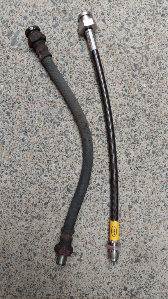

The HEL hoses look to be well made and are a close match in length the OEM hoses. The only perceptible difference is that the front hose are about 3-4cm longer, which shouldn't present an issue. I will carefully check for any possible rubbing or snagging after fitting. Here are 3 of the 5 hoses; front, rear and axle mount. Fresh copper washers are provided.
The centre support on the HEL line is not fixed, but can slide along the hose. There are some plastic clips provided to attach both sides of the hose. When in position, these restrict movement. Instructions for positioning/fixing these "stops" this are provided with the hoses.

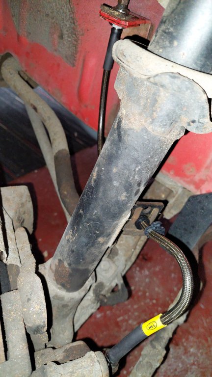

One snag arose in fitting the front hose into the bulkhead mounted bracket - the HEL fitting was about 0.5mm larger than the hole in the bracket. This required the use of a Dremel grinder to take off a very small amount of metal. After that, the new hose was bolted with the new washer onto the caliper, the centre fixing fitted to the strut mounted bracket and the other end fitted with the spring clip into the slightly enlarged hole on the bulkhead bracket. The existing flare nut screwed easily into the new fitting, just requiring a bit of a careful clean up of the few ml of fluid that inevitably was lost in the process.
The last step was to fit the spring clip into the centre mount and check the hose position by turning the steering wheel to both extremes before affixing the two plastic "stops". I'll need to re-check for clearance when the suspension is compressed later.
No further issues were discovered in fitting the front driver side hose, just the same need for a bit of Dremelling.
