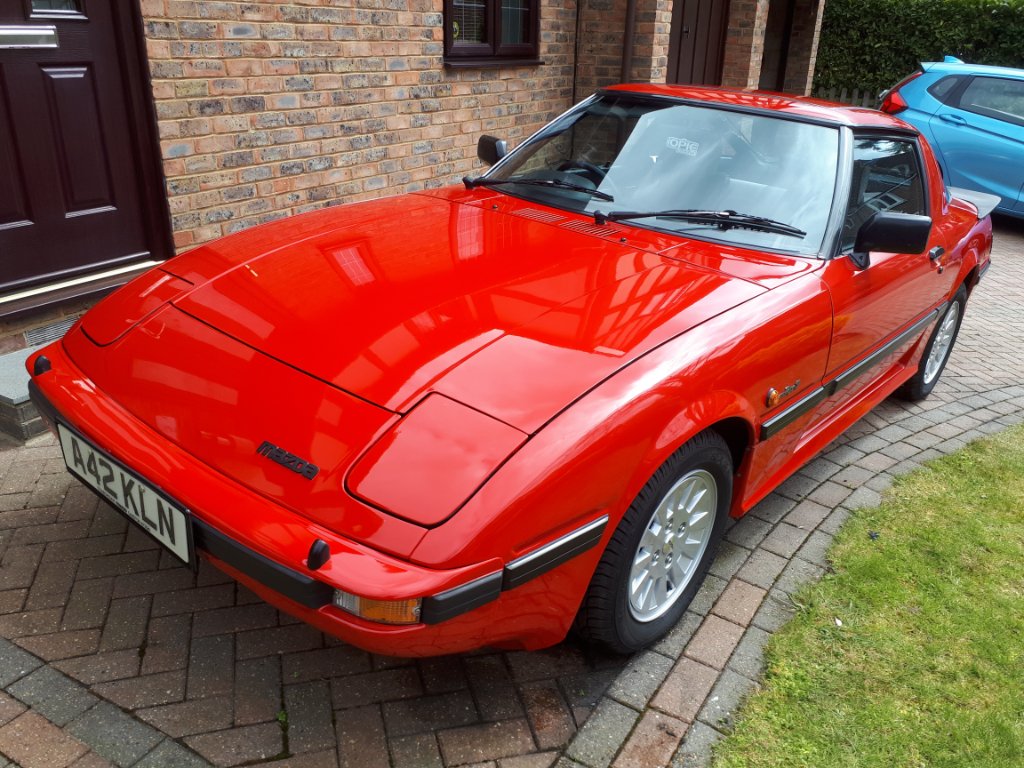

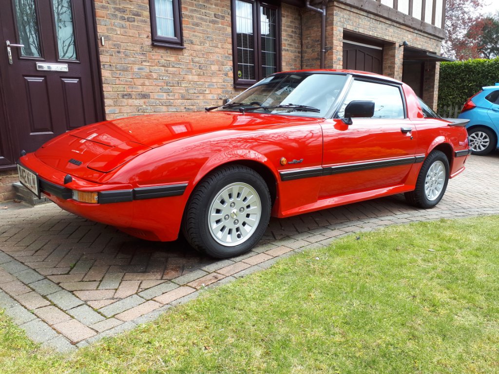

Just trying out Meguiar's Hybrid Ceramic Liquid Car Wax. Easy to apply and buff off by hand. Impressed with the results
Re: KIMI 3 - 1984 Series 3
holy moly Malcolm, that looks like it's just been sprayed
..... top work man!!!

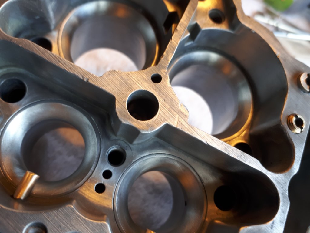

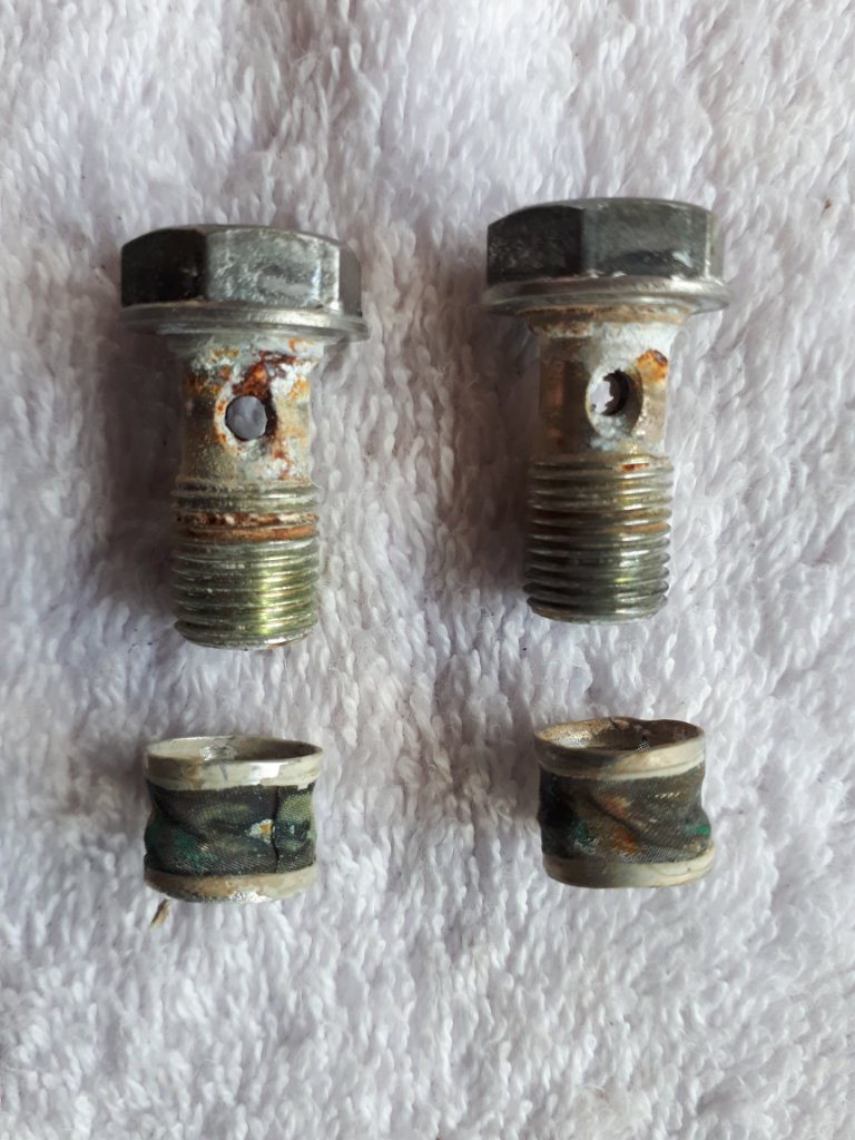

My spare Nikki carb cleaning saga continues - very therapeutic
I will try cleaning up these fuel meshes in the ultrasonic cleaner, but I'm thinking it might be best to ditch them and place an in-line fuel filter in the supply hose?
no, don't ditch them, they catch the miniscule particles of rust and dirt that manage to sail right through an inline filter..... without them this stuff will go into your carb & engine.
It's surprising that anything gets through an inline but it does. Gently gently clean them up and reuse them.

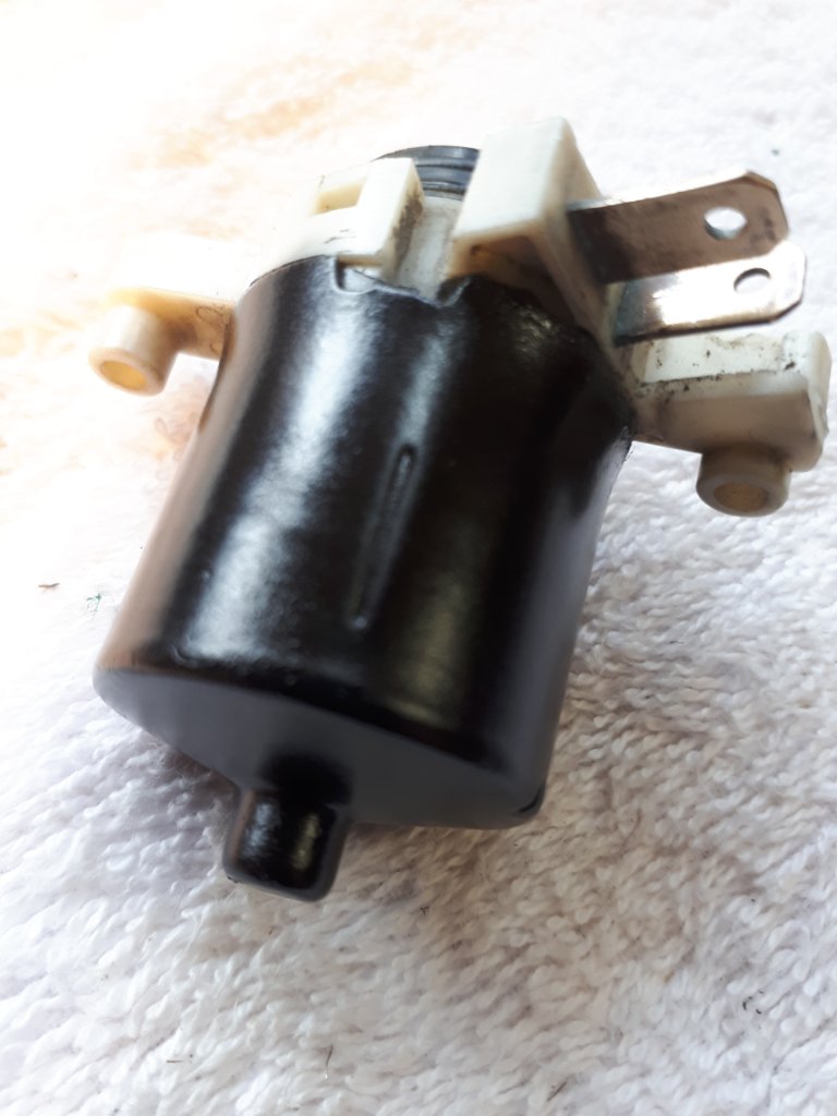

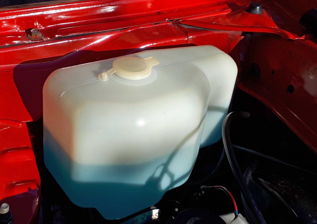

I have sorted out the motor on the front windscreen washer, which had stopped working, as mentioned on the previous page. It just seemed to need a good run on a bench battery and it seems fine. I cleaned up the casing and the electrical contacts, plus I sprayed the motor casing with some black paint. I also cleaned up the washer bottle with some "citric" cleaner I had in the cupboard, aided by toothbrush - boy, was there some crud in there
I applied two lots of epoxy glue around the pinhole leak too. That seems to have worked - everything is back in, working and no signs of any leak after standing for a few hours
It's looking and working as good as new - a small thing, but very satisfying
