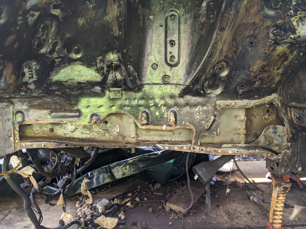

This was where I think I had left this section
We progressed to this; after removing the spot welded panel..

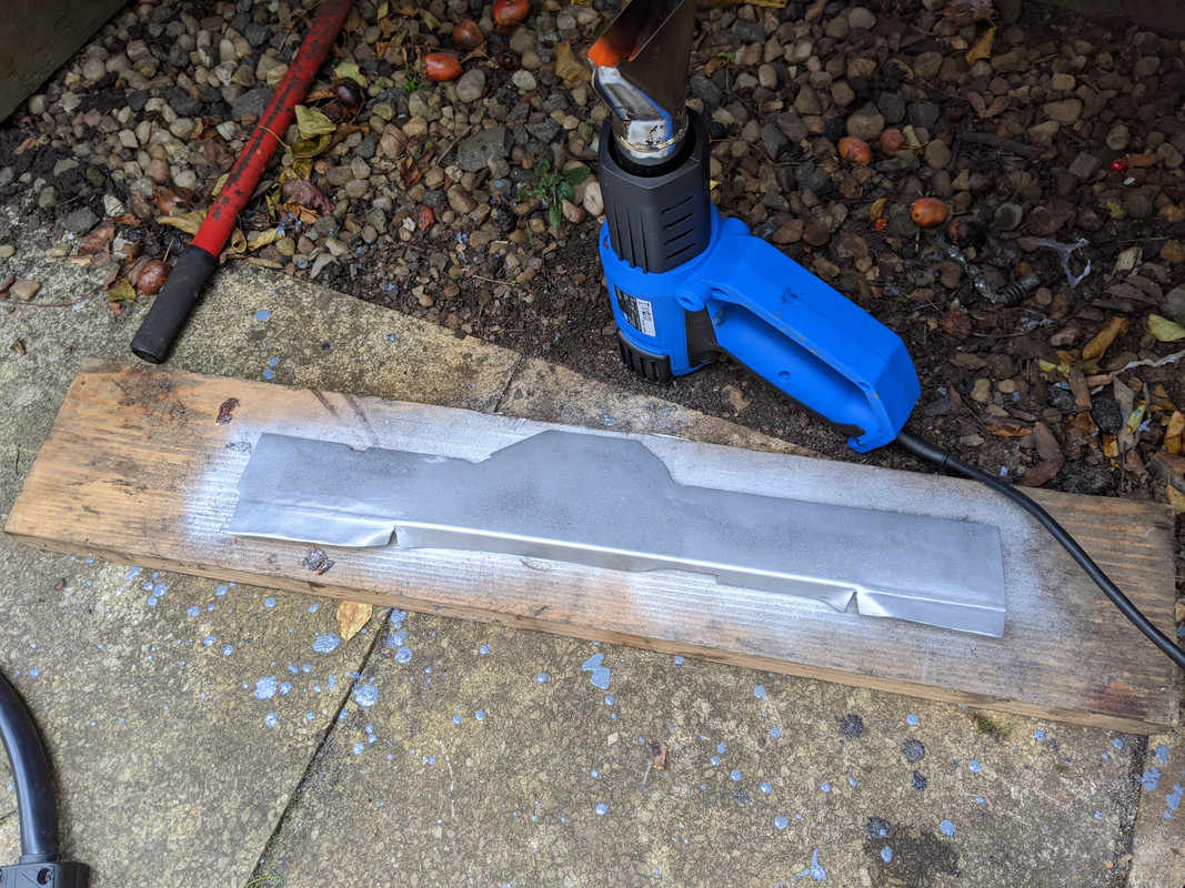

Some light grinder and hammer work

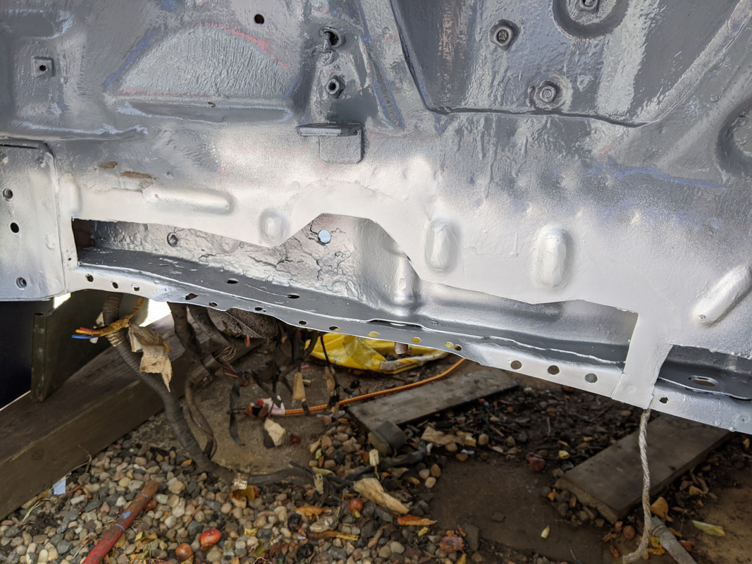

Coated with 2k epoxy primer. Still to be painted...
The other side is done too, but these are the photos that have gone walkies... Oh and this arrived

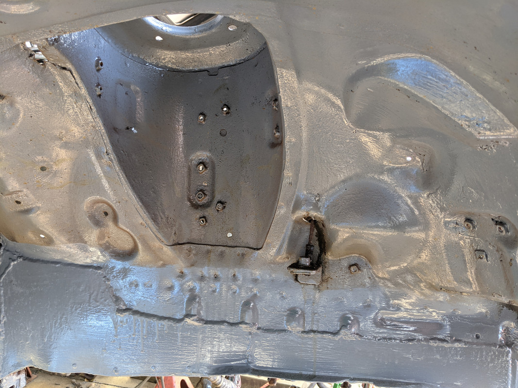

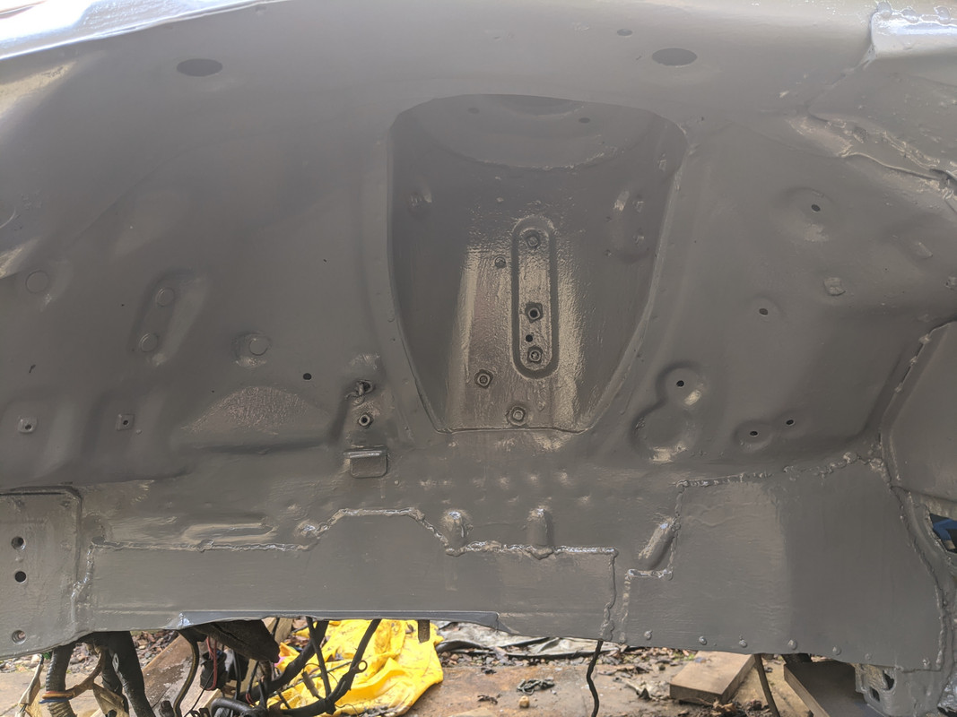

And just to prove the other side is done too...
I'm hoping to keep this moving alot more regularly now ..
Edit-the brush painting is rough!! I may have to sand and repaint a little
