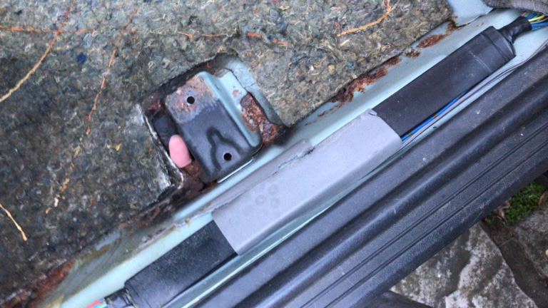

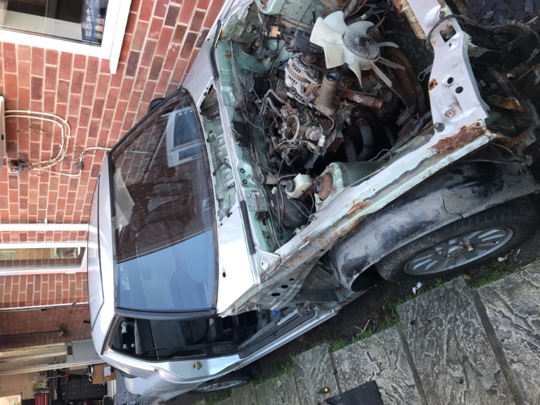

After a couple of months of avoiding rain and cold weather. I decided to roll Homer out of the garage to create room for what’s coming off ready for sandblasting and welding. Especially while I ‘work from home’.
Safe to say, I didn’t expect to find as much damp in the needle felt under the carpet as I received... but that might be down to sitting outside for 5+ years with a boot that didn’t latch.
Pictures attached for your enjoyment folks... some of the rust has displayed itself in places I didn’t think possible, like the driver seat mount. Both rear tubs have been patched too, but for some reason, they just plated over the rust??
On a side note, where do people go for replacement nuts and bolts? No amount of WD40 is saving some of the bolts I’m taking out, 3 of which were from the 4 holding the rear bench in
More to come over the next coming days! Stay safe everyone!

Yes RX7 forum is a good starting point... KevinBTZ has a good write up on doing the rew/cosmo swap... he built my REW engine and I did everything else in my resto/build.. see my thread about 2 down from this one... (or click - http://rx7fb.com/viewtopic.php?f=4&t=4049 )
Also DreaminRotary on the RX7 forums has some extensive write up somewhere on the s4/5 swap... He is local to me and one of my mates.. small circle here in MN, USA...
as far as the rust, if you are going to pay out your butt for someone to weld it, I would say spend a little of that cash and buy a semi decent wire feed with a gas tank and learn to weld... maybe buy a small metal brake that can handle sheet metal at the thinner gauge.. practice practice practice... in the end it will be rewarding and a learning experience...
then you can sell your services to fellow people who are in your position and pay for it all hahah
good luck mate..
