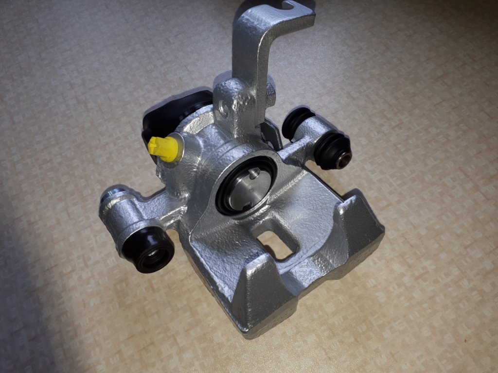

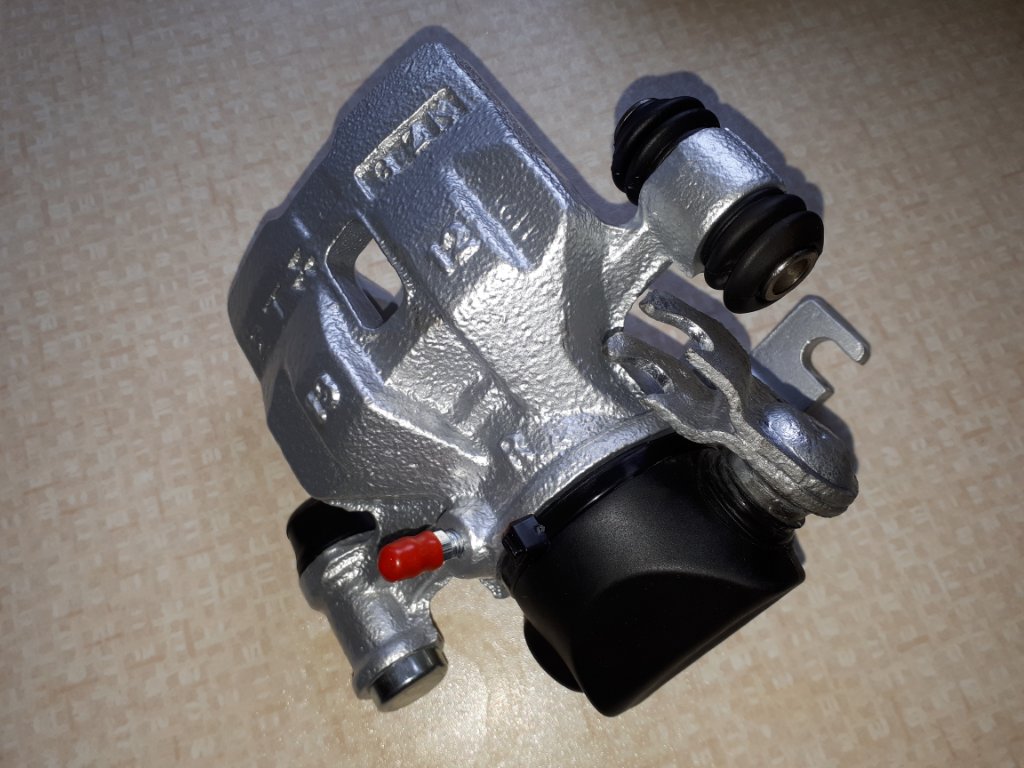

Refurbed caliper back from BiggRed, £107.40 inc VAT and shipping to me, using their premium paint finish (rust prohibitor, two paint coats and oven cured). Very pleased with the visual quality and the fact all the rubber items have been supplied too.
2019-09-09 12.42.28.jpg (161.76 KiB) Viewed 13386 times
2019-09-09 12.42.00.jpg (151.36 KiB) Viewed 13386 times
I refurbed the carrier using VHT silver paint from a rattle can I had lying around. Not a perfect match, but a heck of a lot better than where they started!

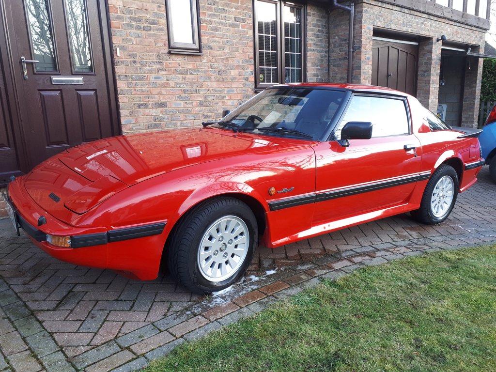

Finally had some half decent weather today to give KIMI 3 a quick spruce up :thumbup:
The photos flatter, but she has scrubbed up quite well :D
