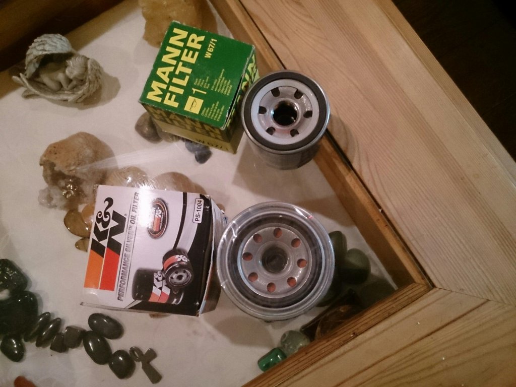

In cold climate an Bypass valve and return valve are Interessting.
Mahle show a nice vid.

Red rubber inside the 8 holes of the K&N show the return valve. Both oilfilter show the bypass valve inside but different number of oilpassages.
