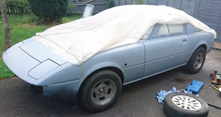

Very true, but i have managed to purchase a set for £70 with new tyres and the offset i want.
I know you can get 4x114 ones but to find them in the offset im after for the price i can afford is a bit tough.
However, that being said.
I have spent approx 2 hours drilling and managed to do one side.
Quite happy with the result.
Also means i now have the choice of running 4x108 or 4x114 in the future, opens up options
(excuse the primer, shes awaiting a lick of paint!)

Re: Slot mags?
They look good, I always loved these, you will have to get a good Alu polish & a tub of lateral Epicondyle lubricant before you start
