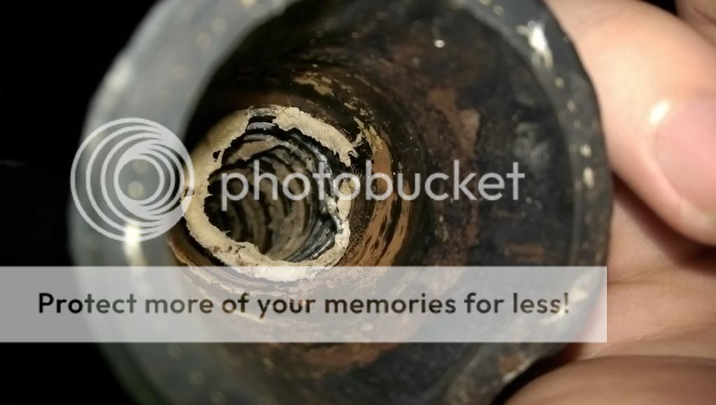

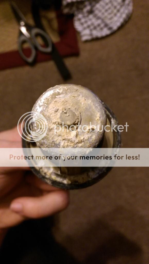

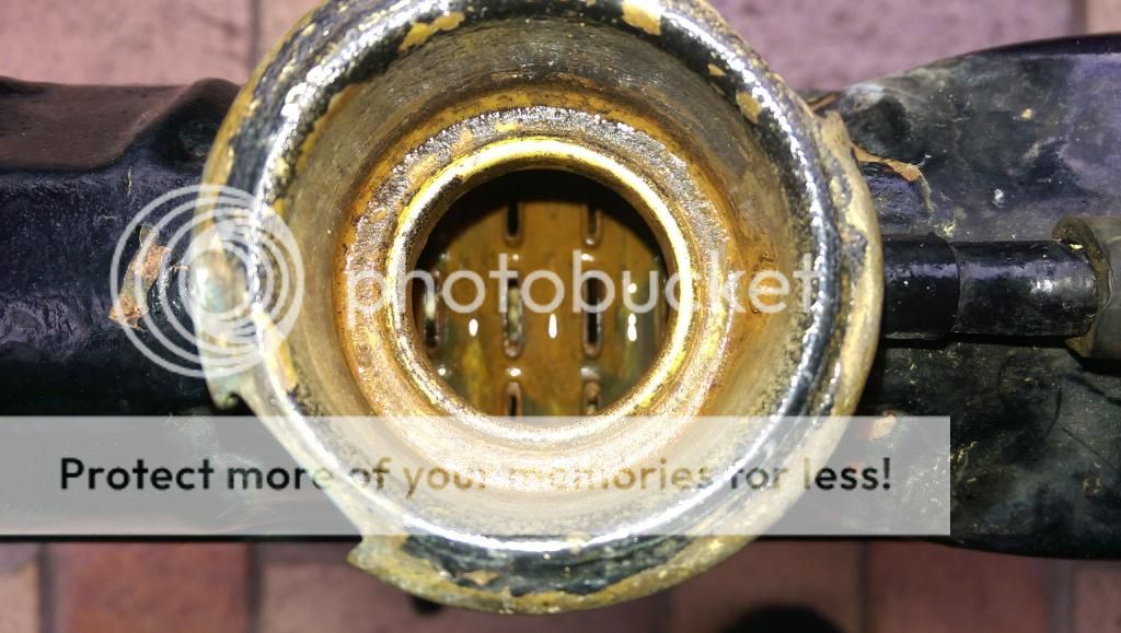

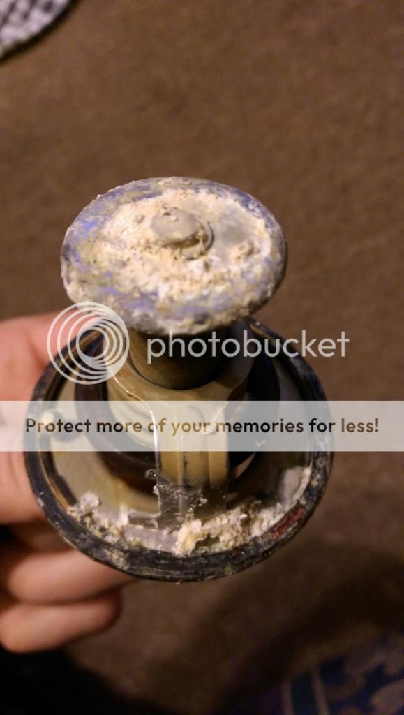

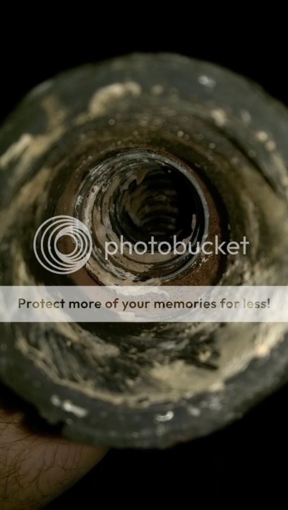

Some pics taken after flushing the radiator with rad flush.....
Inside the Rad
Thermostat
Lower Hose

Re: Water Jacket Flush
That looks like sometign else altogether.
The white crystalline stuf doesn't normally look like that.
I'm not sure why it forms.
That looks to me like one of those proprietary radiator sealing gunk applications... like Radseal or whatever. Y'know, for lazy thick people who CBA to fix a leaky radiator properly? They put a dose in and it doesn't fix the leak so they put in another... and then another... and then the leak does stop largely because the entire system is choked with that crap
When I was blighted with MR2 ownership, it had been abused like that by the previous owner (though he did at least admit it). IIRC it took the best part of two days of pretty much solid flushing through with a hose to clear out the crap. After several hours gouging it out of every orifice I could access with a screwdriver. Honestly, words fail me at the barbarism people inflict on their car engines :evil:

Now that you mention it Lucky, it does look like that radiator sealer stuff....
When I bought the car I did find a pin hole leak in a small piece of pipe used to block off the water feed on the s5 water pump housing, could be related.
Also I noted on some of the radiator flush products, they recommended using their radiator system "conditioner" but didn't like that idea as it looked to contain lots of particles which looked like fibres.
Just hope I can get it clean as the motor is running so smooth at the moment....
