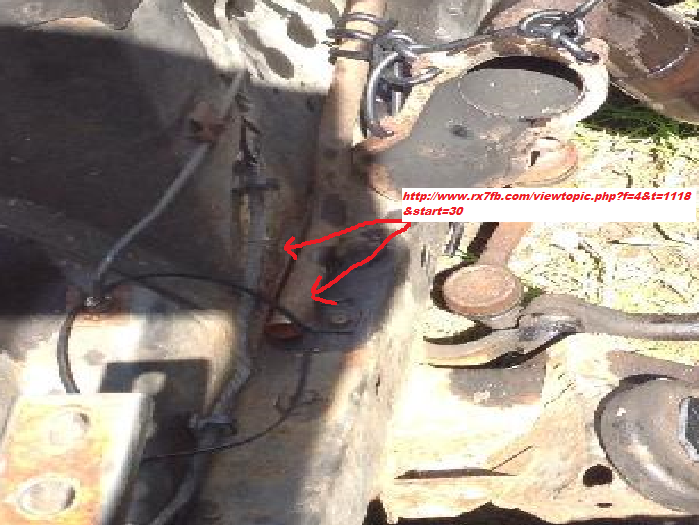

Chud wrote:Outdone my original schedule
Going to see my friendly fabricator tomorrow.
Hot and cold everytime produces rust, water consende outside the heater pipe. All Rx7 Fb I saw all over the 30 years same problem
equal what year of manufacture . But not mine :lol:
check my side what you have to do.
