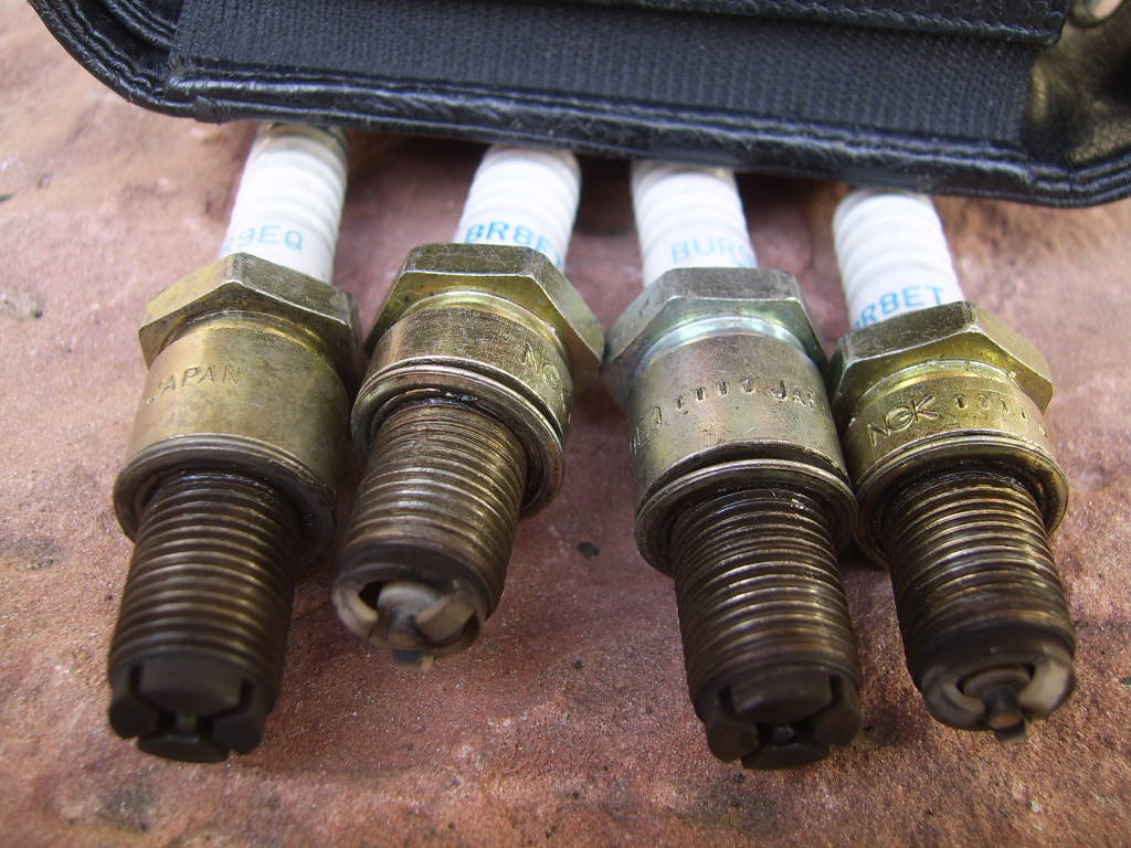

NGK BR8ET after 100km
- Posts: 1895
- Has thanked: 476 times
- Been thanked: 253 times
- SV100229.JPG (174.68 KiB) Viewed 5392 times

Re: NGK BR8ET after 100km

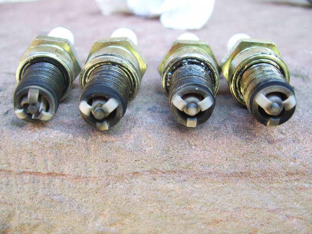

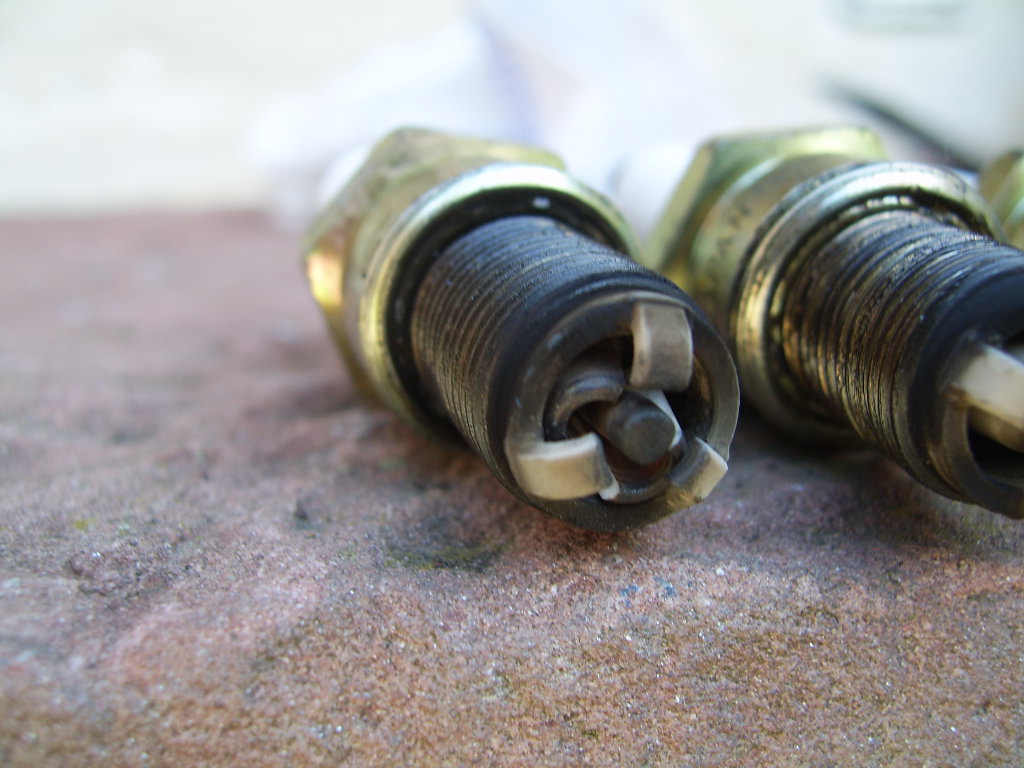

Needs more fuel first, then use the colder plugs.
- Posts: 1895
Re: NGK BR8ET after 100km 12A Bridge Port
change the nikki primary jets from 93 to 110 (Venturi 20 to 22mm) and the leading sparks from BR8ET to BR9 EQ Next I change the trailing spark to BR9ET I think.RamoNZ wrote:Needs more fuel first, then use the colder plugs.

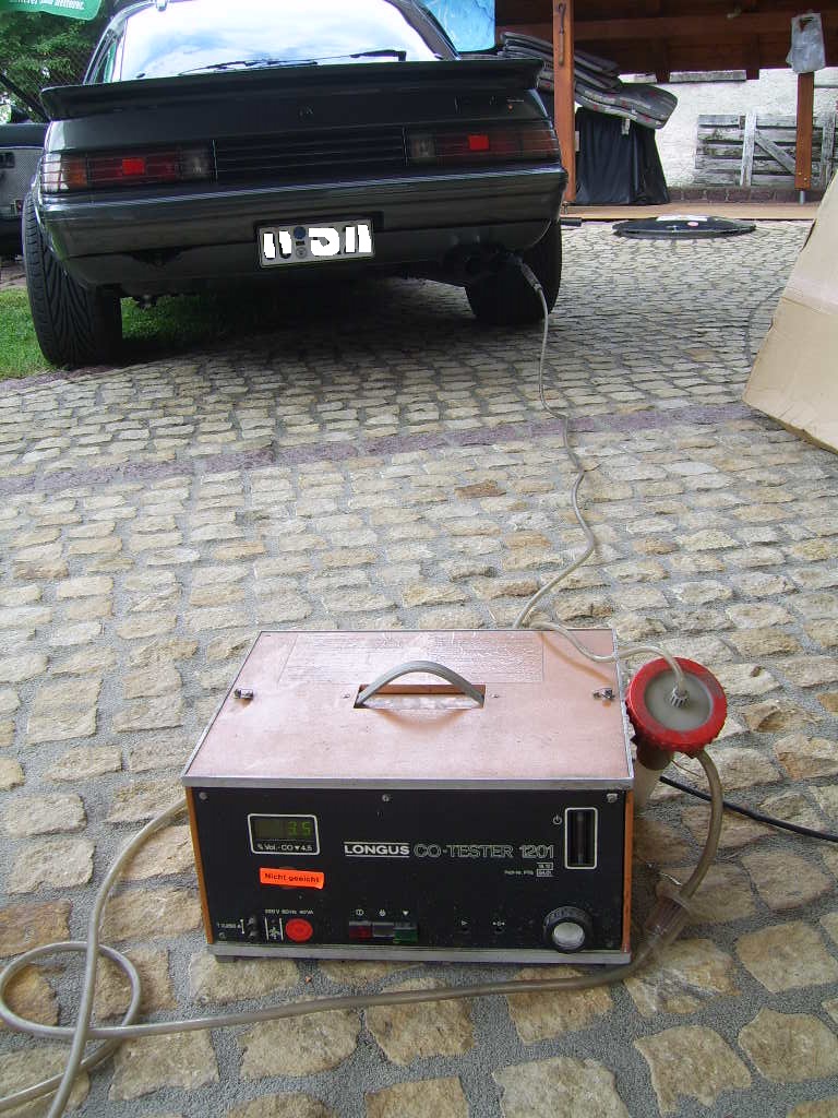

Today testet primary jet 123 mm secondary jet 170 mm trailing BR9ET Leading BR9 EQ same sparks as before.
carbon monoxide tester hot engine
1700U/min 2%
2000U/min 2,5%
3000U/min 2,5% short time before the mechanik secondary opens 2,0% then 2,5%
After this the nikki let the engine idle at 1600U/min 1,0%
testet greater primary jet 140mm result in smaller carbon monoxide at idle. Don´t know what shall i do.
1700U/min 2%
2000U/min 2,5%

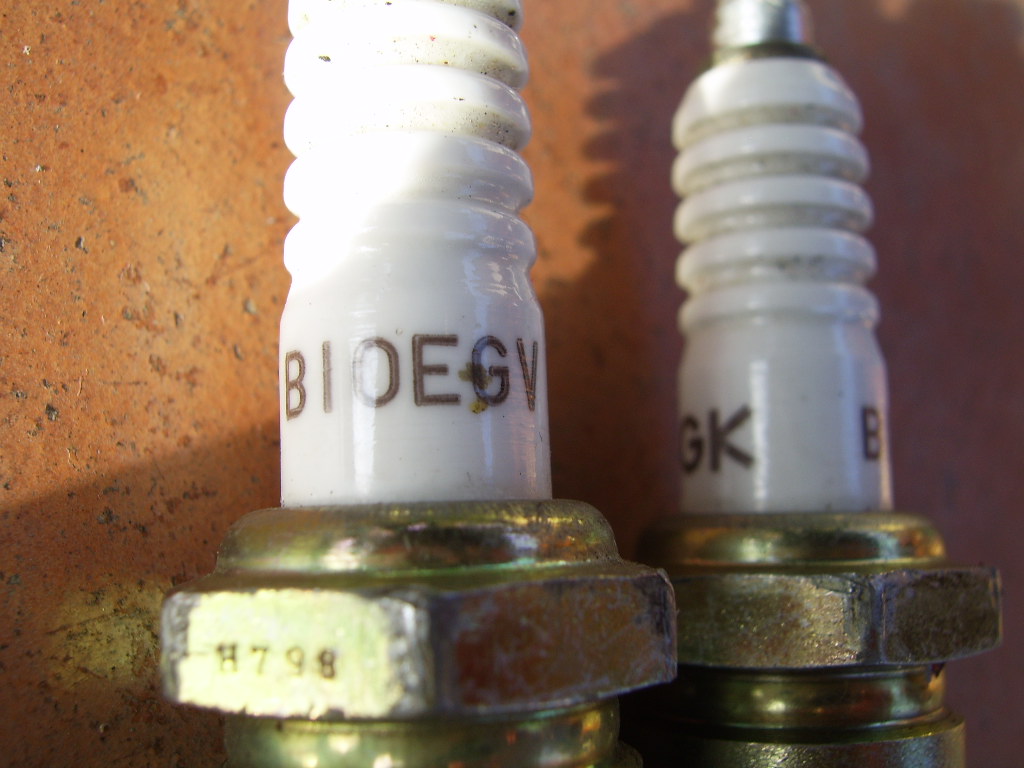

Wow B10 EGV. Have not seen a set of those for a while. A much colder plug than you have been using.
I used them for racing only , a RX3 with 12a bridgeport, modified intake manifold and rejetted Nikki. It was ever such a long time ago.
