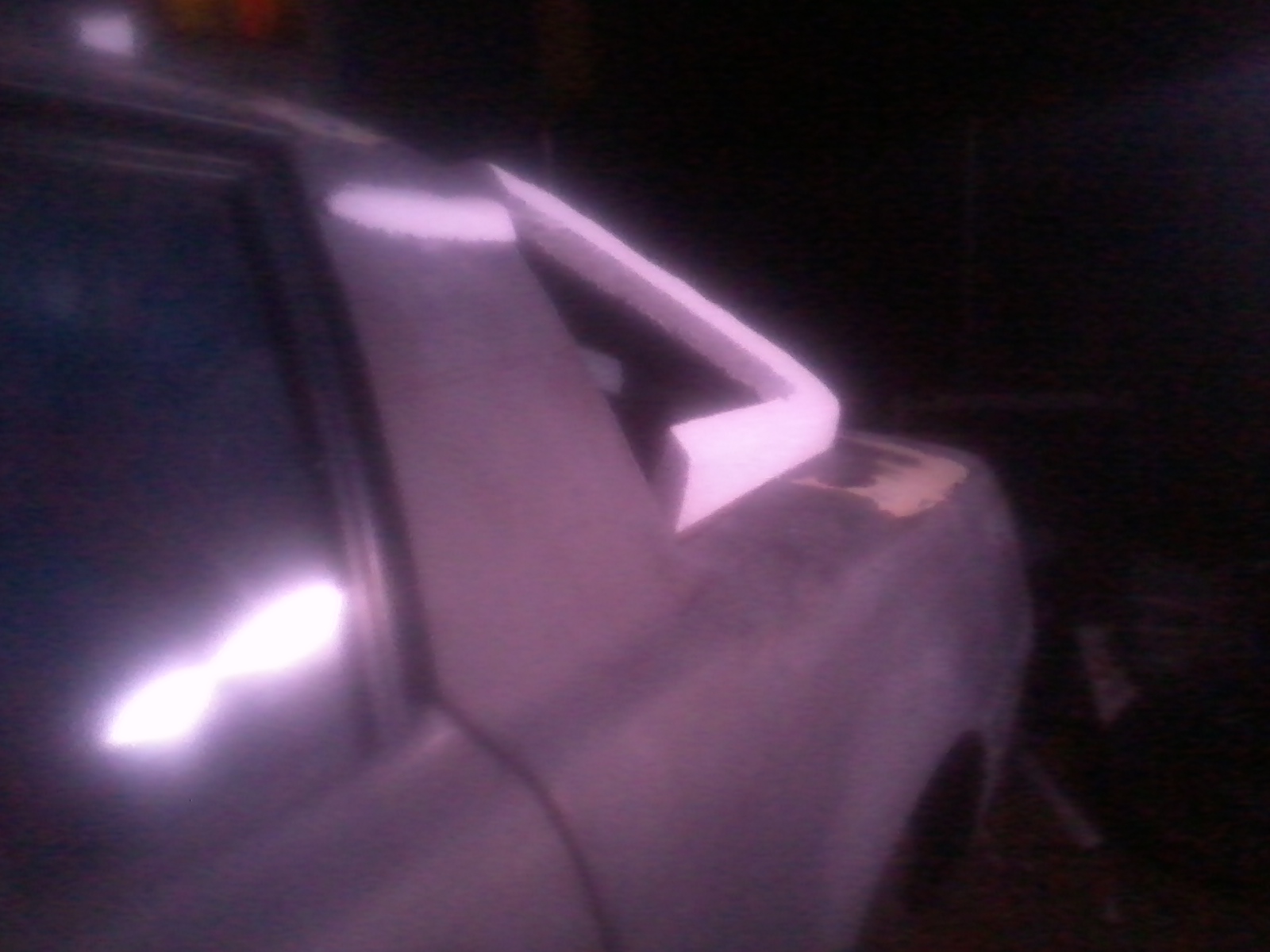

Alright, the widebody and body stuff has begun... This is the bottom template for the rear ventalation scoops.
Scoop Template.jpg (399.51 KiB) Viewed 4759 times

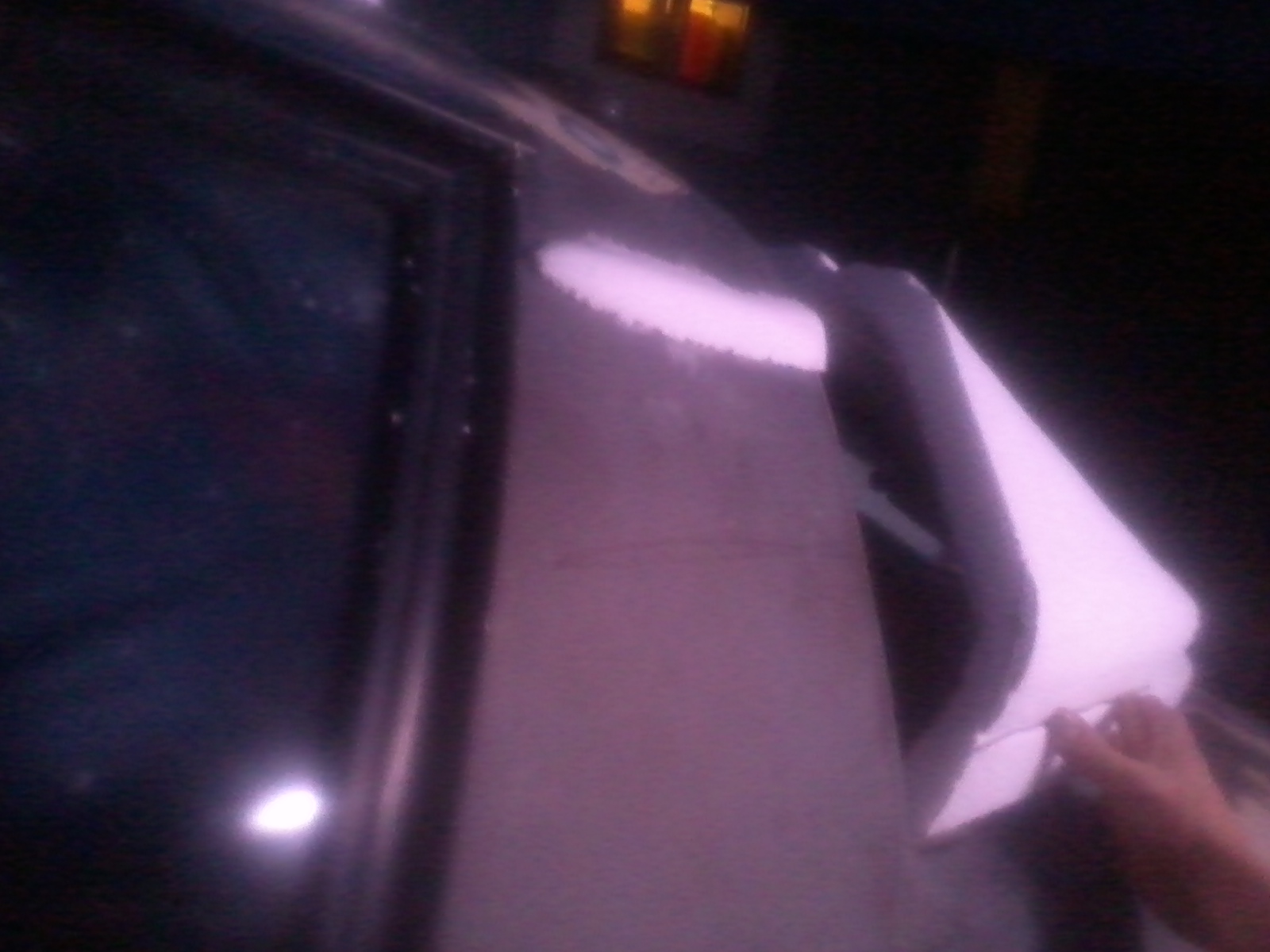

The scoop template completed and shaped..
Scoop bottom.jpg (365.29 KiB) Viewed 4759 times

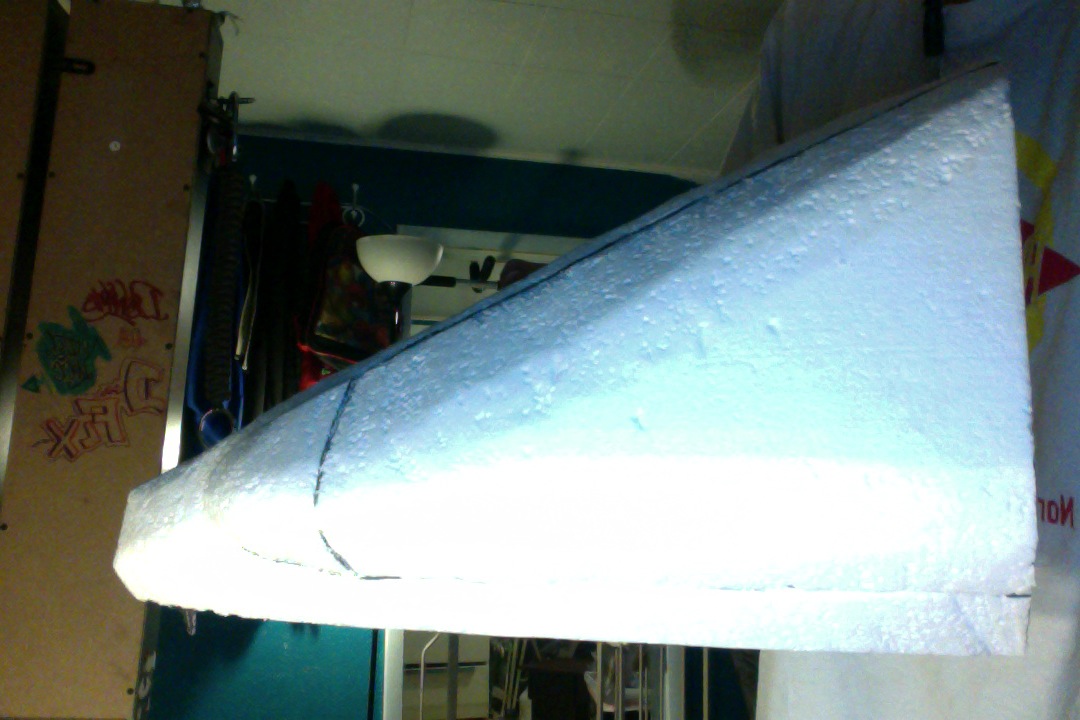

The Massive air scoops are nearly completed now, need to finish the air splitters and then fiberglass and bondo them so they are smooth and ready for paint.. Then i start on the giant widebody..
Scoop near complete.jpg (377.02 KiB) Viewed 4759 times

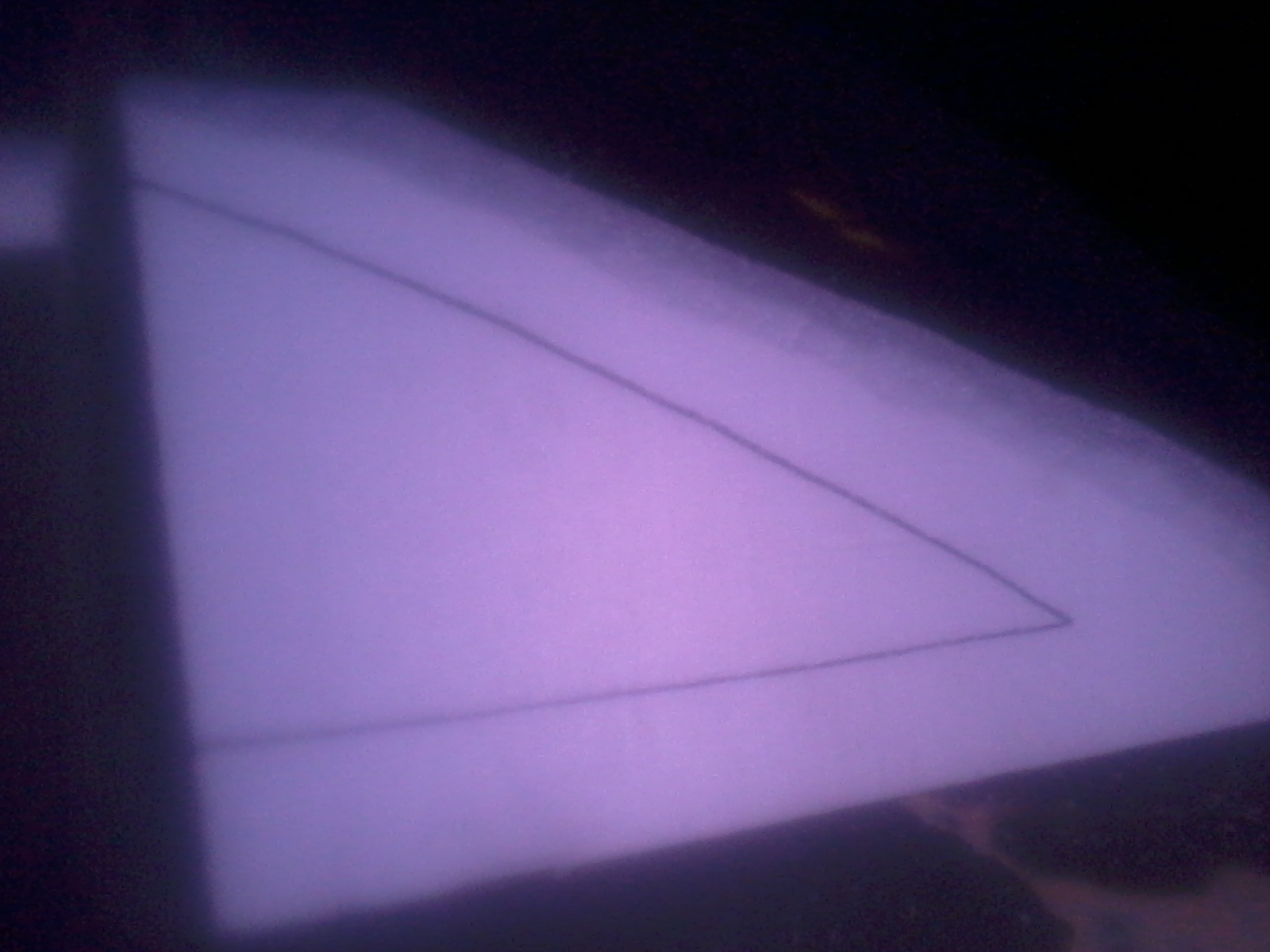

Here is a good photo...
Photo on 9-14-13 at 7.03 PM.jpg (165.35 KiB) Viewed 4738 times

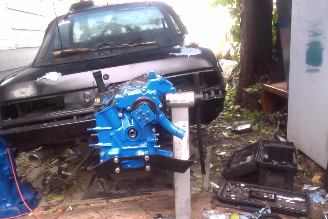

The engine is starting to come along now.. Industrial Spec bolts instead of automotive for a bomb proof look haha.
Photo on 11-15-13 at 9.13 AM.jpg (232.34 KiB) Viewed 4695 times
Re: 1985 GSL-SE LeMans car based Racecar
2 things:
Why is your motor back to front? Mirror?
How are you retaining the torrington bearings? :o
MishlerDennis
Posts: 25
Joined: Sat Aug 10, 2013 4:10 am
Location: Lewiston Idaho United States
Post by MishlerDennis »
My laptop takes mirror images for some reason, and I am not retaining them, I am disassembling the entire engine and buying new apex seals, bearings, timing chain, and pretty much everything necessary to withstand two 88mm turbos without damage. Only thing holding me back right now is trying to locate a 54mm socket so I can crack the motor open properly. Cant find a socket that big where I am at although.
I got worried cos I thought you were putting it together without a front nut on it.
A 55mm socket is half the price and works just the same.
That motor just looks weird in reverse :lol:
