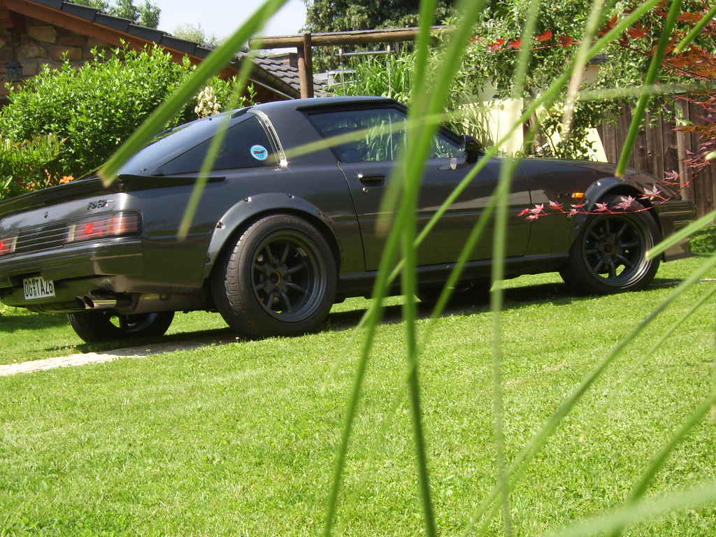

What modifications are you making? Fender flares? Widebody?
Has thanked: 473 times
Re: Lead Loading
My Car is finished with fenderflares. Yesterday i tested my modified nikki and it works great.
elwood
Posts: 32
Joined: Fri Apr 26, 2013 7:54 pm
Re: Lead Loading
Post by elwood »
Nice looking car. Where did you get the flares?
Re: Lead Loading
elwood wrote:Nice looking car. Where did you get the flares?
from a swiss hill racer his name is Claude and he is a very good mechanic too
http://www.zcarracingteam.ch/
I´ve modified the flares so they can fixed on the RX7. Not shure but I think the flares where made for an Datsun 240 Z car. The flares on Claude´s racecar are made of carbon and they are more expensive then mine. But it´s better first read my story here about the car viewtopic.php?f=2&t=1118
