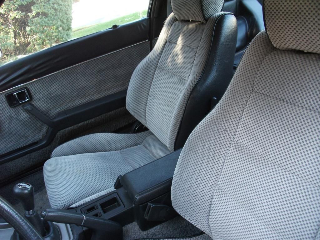

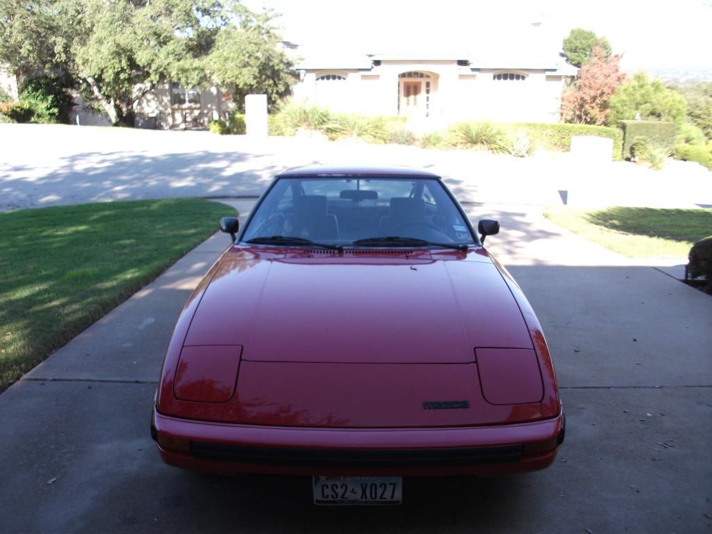

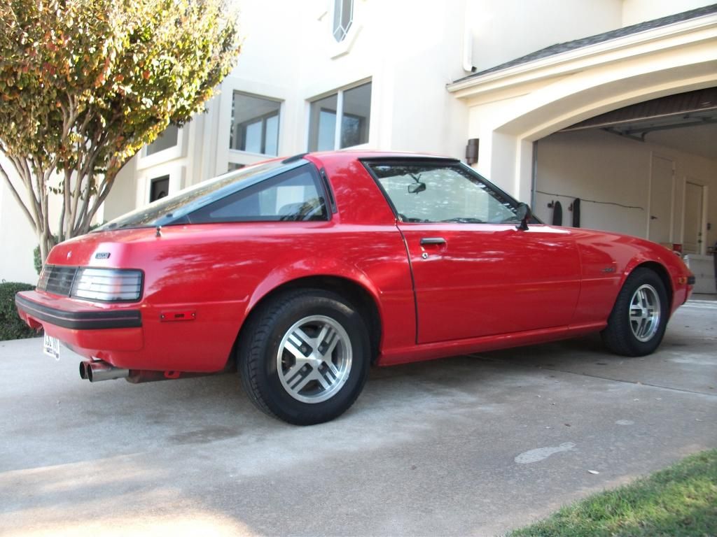

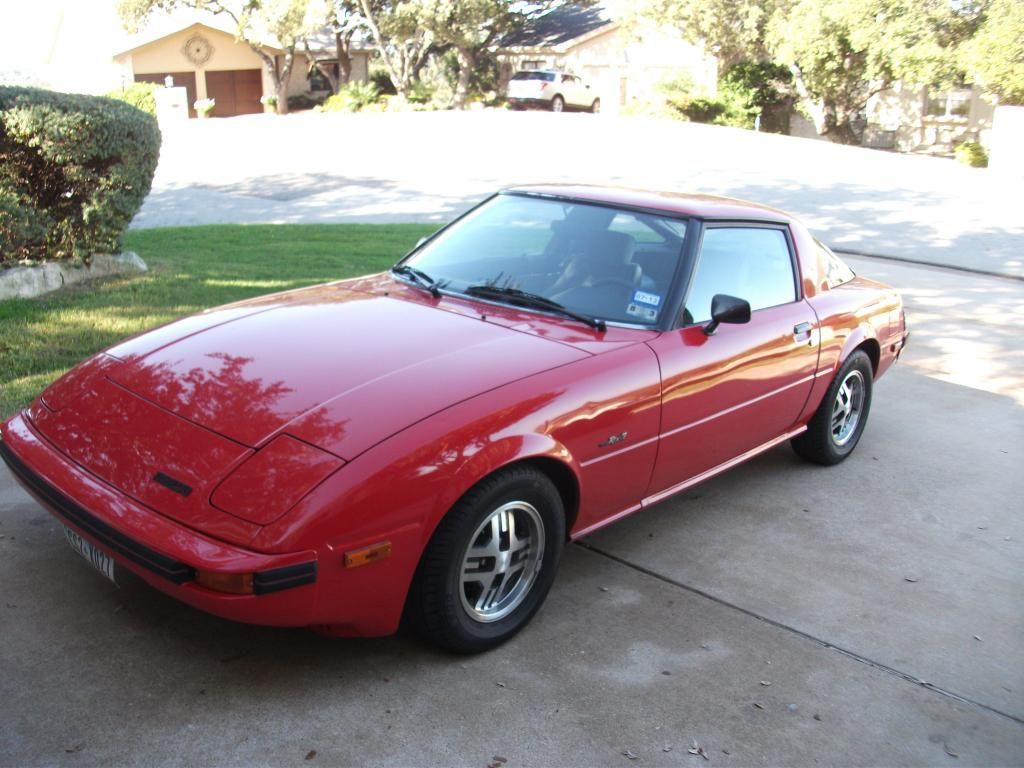

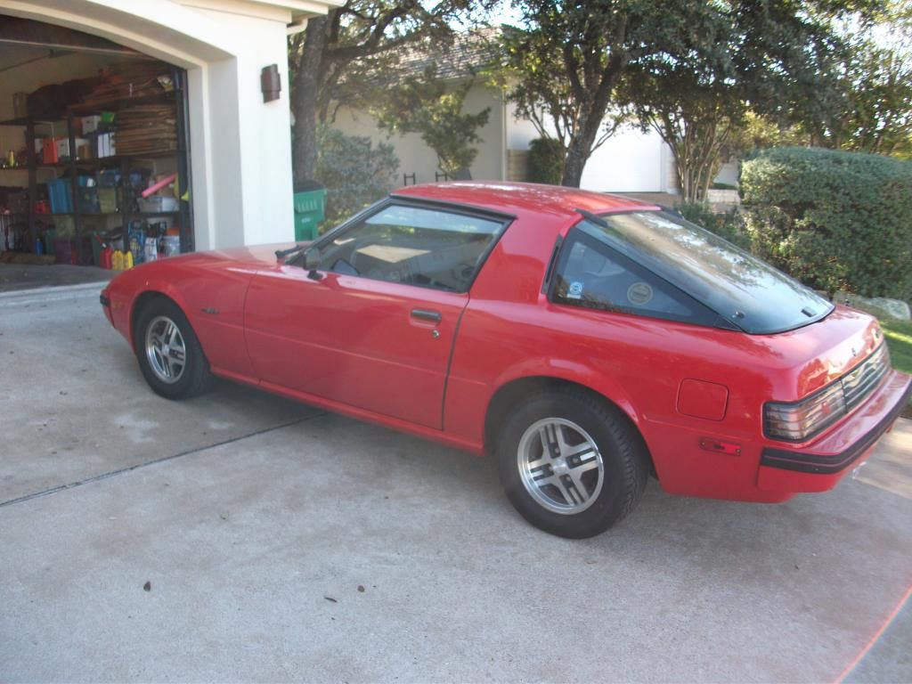

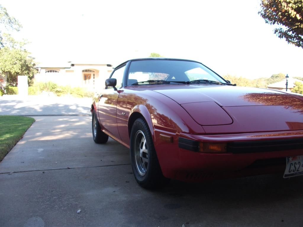

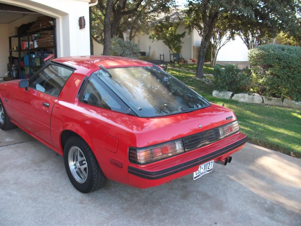

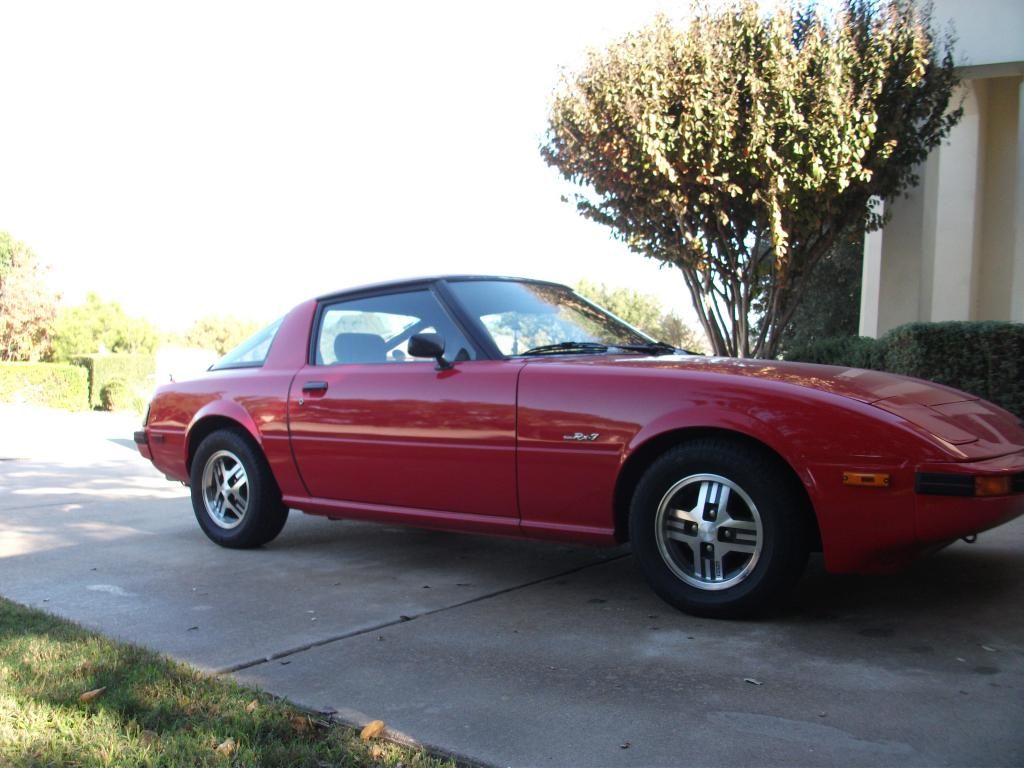

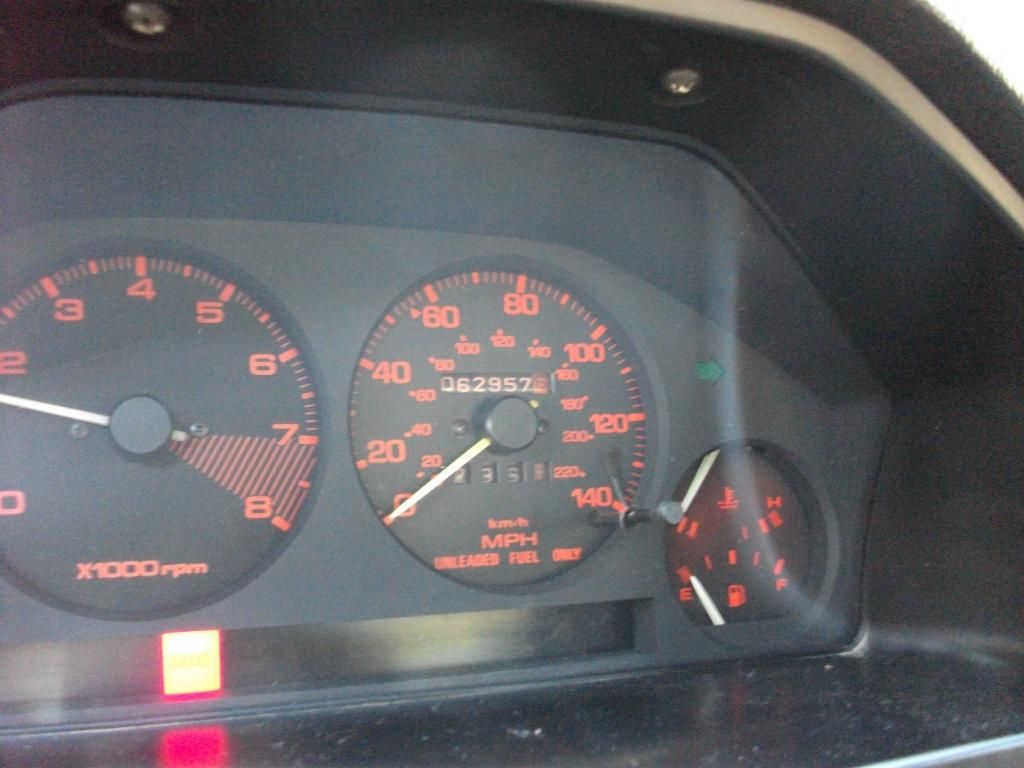

Ok Ok! Here's some pics
I'm the 3rd owner. The 2nd owner was my girlfriend, so it's been in the home for a few years. She bought it from the original owner 2 years ago with 48k miles. This was the last red FB sold in North America. I've got all documentation from new, including invoice, original note, etc etc. Been repainted once at the factory due to some fading, complete with factory paint warranty. Strait pipe installed when we purchased it. I've even got all of the rubber trim bits in a box in the garage, as they were taken off for the repaint (I think it looks better without them).
Since I've had it, we've replaced the radiator (OEM Brass), sport springs, shocks/struts, tie rods, bushings, ball joints, brake master cylinders, added racing pulleys, rebuilt the brakes etc etc. Most due to age (as the mileage is certainly low).
The reason I brought up the steering is it's developed a 'stick' when turning left. The steering catches pretty bad, and it's making it a bit scary to drive. That, plus the 3/4 inch or so of travel makes me want to just convert.
Other than that, all she needs is a working radio and perhaps some new window rubber. Then I think I'll run her till the engine blows, and replace with a larger rotary
-Richie

Is it the top bearing catching (failing) in the strut? That gives a feeling like the steering doesn't want to turn initially, then it feels like its kinda fallen over sideways (only way I can think to describe it) and doesn't want to return to centre afterwards. I'd certainly try the easy and obvious solutions before jumping straight into a major job like swapping to a rack.

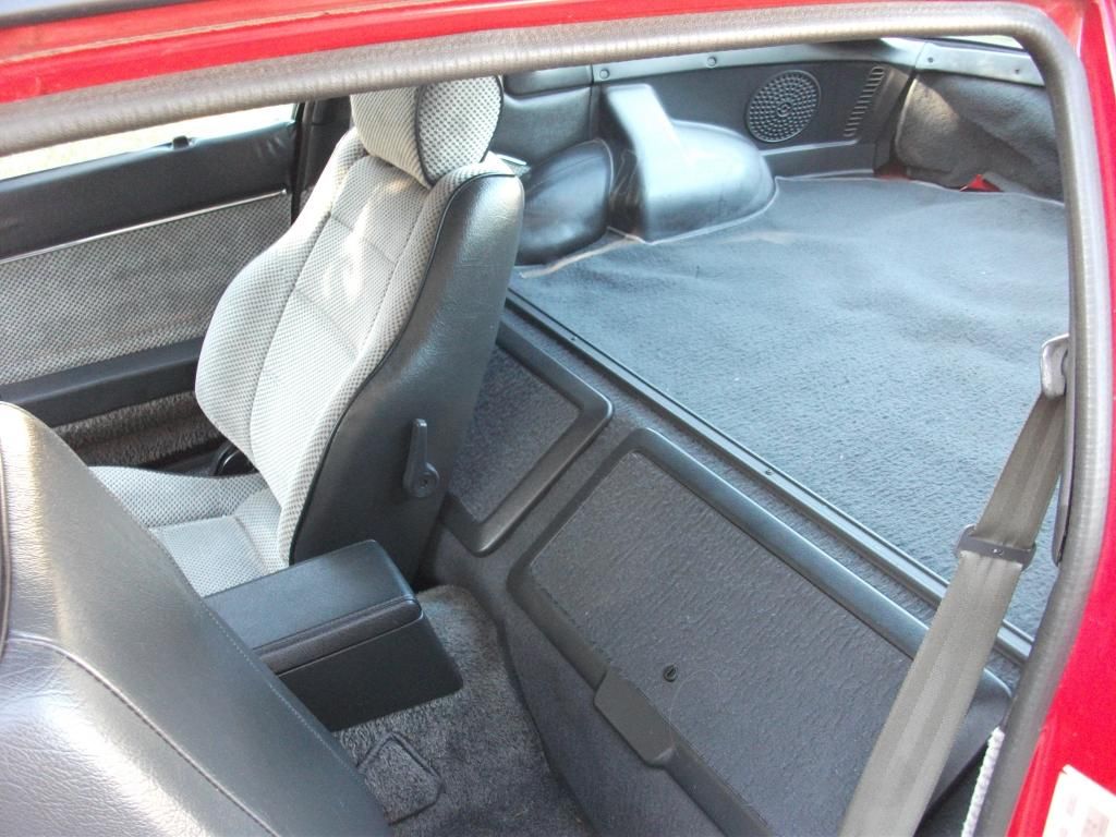

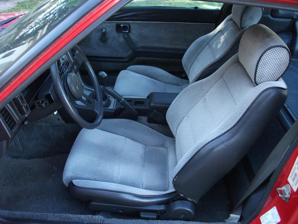

...as to the pics, it looks great! So jealous of you guys getting the decent aero mirrors and the clean rear end with the beaver panel. Plus it makes much more sense as a two-seater with boxes and big flat load area. Hey, aerobic window winders though!
