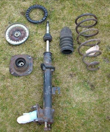

here's the trick...

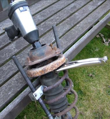

Get a large flat blade screwdriver and prise the rubber dust shield and bump stop down the ram to expose the top part of the ram.
This top part can be gripped securely with a pair of mole grips as any damage this high up will not pass through the seal and damage it
Once the mole grips have a solid grip on the ram, undo the lock nut with an impact gun.
The nut will come off easily with this setup and the mount, spring seat, spring and rubber dust shield can then be removed...
then refurbed...
and put back together.... again, grip the top of the ram and use the impact gun to tighten the nut...
