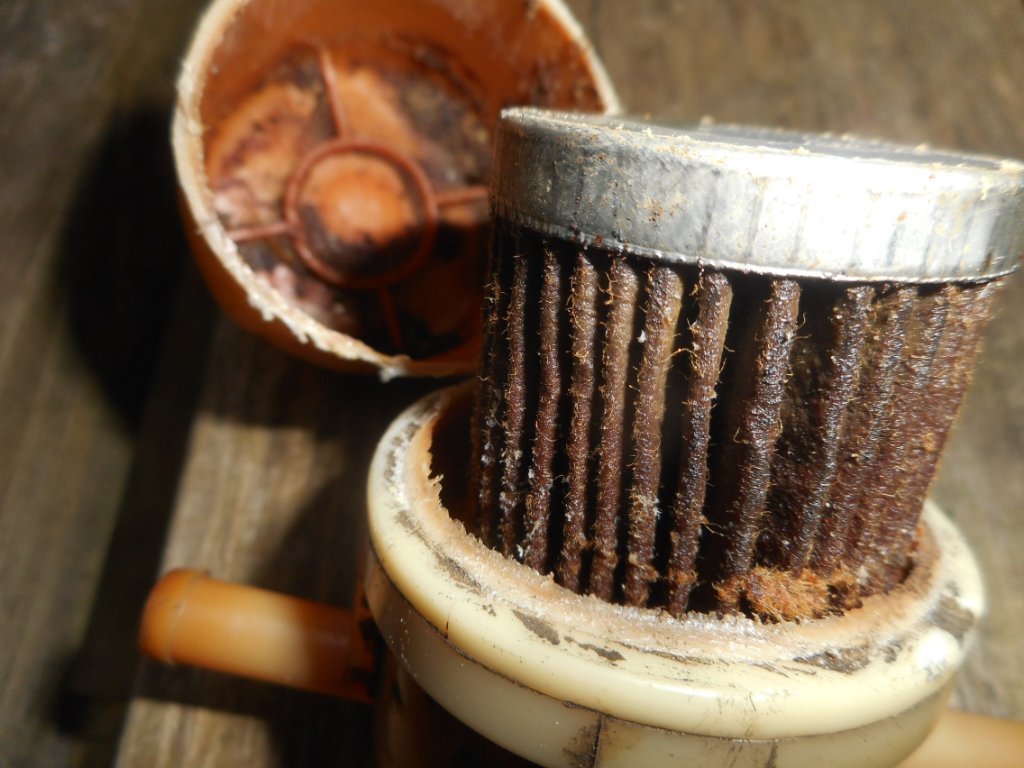

The fuel filter is cut open...not nice! tank to come out next. can anybody tell me where the sender unit wires are for the furl gauge? the gauge does not even register.

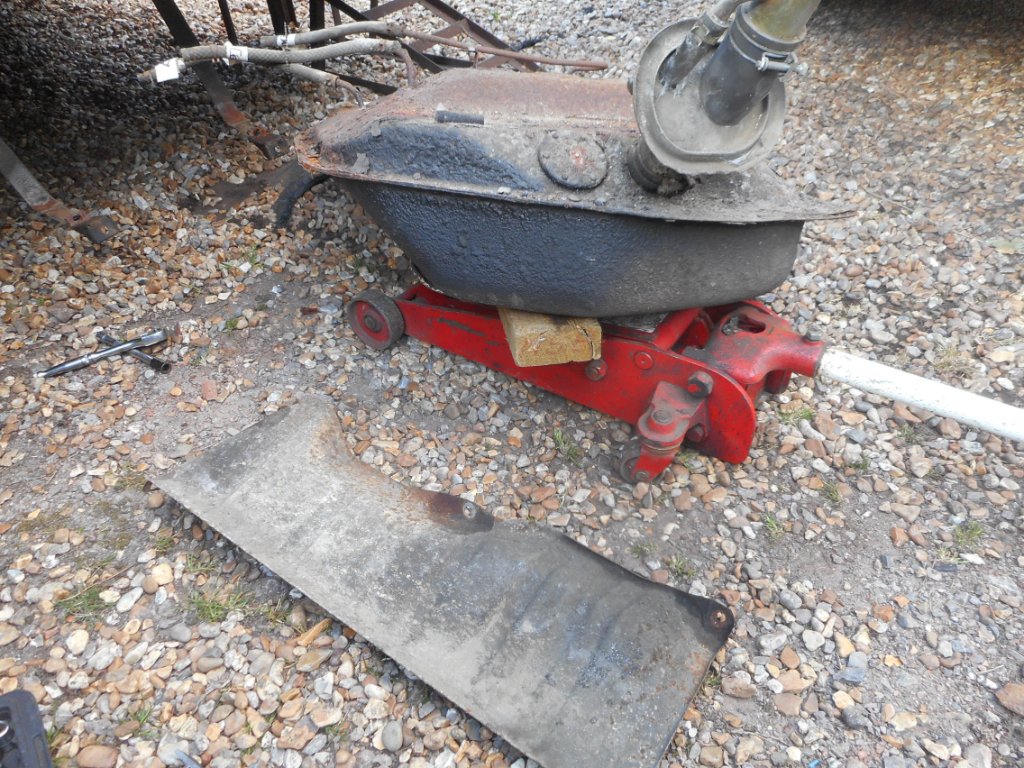

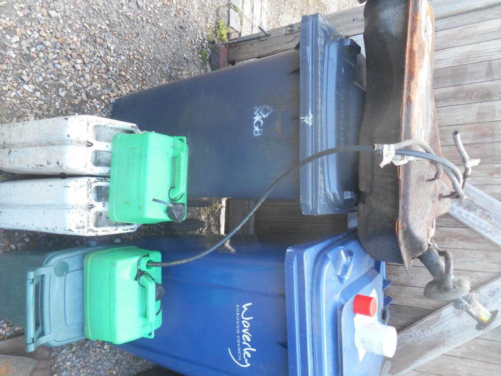

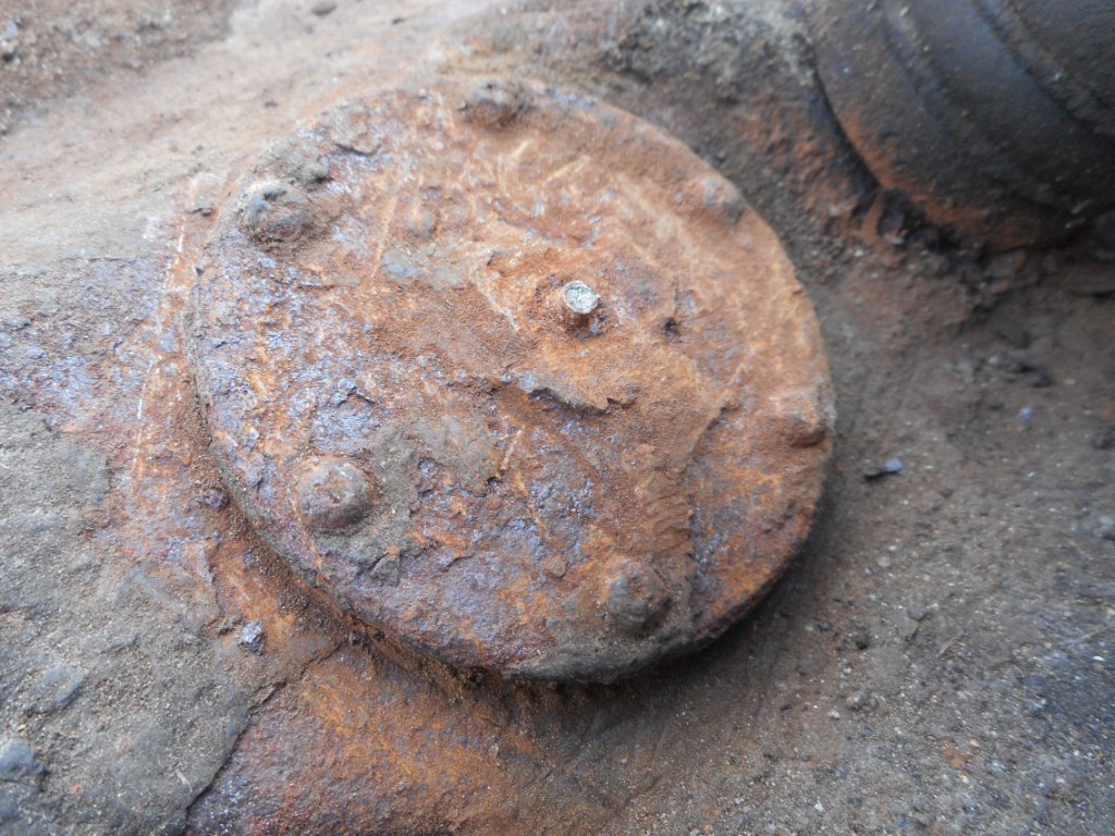

anybody got a usable fuel gauge sender?? also ideas gratefully received as to how to remove this one!!! usual angle grinder in heads not wis with all those fumes :o unless I fill the tank with water perhaps.
Posts: 1322
Has thanked: 505 times
Been thanked: 450 times
Re: Fuel Pump
I'd be amazed if the tank doesn't leak, looking at that photo - that sender is a complete mess too :(

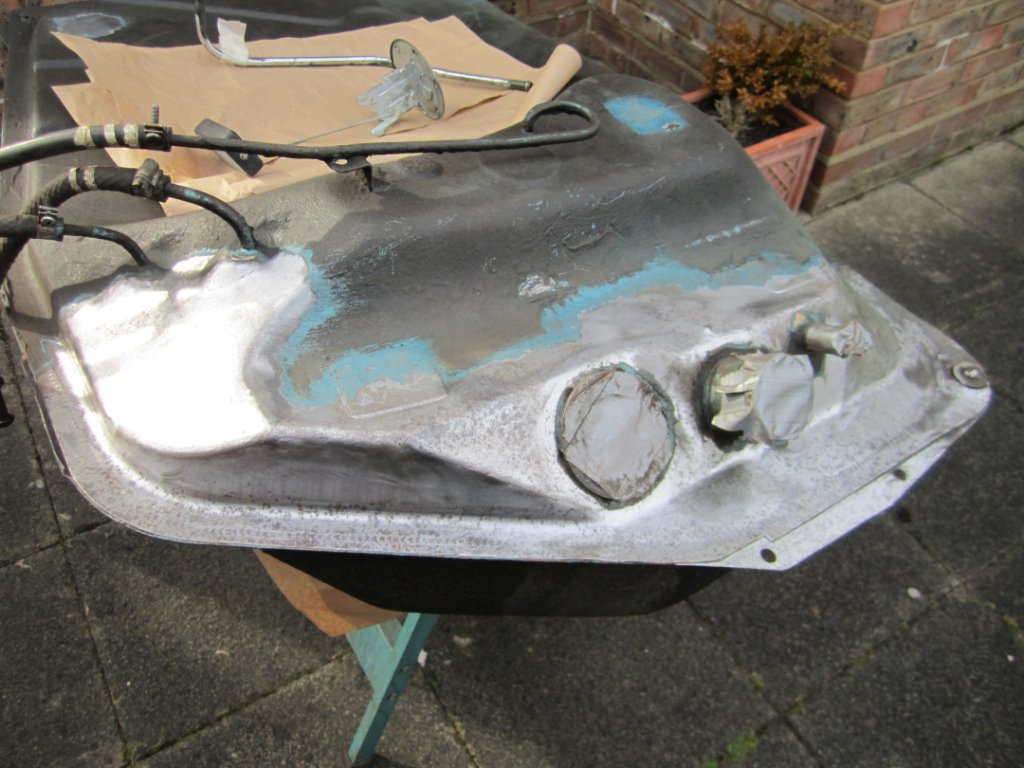

I must have been very lucky with KIMI 1. Here's a photo of the tank when I was cleaning it up to give it a good protection coat. The sender is on the top of the tank. It was easy to remove, in amazing condition and was still working fine. Having said that, I did find an electrical issue, which meant a small fix when I reinstalled it (with stainless steel bolts!).
Fuel Tank rust prep 2 .JPG (145.73 KiB) Viewed 10771 times

rustyrescue wrote: Fri Apr 16, 2021 6:02 pm anybody got a usable fuel gauge sender?? also ideas gratefully received as to how to remove this one!!! usual angle grinder in heads not wis with all those fumes :o unless I fill the tank with water perhaps.
I had the same problem with mine. Had to drill out the screws and re-tap the threads. However, the original threaded holes are only in the upper plate. I had to tap these through into the tank itself. I fitted 16mm long M4 bolts from the inside out ( fiddly ), secured with Loctite. On to these "studs" i could place the new sender with lock-nuts. A new sender is still available at Mazda. Was about 85 Euro.
