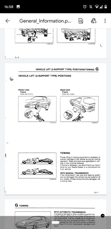

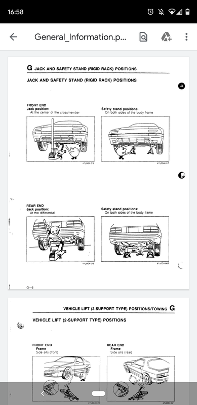

So I got underneath it today to change them over, I started with the rears. But i was immediately concerned if I was going to put the jack in the right place. I Googled it and it said the jacking point was in front of the rear wheels. But there are 2 places you could locate it. There is a recessed area that the jack could fit nearest the rear wheels, or there is a an area about 6 inches long which is further away from the rear wheels that is U shaped.
I am pretty sure it is strong enough but i don't want to damage a fairly pristine car by making the wrong call.
I know this is an FB forum but I am sure someone can help me locate the jackin the right place.
I didn't get to the front wheels but some direction on the jacking points would be great.

Post by richrx » Fri Mar 27, 2020 5:00 pm
Here is some screenshots from the online service manual....
https://www.rotaryheads.com/PDF/2nd_gen/
My thoughts would be use the rear diff and a block of soft wood
Rich

Post by Threesevens » Fri Mar 27, 2020 10:12 pm
Hi Rich,
Thanks for your response it has been very helpful especially the FC manual download.
I think i know where to put the jack now, but i wish I had more than the original scissor jack.

Post by richrx » Sat Mar 28, 2020 10:07 am
Scissors Jack's arn't the greatest thing.
If you can afford one the Clarke 3 tonne quick Jack's are great. There big and expensive next to the Eurocarparts 2 tonne Jack's, but brilliant for jacking anything up, and you can jack up on the diff easily. Even the small 2 tonnes Jack's are much better than scissor jacks.
I wouldn't recommend doing anything with scissor Jack's except in an emergency.
Given how nice your car sounds and your eager not to risk damage better safe than sorry g-l
