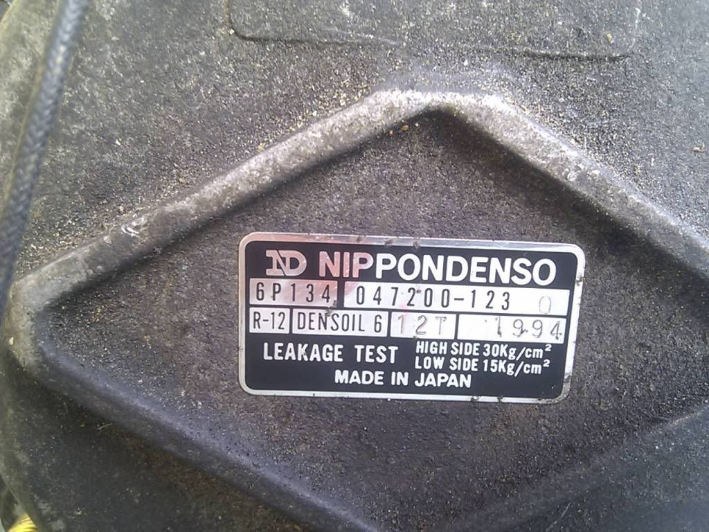

and a compressor, off an ex saudi FB, needs a clean though....
