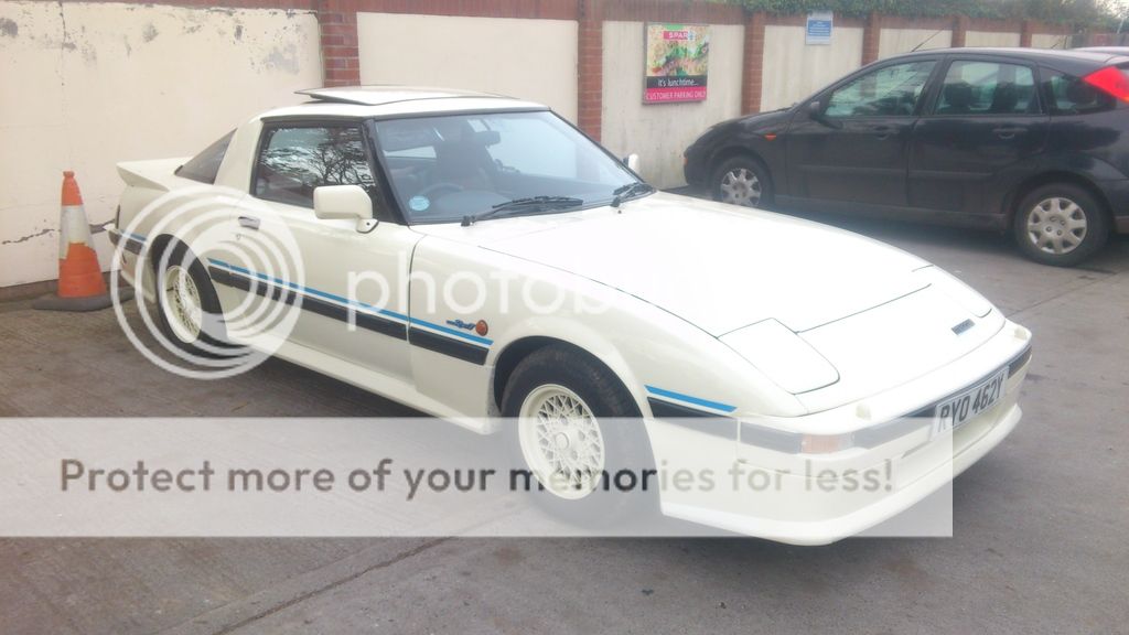

and here's his car i bumped into him at a petrol station when in the work van one day, glad i got a pic (im an fb spotter too) shame he will never join the internet or forums.
Re: The Smurph
A Ha......Been spotted before, Somerset in 2010 and Honiton area 2014.
But absolutely no idea of it's background until now. So many thanks for that information.
Hey, but what a cracker!

Weren't Elford Engineering somewhat infamous for color coded body kits / wheels / mirrors? That looks like a definite candidate. Very tidy.

I spotted the White Elford in Aug 2014 near Honiton (I was in my 7) & we both waved/looked in amazement at each other.
