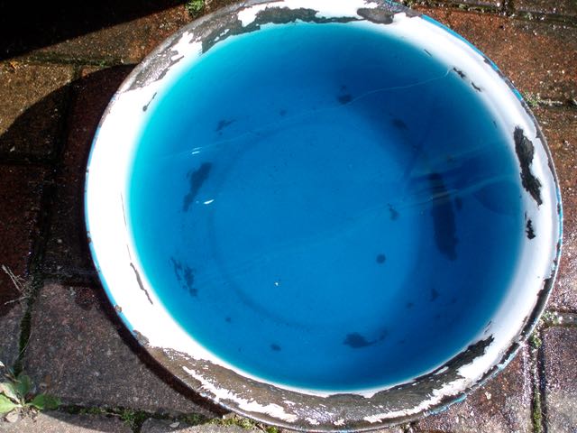

Hi Guys,
Changed antifreeze today. This came out. Good Old Bluecol.
(Been in there since May 2013).

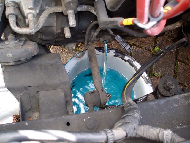

Some more details....very basic info but might help someone.
A cut bottle taped on helps flushing with hot water from a bucket.
And don't forget the heater control lever should be over to 'Hot' to allow the heater to drain as well.

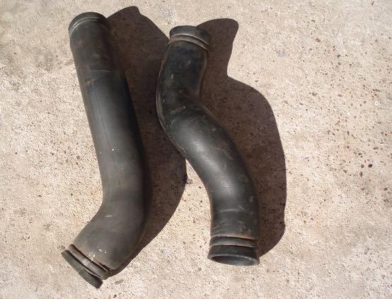

Old Hoses off, New hoses on. Old ones still seem fine after 31 years!
Sorry Ian, Clips were still good and I couldn't bear to discard them.

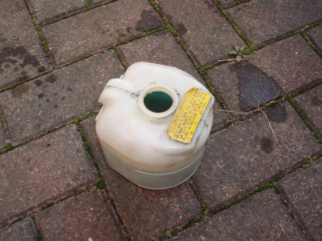

This is the stuff.......and don't forget the expansion bottle.....up to 'Full' with fresh stuff before you test drive.
And tomorrow when it's all cooled down I'll recheck levels thoroughly.
