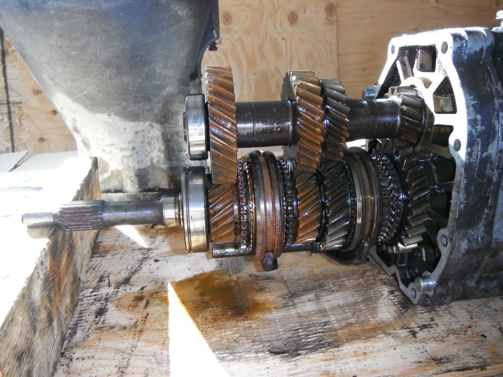

Hello All,
So my car has a bad bearing somewhere in the gearbox (really noisy but quiet when clutch pedal pressed, so i assume a bearing in the gearbox).
Before i take apart the one that "works" i figured i would learn to rebuild a spare first.
However I have encountered an issue.......
When trying (oh boy was this painful) to separate the front bell housing from the middle housing the Haynes manual says to "tap on the shafts with a plastic hammer" and they will come apart.....well mine did not!
I checked many times to be sure that i had removed all bolts and snap rings and after a good soak in deep creep I (rightly or wrongly) took a bigger hammer and a wooden block to it........
the result is as follows:
Gearbox Rebuild - Main Bearings Stuck on Shaft

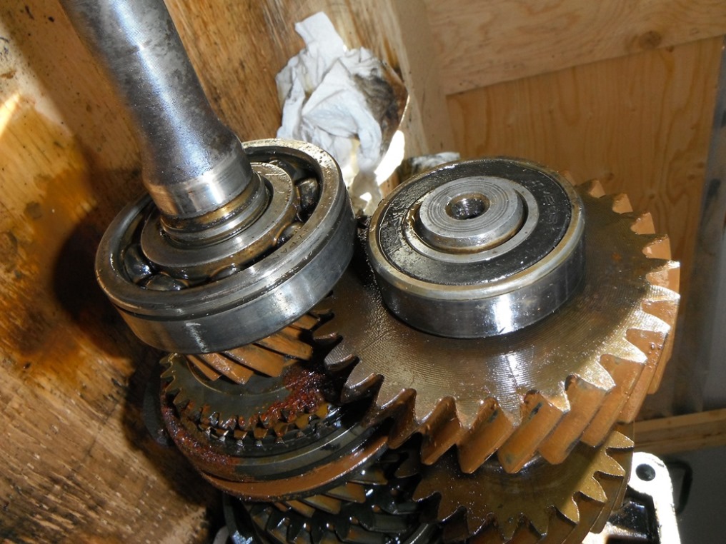

Re: Gearbox Rebuild - Main Bearings Stuck on Shaft
So does anyone have some advice as to how i can remove the bearings from the shafts?
I was hoping they would stay in the front cover......
I would also appreciate if anyone can tell me what I should have done to avoid this rookie mistake......
From the pictures above the box has had a fair bit of water in there which is the cause of your problem, you will need a puller to remove the bearings probably easier to go to the local garage and get them to remove them but that box will need a full strip down to check all bearings, i doubt it will be the release bearing as that would generate a noise when pressed,

- Posts: 54
Hey Guys!
So it has been a while since I last updated this post and long story short – as of Sunday night I have a spanky new transmission in the car!
So the bearing noise was the main (big) bearing on the input shaft that sits in the bell housing which explains why it made noise in all gears but was quiet when the clutch was disengaged.
My main learnings from rebuilding this transmission were as follows:
• If you press the clutch pedal in and the noise stops – the problem is in the transmission/gearbox.
• If you press the clutch pedal in and the noise starts – the problem is the release bearing.
• If you heat the bearings in the oven to around 100c or 200F they go on much easier!
• Take LOTS of photos during disassembly (your future self will thank you!)
• You will need long puller tools or your local shop
• You will need a custom tool to remove the lock nut
Overall it’s not too difficult to do, provided you have access to the right tools.
