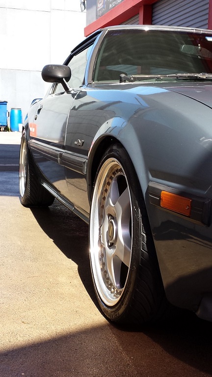

I am comfortably fitting 205/40/17 on 17x7 rim on the front and 235/40/17 on 17x8 rim on the back :twisted: With coilovers and more negative camber, I should be able to fit 215 and possibly 225 at the front. The rear should also fit 245 wide with the guards rolled.
I can't remember the exact offset, but because it is a 3 piece rim, the offset could be customised and I got the wheel manufacturer to get it right. From memory, I do think it's 40, just like factory. 20 offset gives you more poke and limits the width you can fit.
You can see how much room you actually have if you get the offset right.

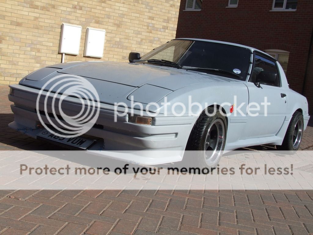

I'm 14x7 with a 0et but run over arches but have just done the baseball bat trick to fit
After over arches
