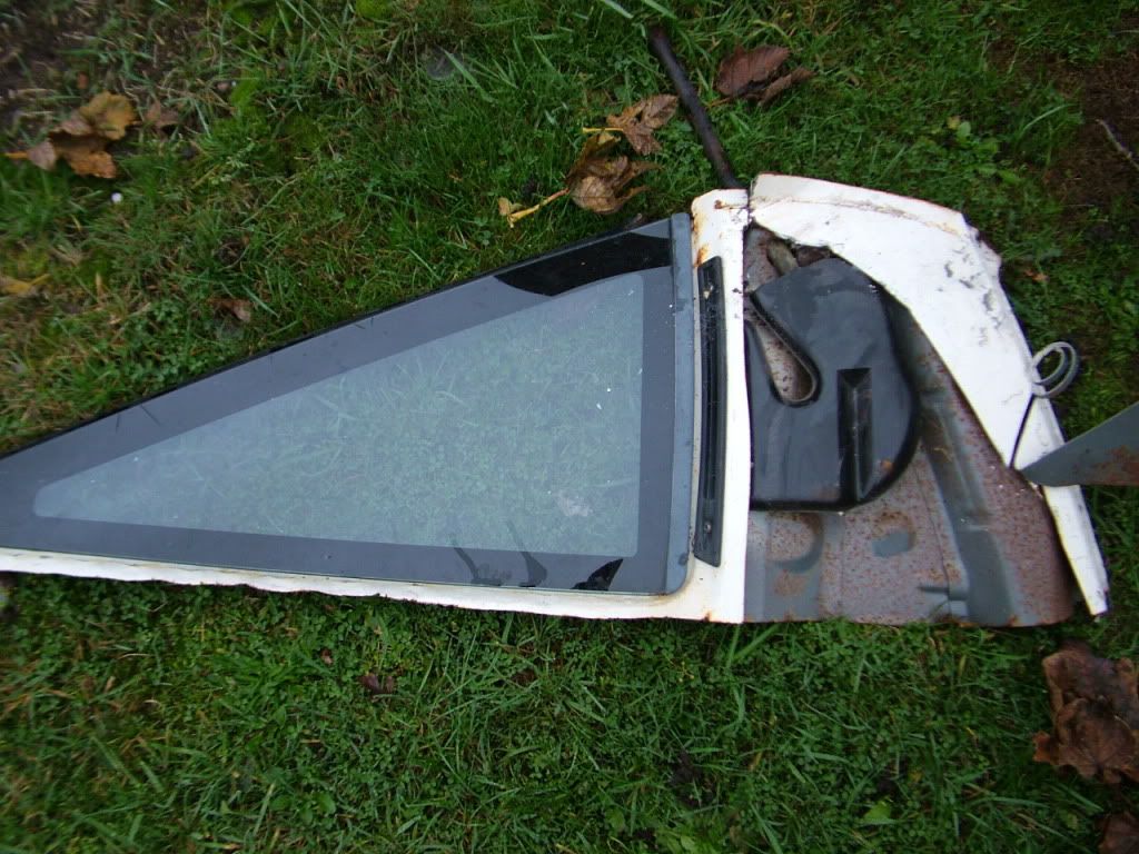

I can add a bit to this...
I still have a section of 'B' post from the s2 I stripped earlier in the year that I saved for the quarter light glass and by cutting away the outer skin, we can see that the rear sunroof drain ( the rubber hose sticking out of the top) goes into the top of the plastic thing and then discharges out of the 'vent' as Steve says
