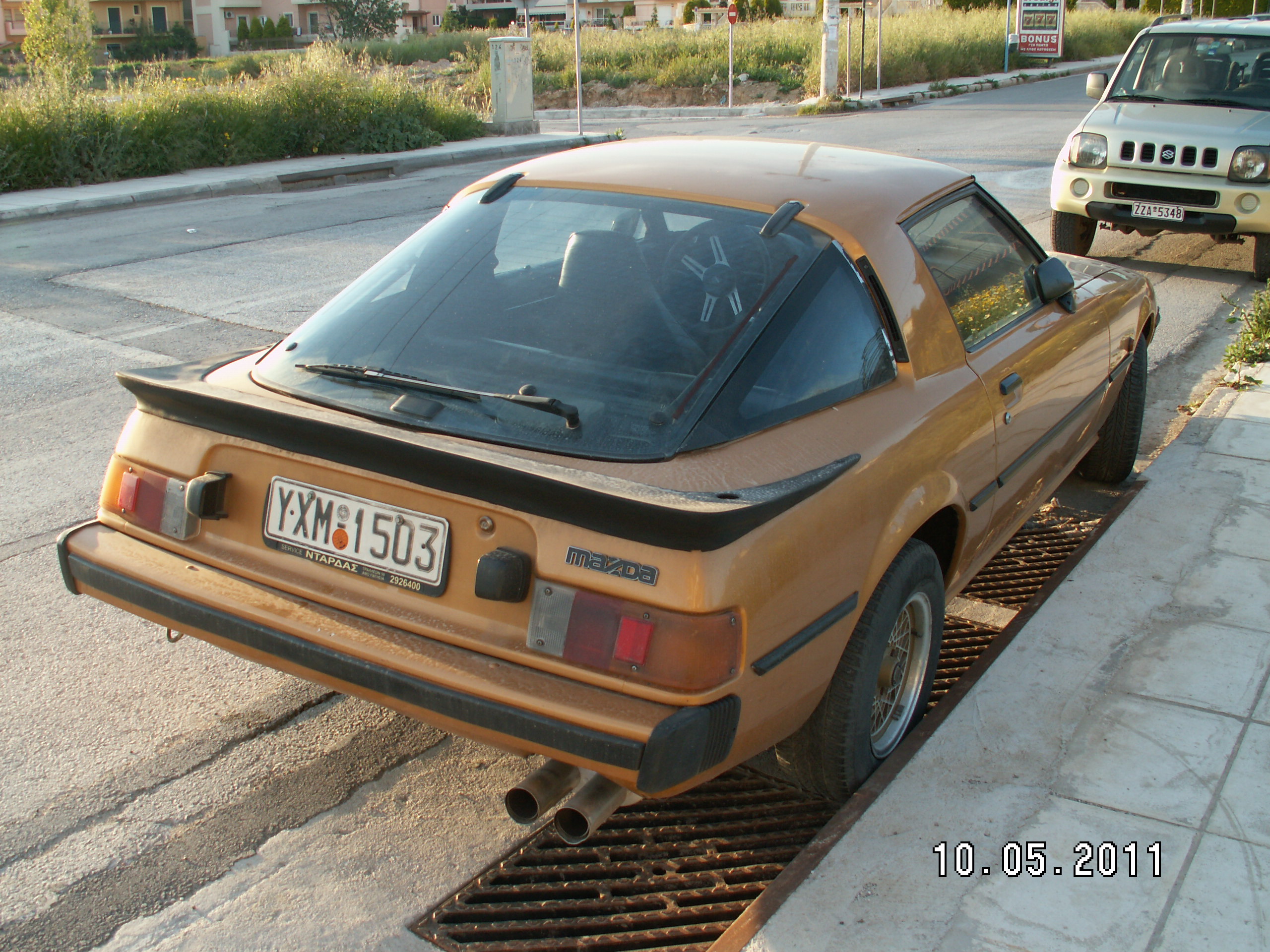

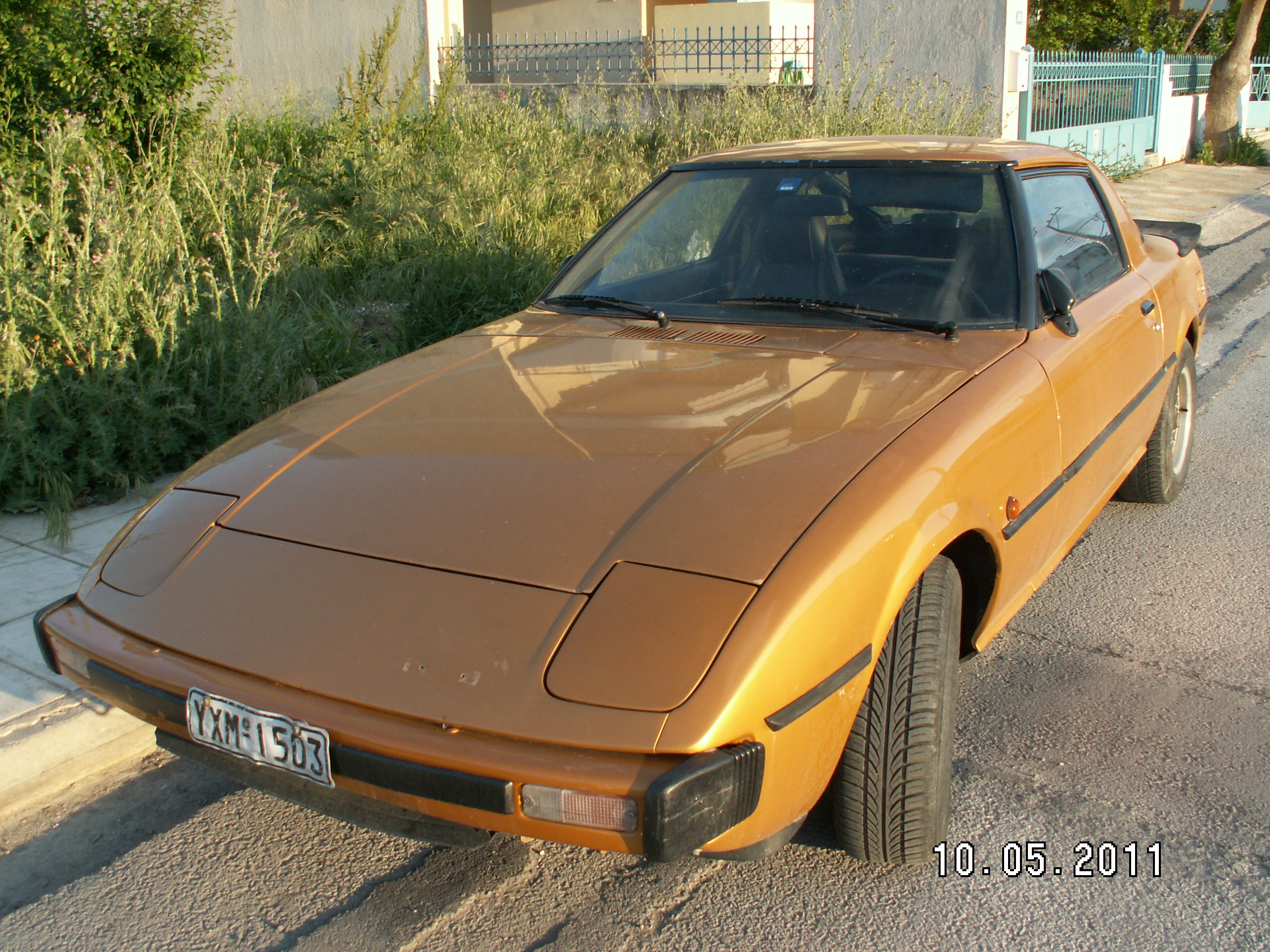

I bought my car some years ago and was supposed to have been already restored. At the final end it was proved that it was a very poor restoration.
I firstly attach pictures of how it looked.
It looks O.K., doesn't it? but underneath the rust was working.
First it was a small bump that was developed in the top of rear-right collumn and underneath the rear fenders and the rear bumper (Not visible in these photos).
I finally decided to to a proper body restoration.
Photos and description of the procedure will follow

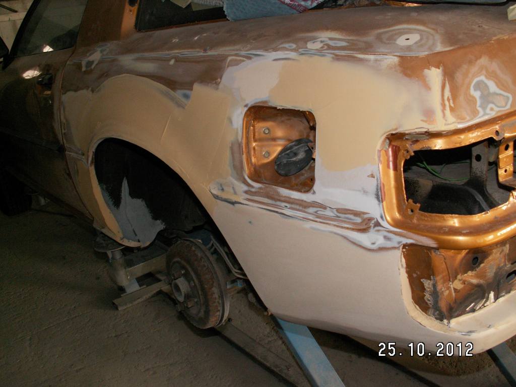

After being stripped and bumpers and rear window removed the size of dammage was gradually revealed.
Unferneath the fenders

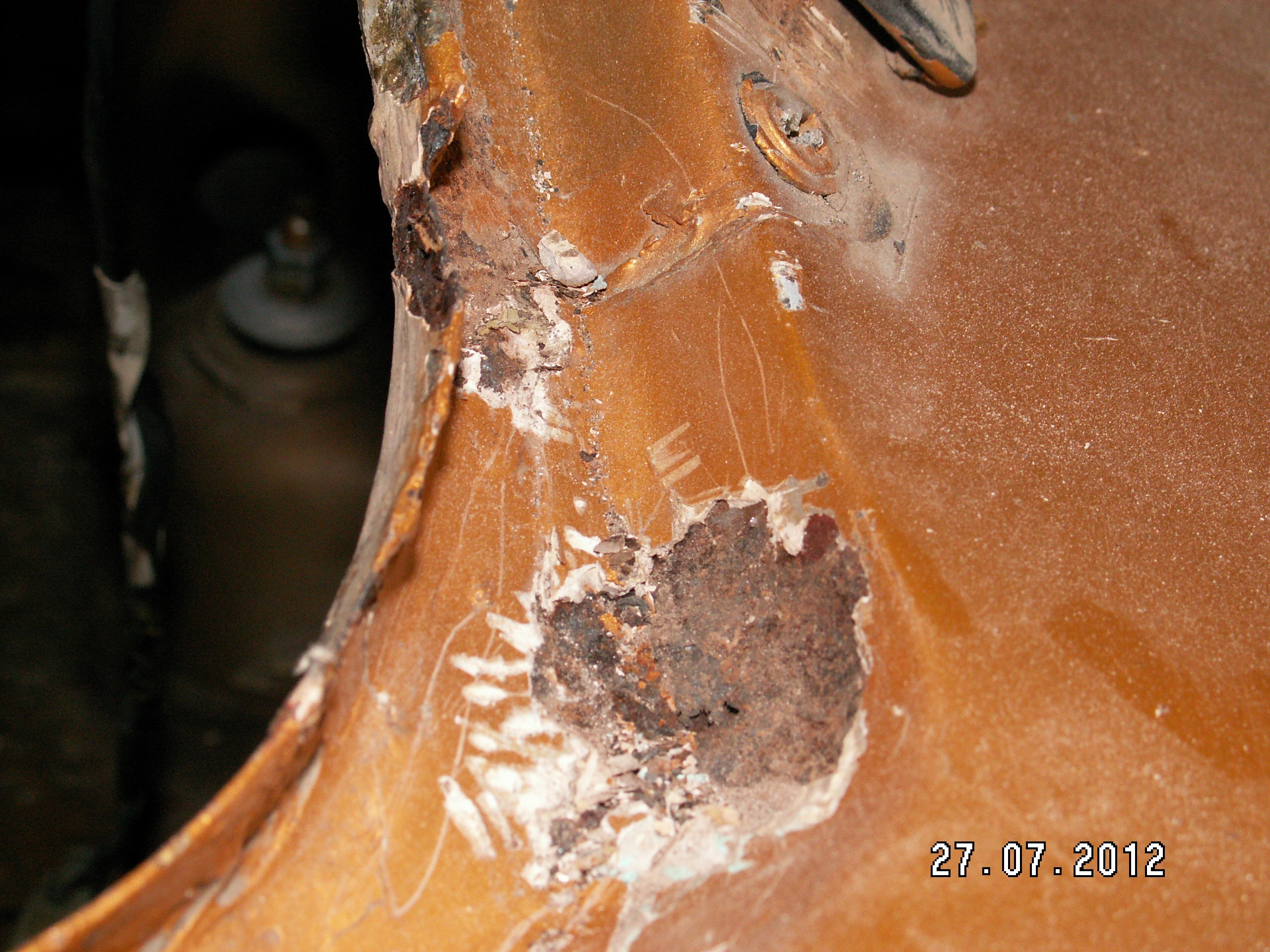

After rear window removal and some paint removal - what a surprise! Rust underneath the window and in the basis of the rear right column

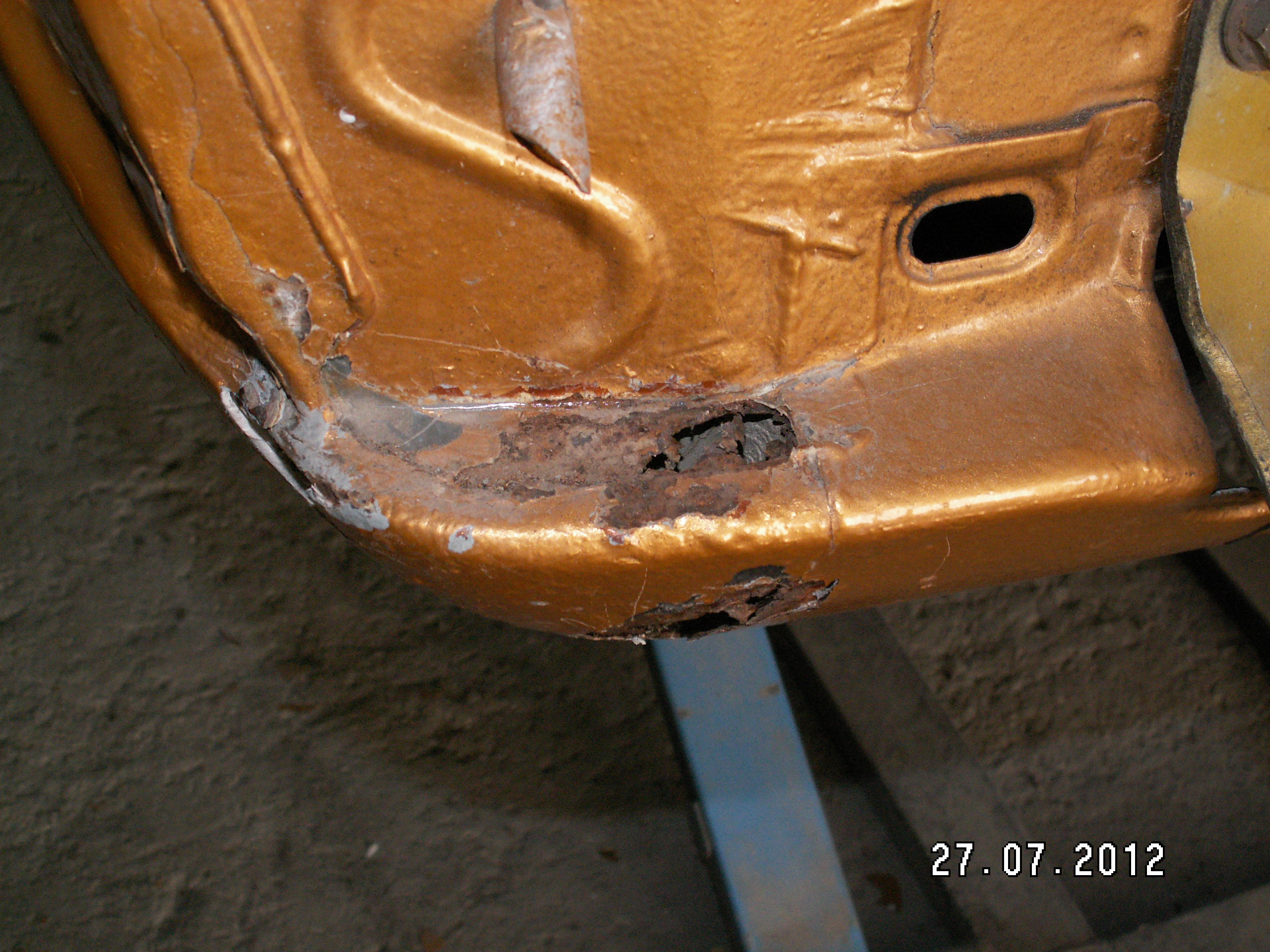

Underneath the bumper (rust, rust rust)

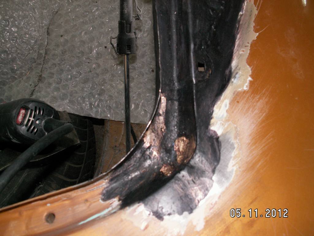

Apparently, the corrosion was mainly focused on the top and on the base of the right rear column.
The base of the rear right column after removing the rust and restoring

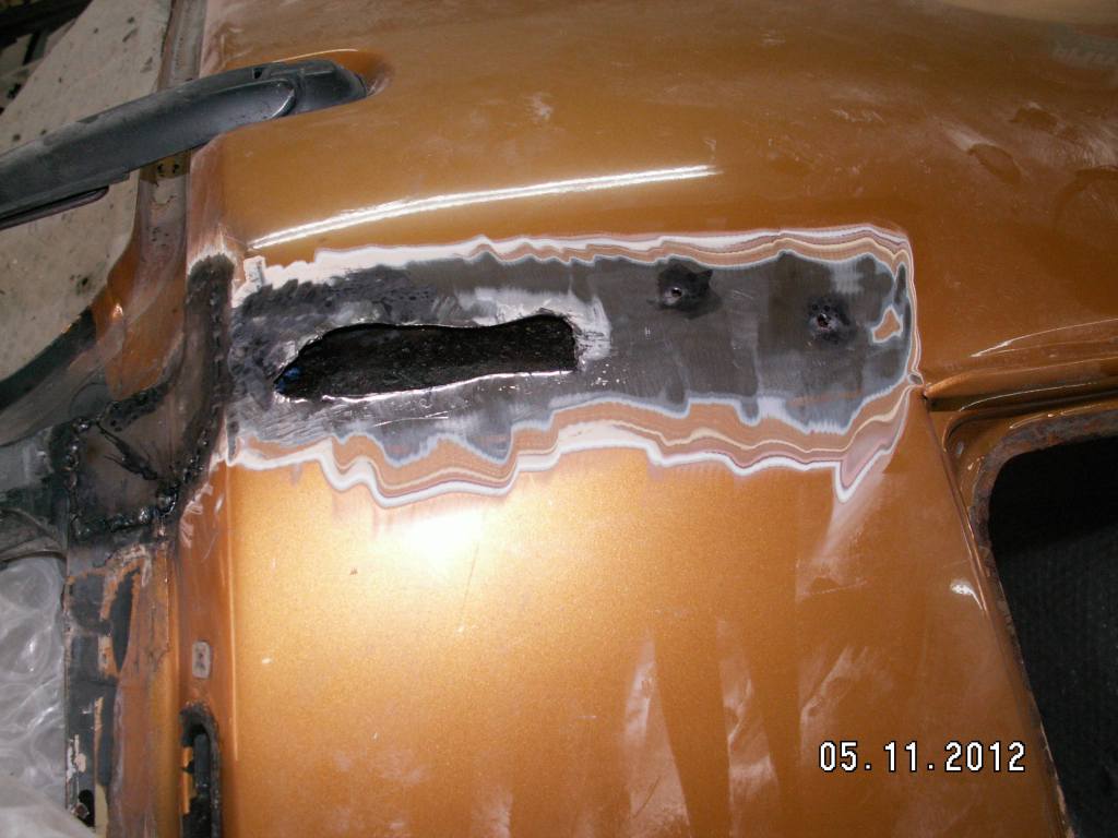

The rust in the ceeling (where the small bump in the top of rear-right collumn was visible) was so expanded. You can reckon that from the hole that  was created. (You can also see the new metal patch).

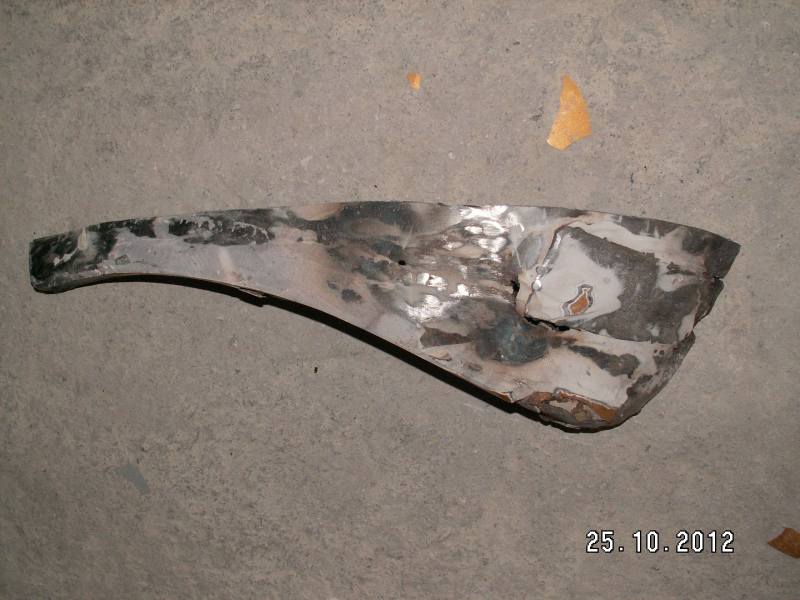

Rear fenders had extensive corrosion. Even part of the rear left fender had to be totaly removed and replaced by new metal

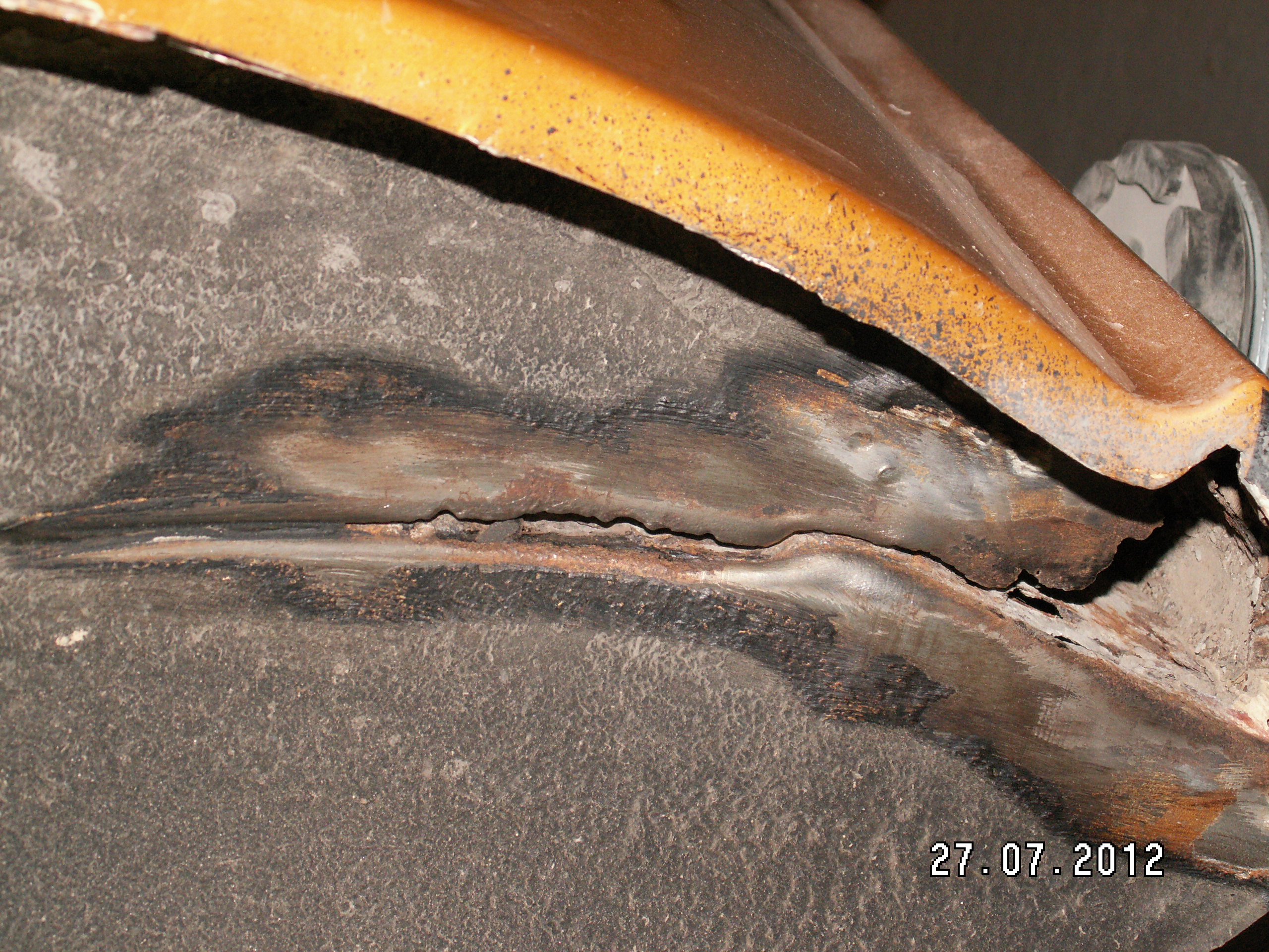

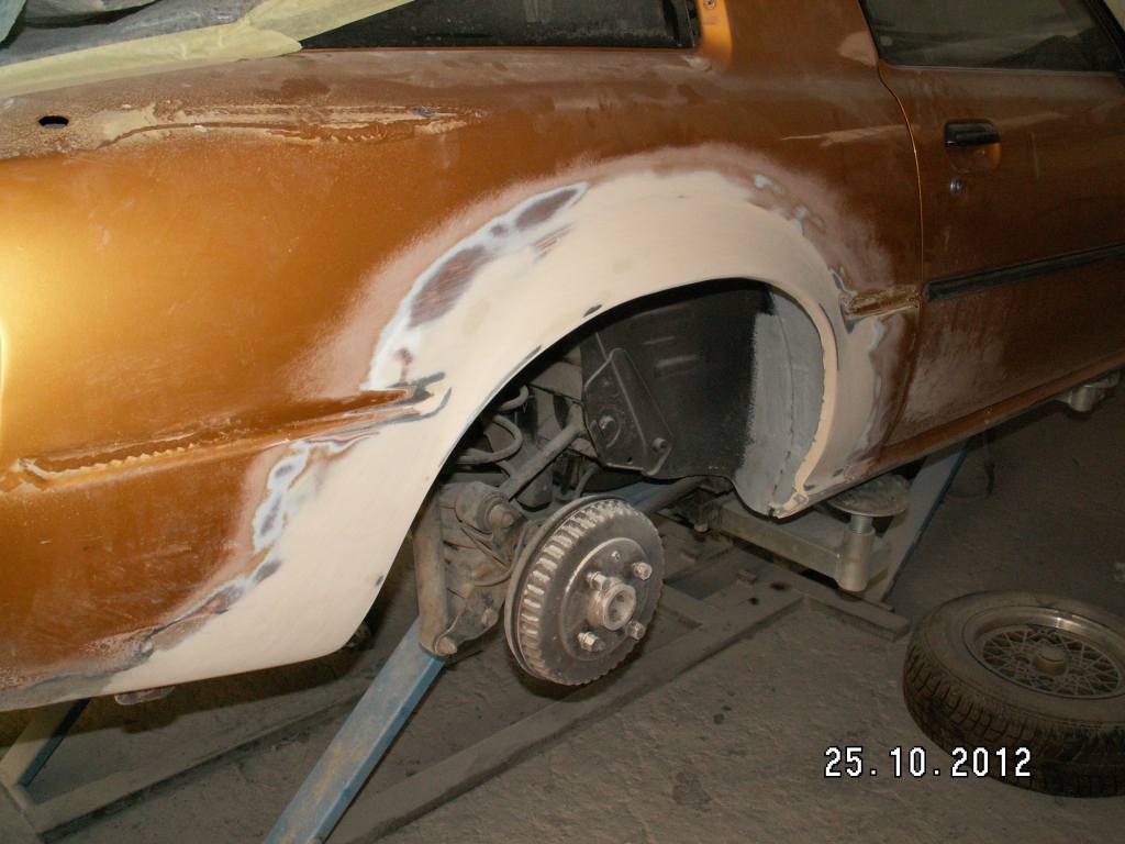

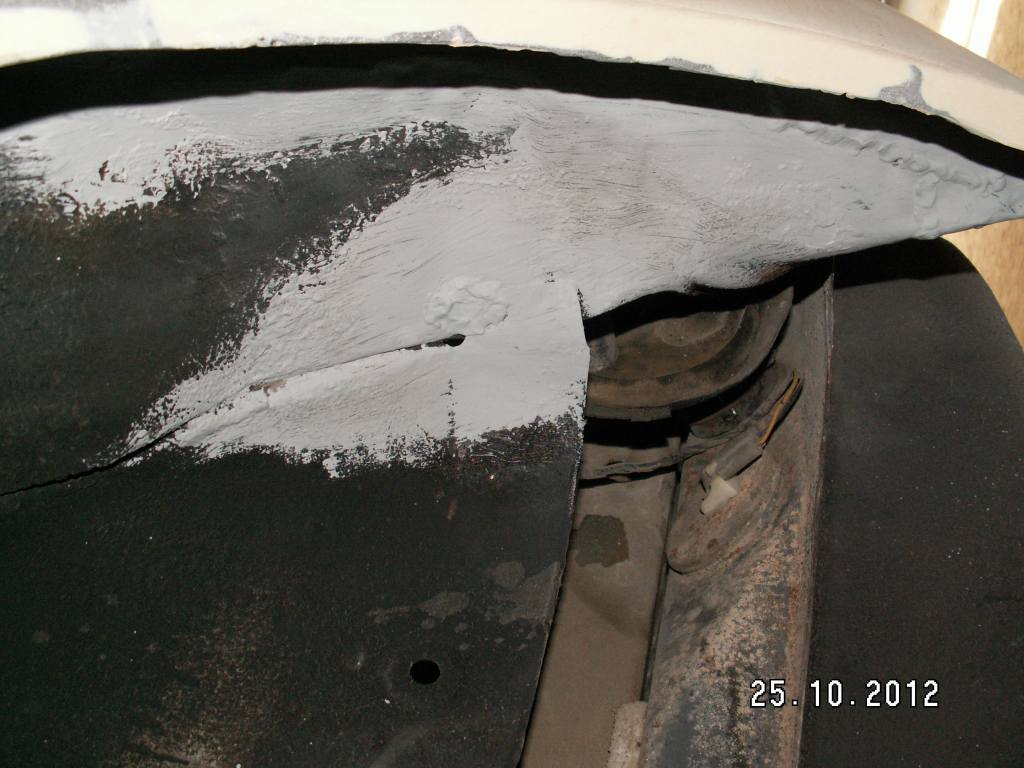

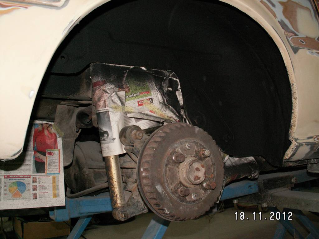

Wheel arches and rear bump area after treatment
Wheel arches had to be restored (they were quite rusty)

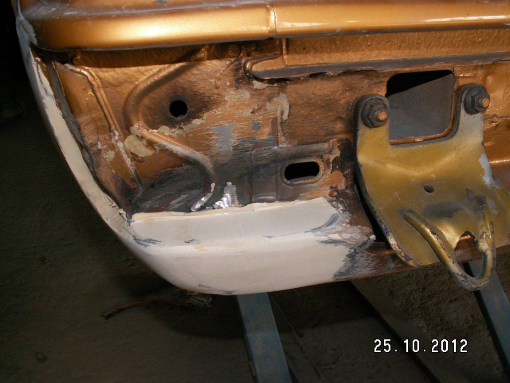

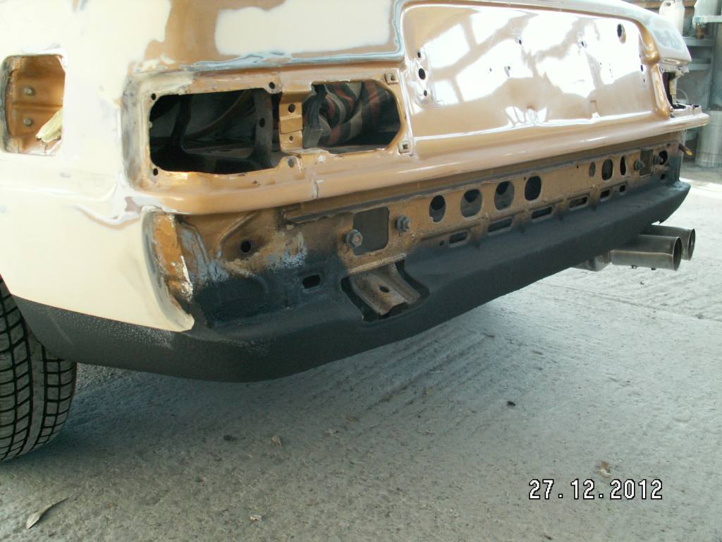

Underneath the bumper after treatment

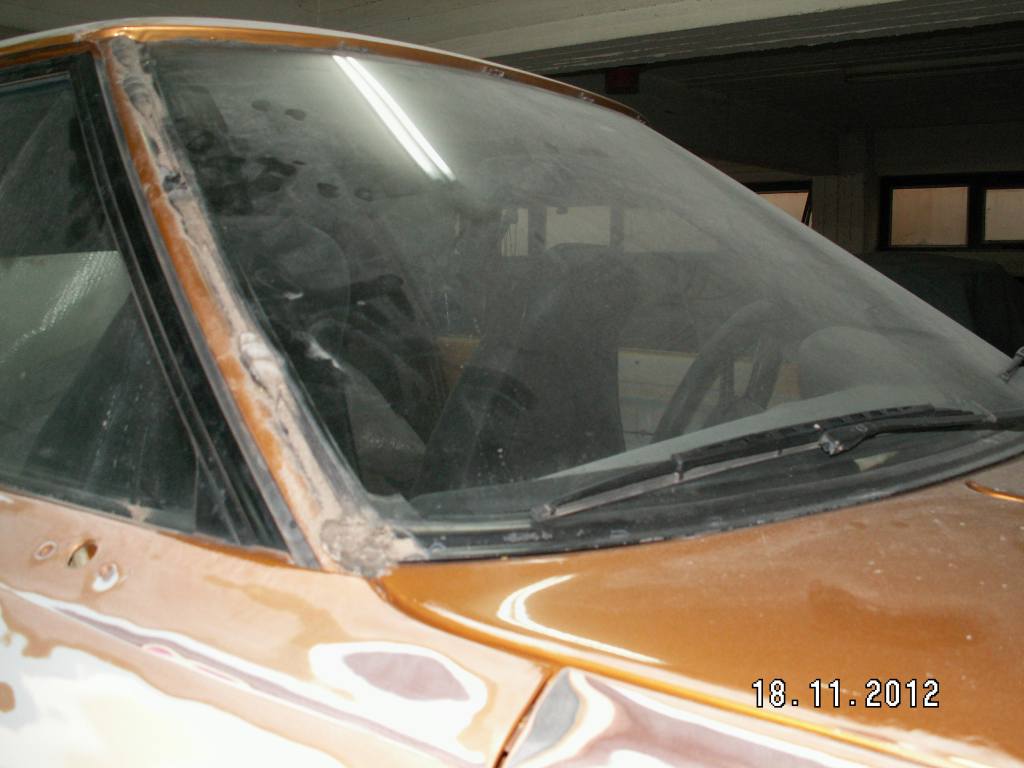

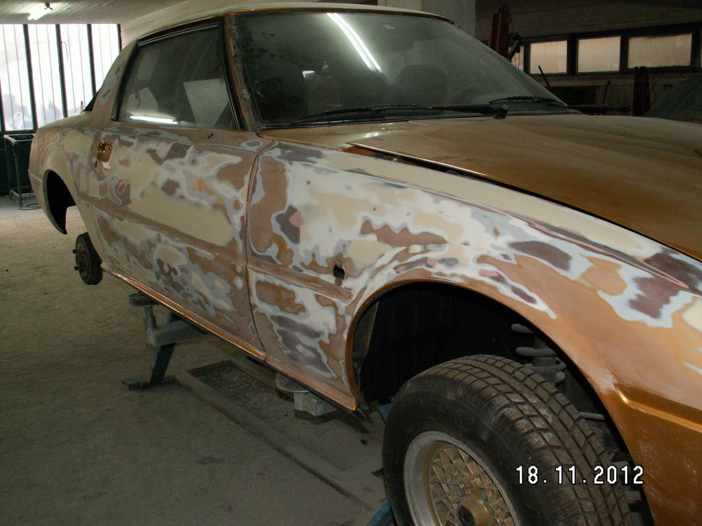

The car was finally fully striped to examine potential rust damages
Luckily, the windscreen area was rustfree.

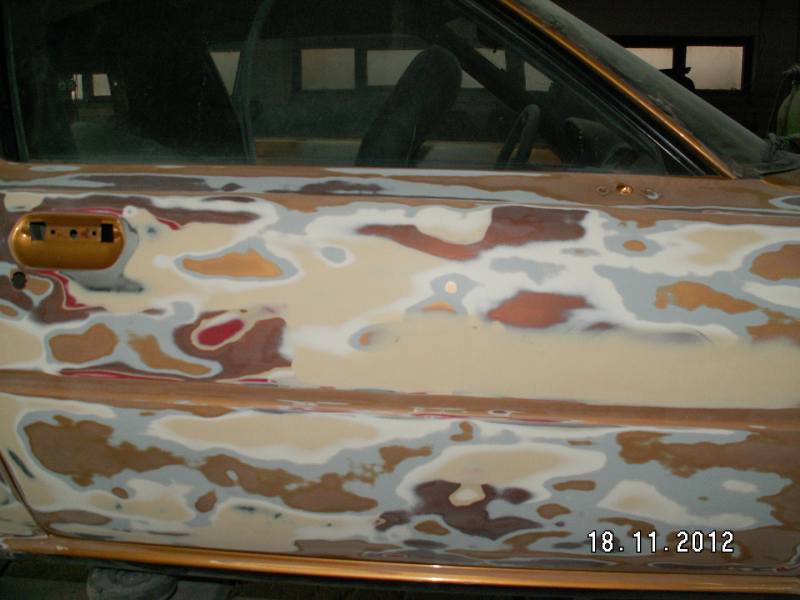

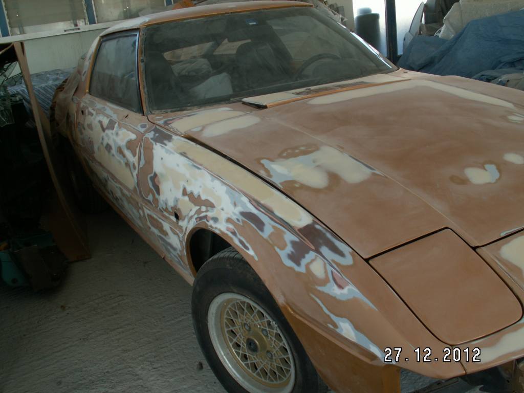

Passengers door ( the right one - we are in Greece remember?) revealed. At some stage of its life was red! (obviously obtained from another RX-7 SA car) The original one rests in peace (or in rust should I say?)

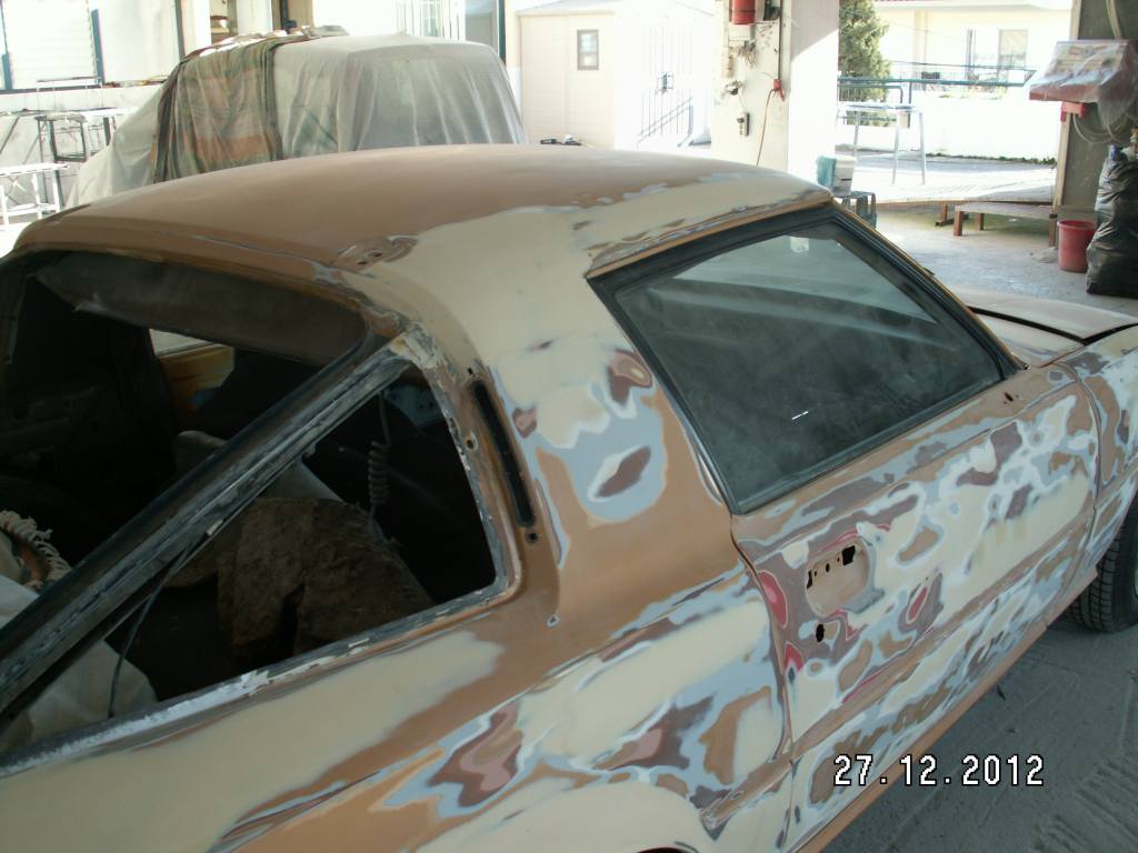

General view
General view

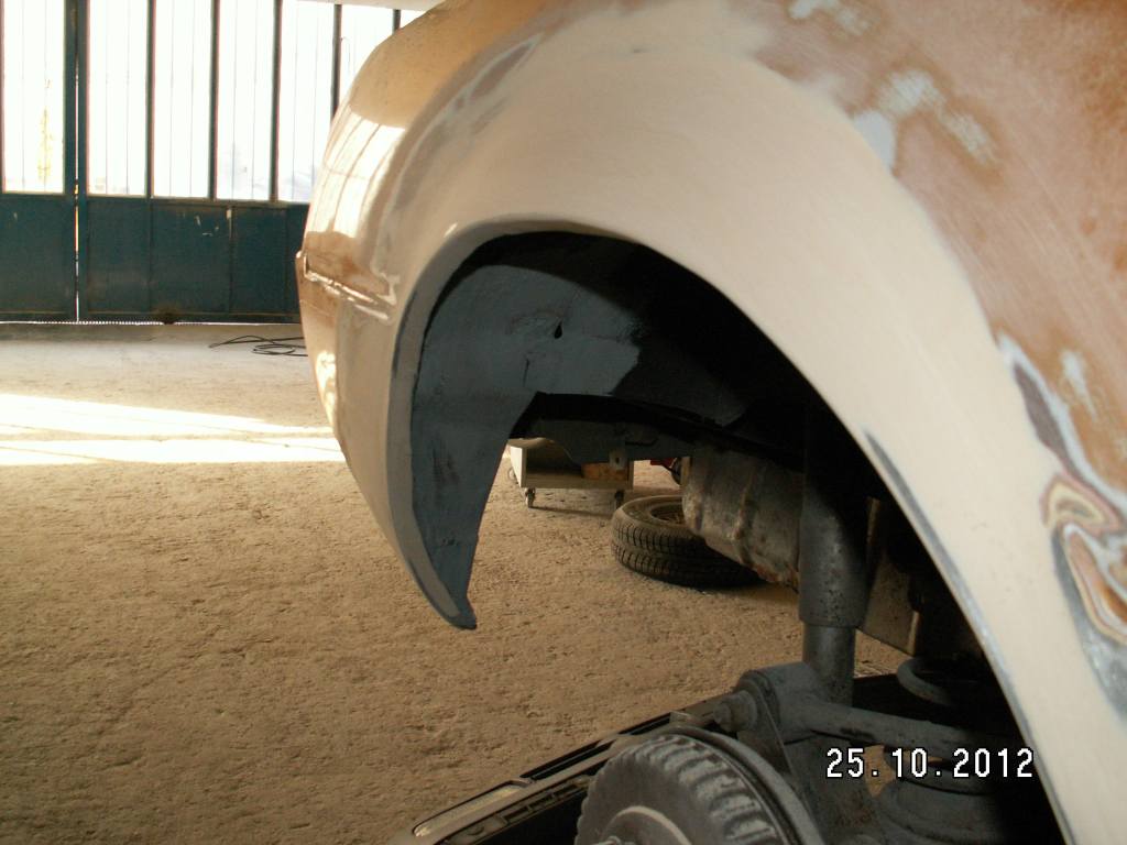

The whell arches were sprayed

Car ready to go for the paint-job
