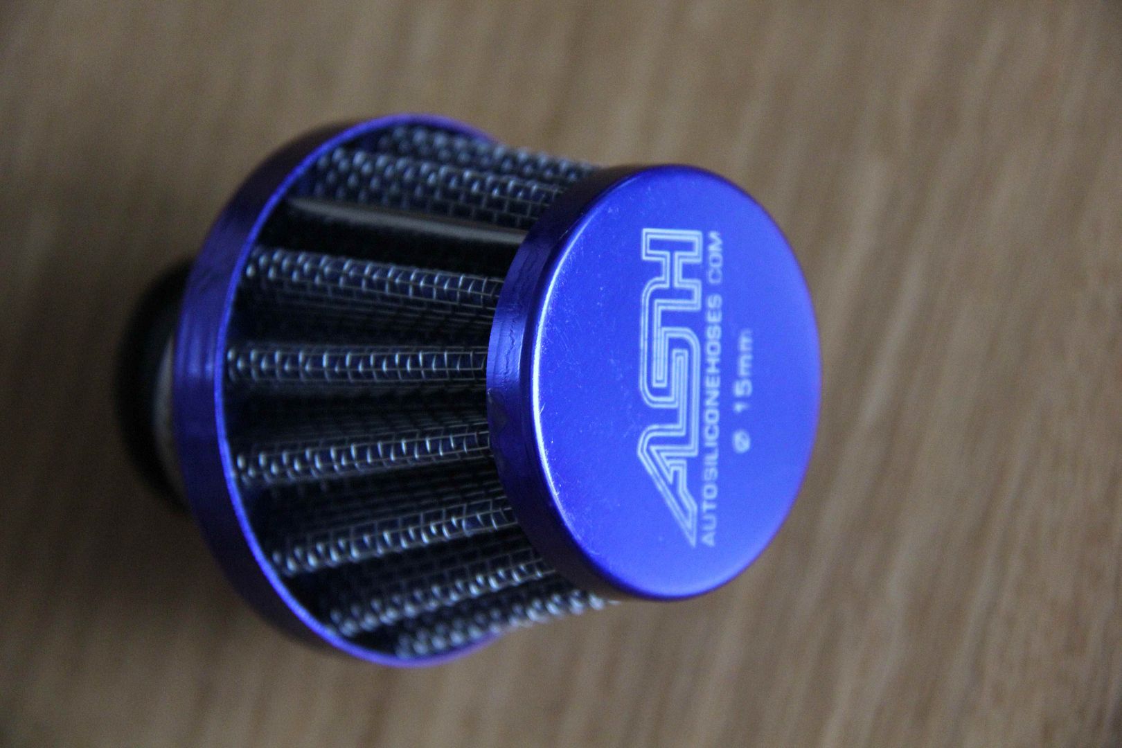

I'm not sure about just bunging the pipes. Maybe because I'm paranoid (like six years of FD ownership has certainly given me acute rotornoia) but I think the airbox was designed to work with those holes moving air to and from somewhere and it may affect how efficient it is if I just bung them. I'm certainly not going to be crimping them flat with a vice, that's just outright barbarism :o So I thought a good half-way compromise is a couple fo these li'l fellas;
If it looks ludicrous I may go for finding a good secondhand "Blue Box of God" and butchering that, but no way am I doing any permanent mullerage to this one
