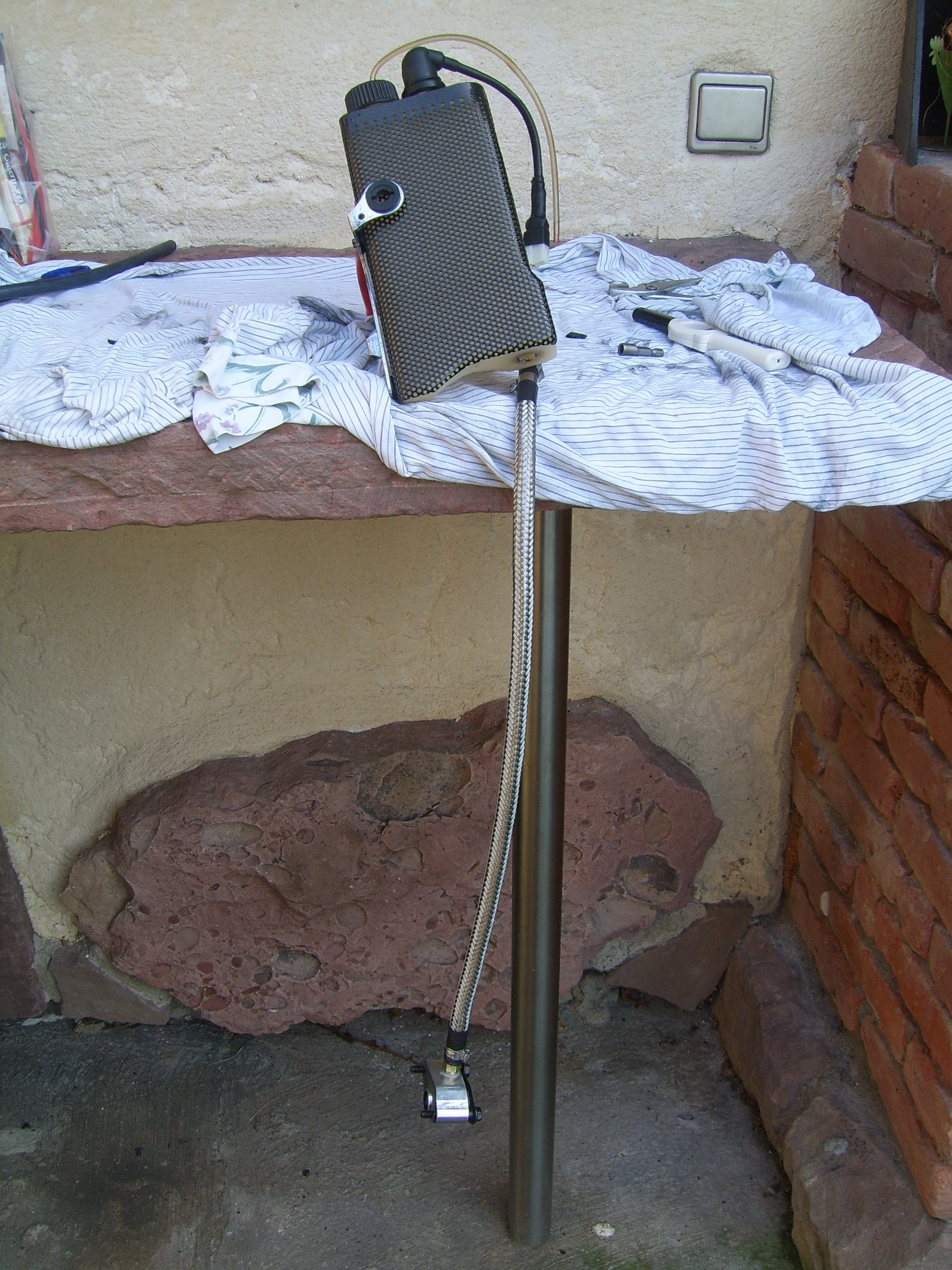

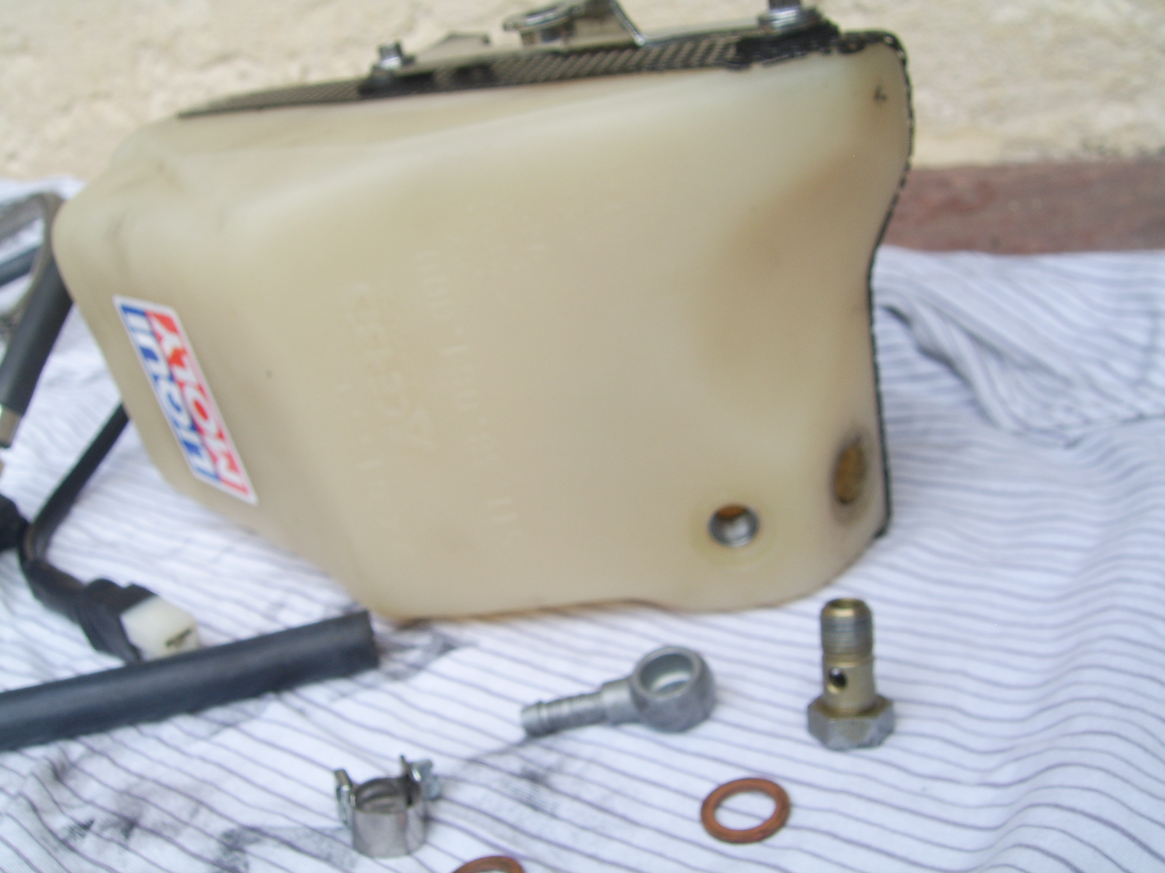

@IAN connected level Check with the warning Light oilpan empty in my dashboard (remember i have the new style dashboard never built for RHD Rx7)
@Tool oil drain on bottom of the Reservoir upper Tube is only air inlet. I take the Tank from a KTM Motocross bike.

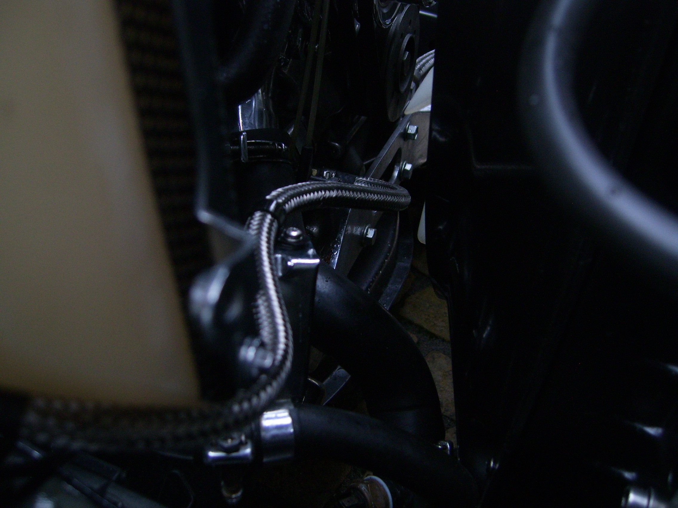

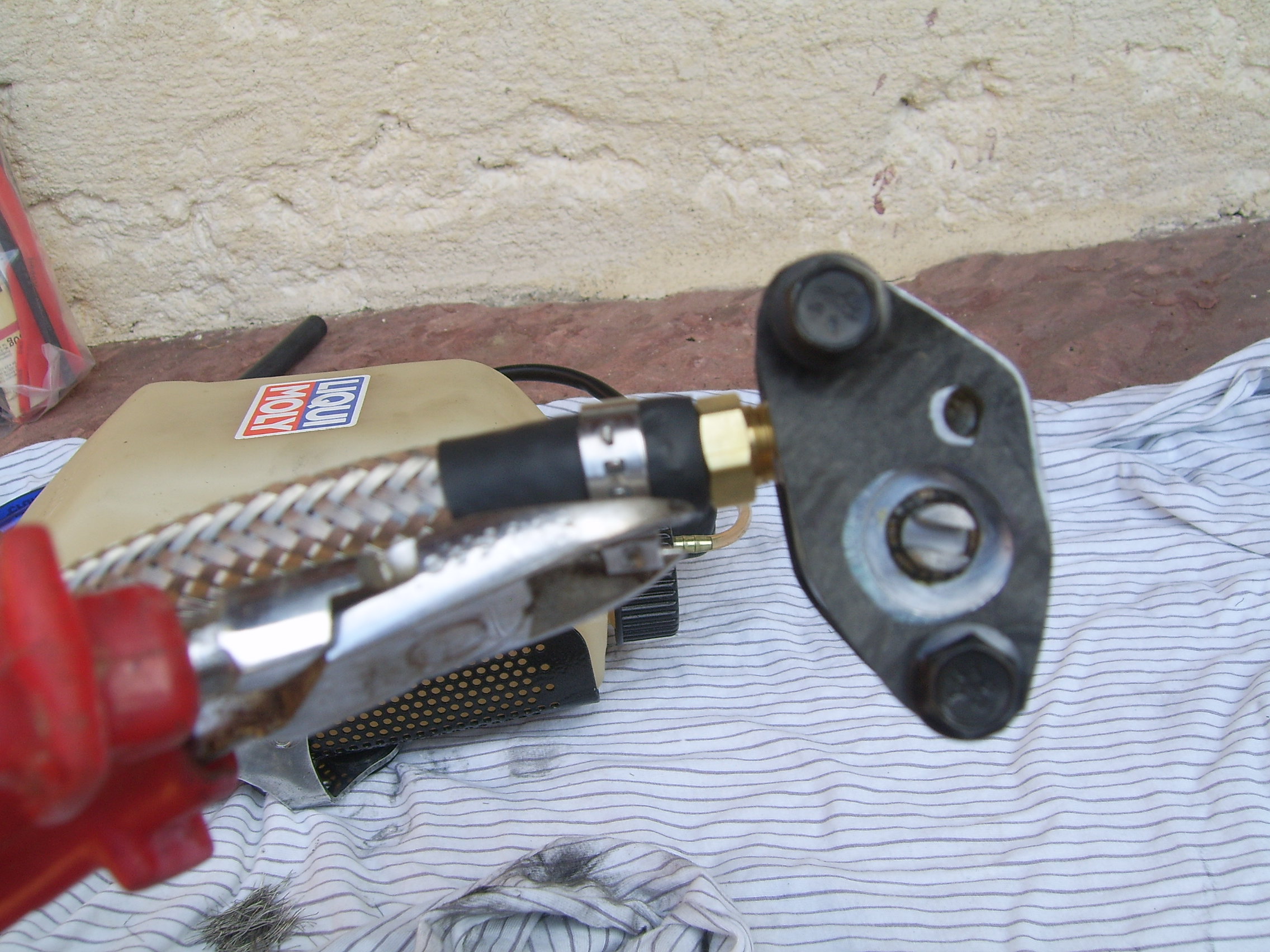

Today finished the work 2 Stroke system:
one way stainless steel hose band clip
Attention only little place between fan and tube so must fixing the tube in right position
