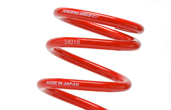

By the time the front bushes are done and I've dropped some of these on it, it should handle great...
I'll need more power then.

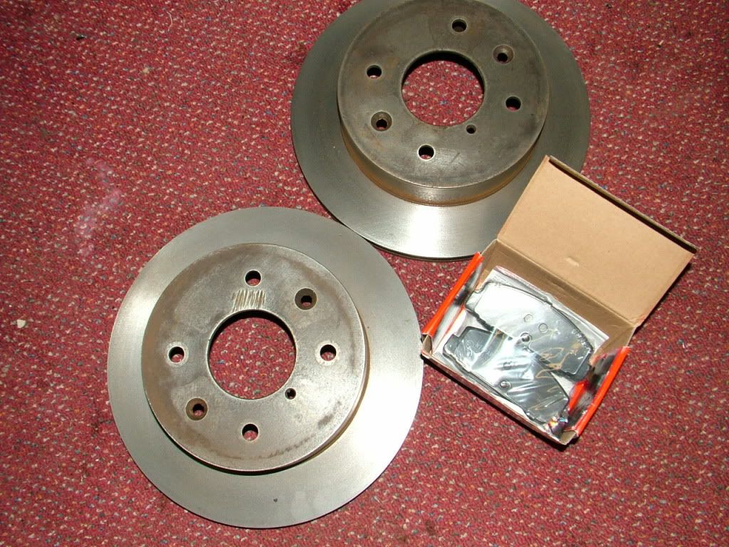

ian65 wrote:yeah Cliff, the bushes were quite horrible...
but it's all back together now on new polys...
I've put my freshly skimmed discs, that Keith very kindly sorted out for me, on the car as well together with a rebuilt NS caliper and new pads...
just need to bleed to brakes now and it should be good to go ( and stop)
