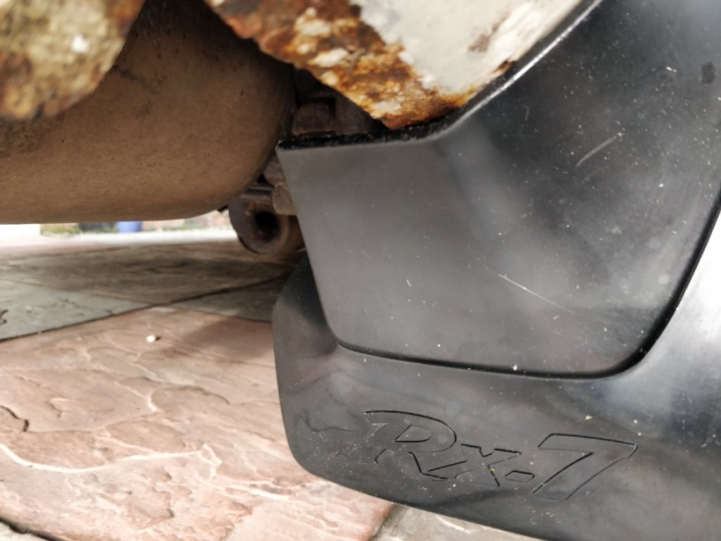

Anyone know what's supposed to go above these mud guards?
Looks like there should be some metal work or a bracket on the left hand side of these. Or do they just 'float'?
