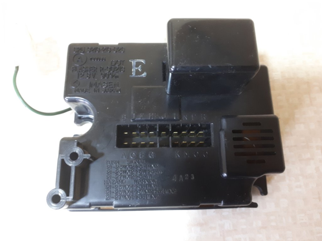

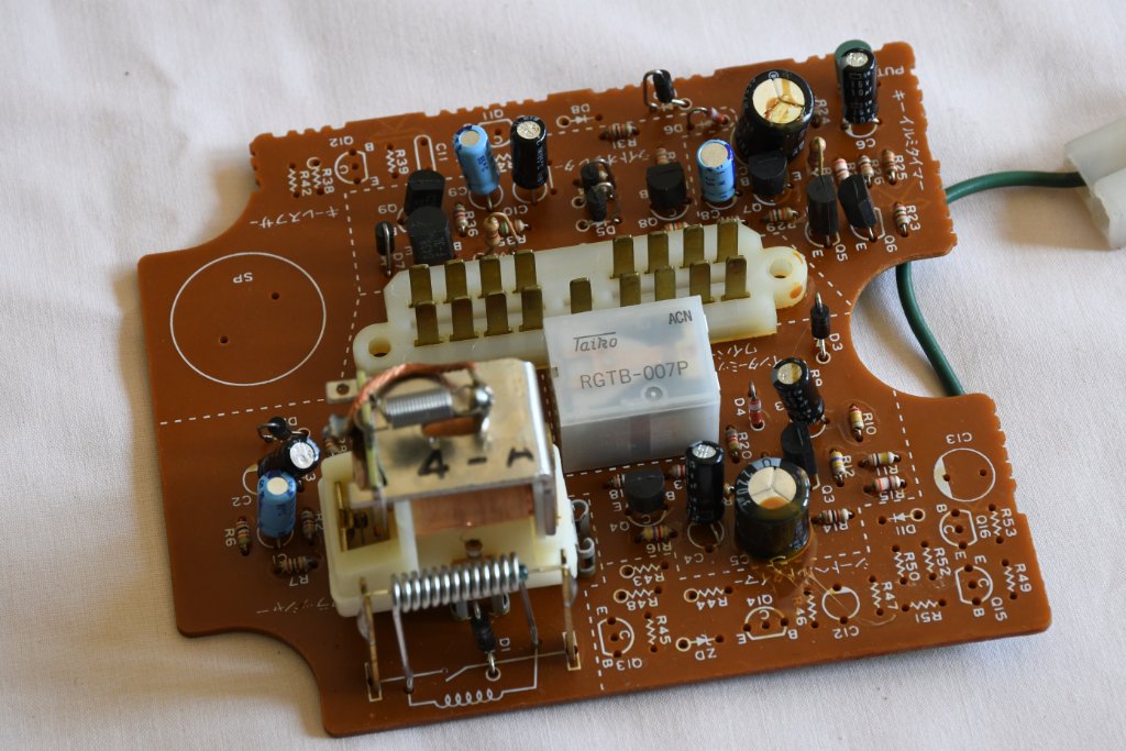

I finally got around to removing the "CPU" from KIMI 3 - more accurately described as the hazard and flasher module :D
It would appear there are several iterations of the innards, as I have a version marked "E", whereas Dave's picture a few pots up shows a "D". The first thing to note is that the "D" version clearly has a "buzzer/speaker" visible through the slotted aperture, whereas my "E" version doesn't have one!

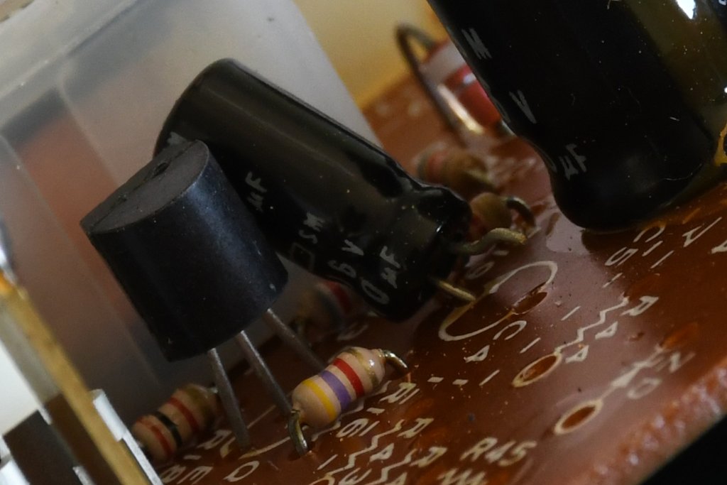

The circuit diagram in the Mazda documentation is as much use as a chocolate teapot. However, a quick visual examination showed this capacitor leg disconnected! You can see the location in the larger picture above, just below the "Taiko" relay. Goodness knows how that got like that in the plastic casing.

I tried to doe some reverse engineering of the circuitry, which is a bit of a nightmare, especially as the Mazda wiring diagrams don't seem to match this "E" version module. Plus, I think a lot of the missing circuitry on the board relates to "seatbelt not fastened" and other warnings that are not present on the UK spec model, so confusing matters. I'm hoping that putting that capacitor back in circuit will fix the annoying buzzing. Without it, by looking at the circuit, I think one of the relays may be chattering and causing the noise. Then again, there might be something else going on.
I haven't worked out why there is a need for 3 relays on the board (2 electromagnetic ones and a reed relay).
I'll resolder the cap in place and put the module back and see what happens. If it's not that, more circuit head scratching will be required :(
