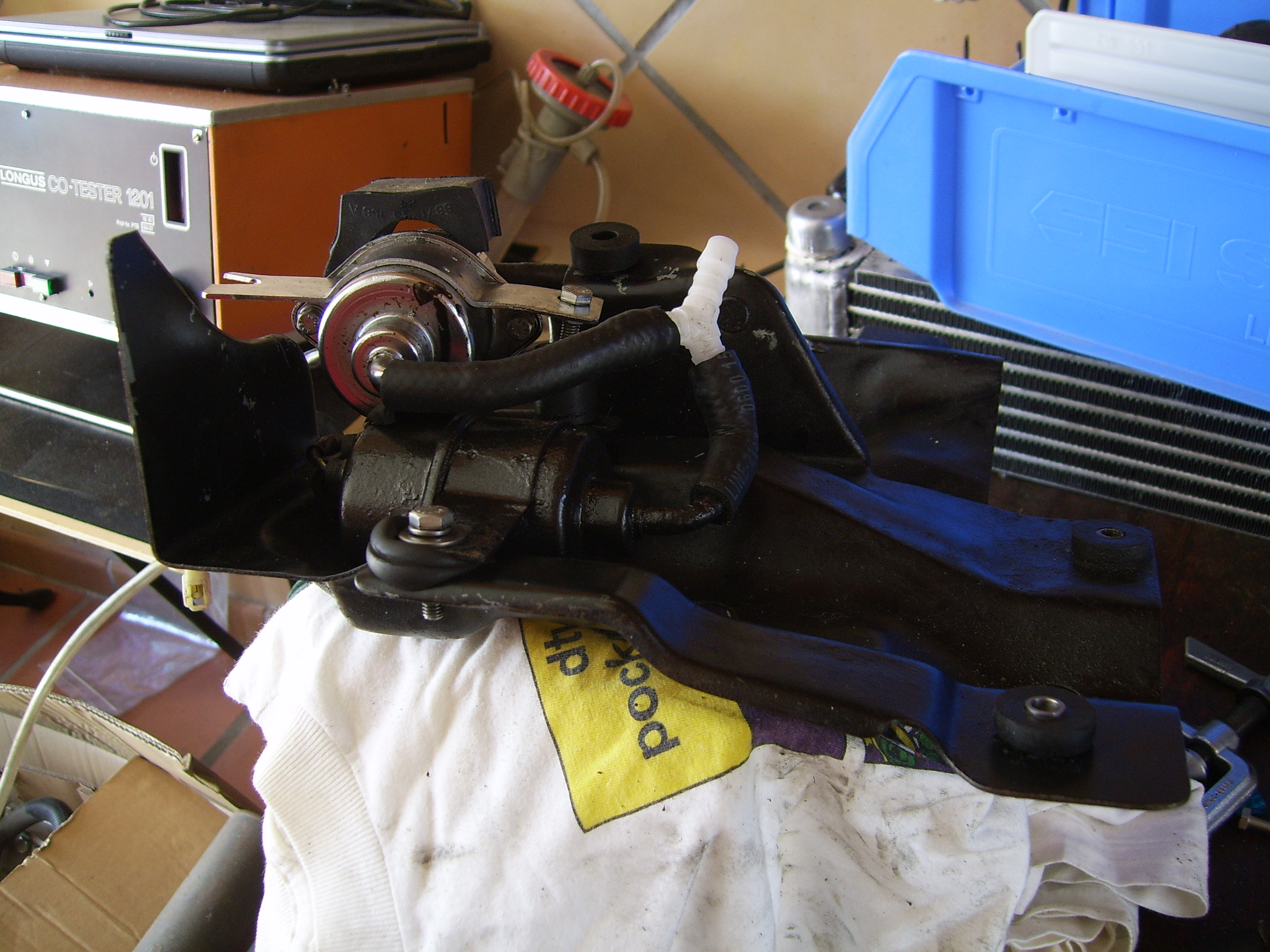

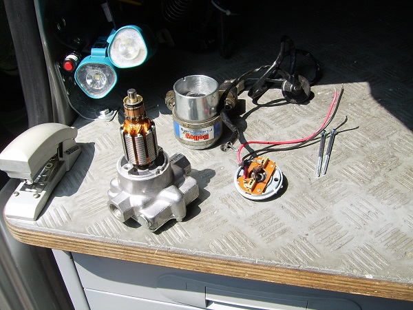

Today built up two fuelpumps together in combination with  moded nikki and 12A Full bridgeport.
anyone else experience with two OEM Pumps ?

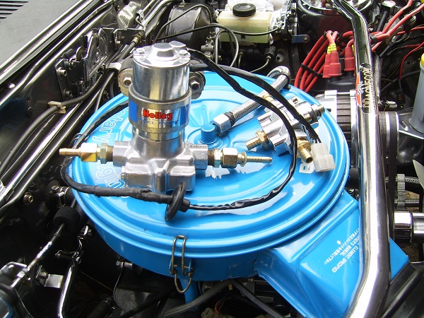

				Two OEM Fuelpump are not enough one german highway 9000U/min. Watertemperature + powerloss tell me i need more fuel.
Next Step is holley blue pump moded with wire connection from Mazda.

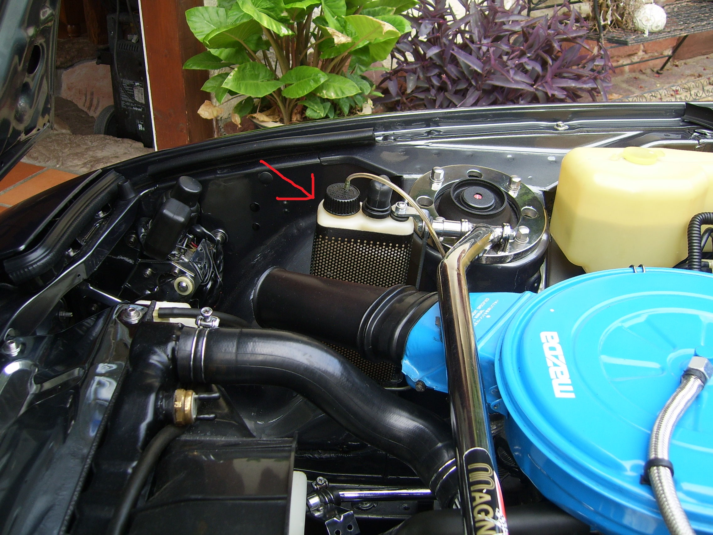

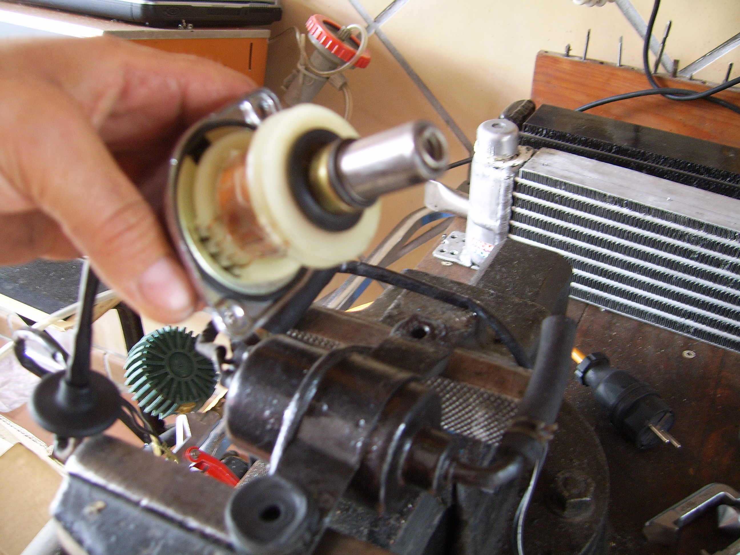

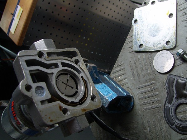

				Got today my Parts for modify the oil metering pump.

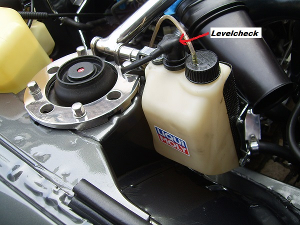

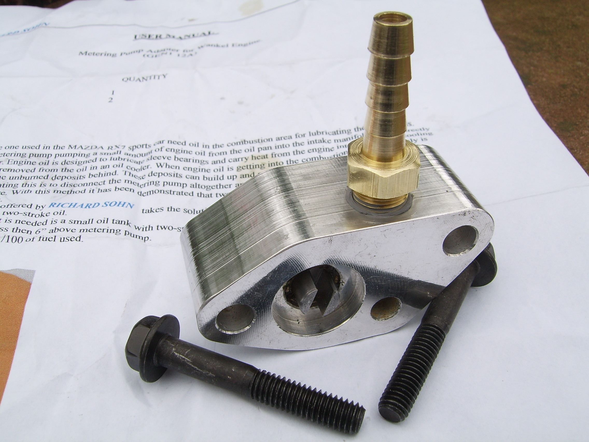

				Delivery comes without gasket. So i need to make them by my own. That´s no problem. Seperate oiltank inside filling level probe . The tank suits perfect to the bodyshell from Rx-7 and i prefer filling a full bottle 1Liter Oil every time so i need capacity of 1,5 Liter.

				this is a cool mod Thomas, I'd like to do this myself..... seems a much better idea to burn proper 2 stroke oil and run fully synthetic in the sump.... Are you putting a warning light on the dash linked to the level indicator on the oil reservoir? More professional job than just pre-mixing too.
				Posted: Wed Oct 08, 2014 5:23 pm
				by TOOL
				Good stuff. I would take the feed from the bottom though so it's a simple gravity feed. Less chance of drawing air.
				Posted: Wed Oct 08, 2014 6:13 pm
				by Lucky
				Where foes the pump come from? Do you have a link? I've often thought of doing this too, as Ian says burning proper 2T oil is a much better idea that sump oil
