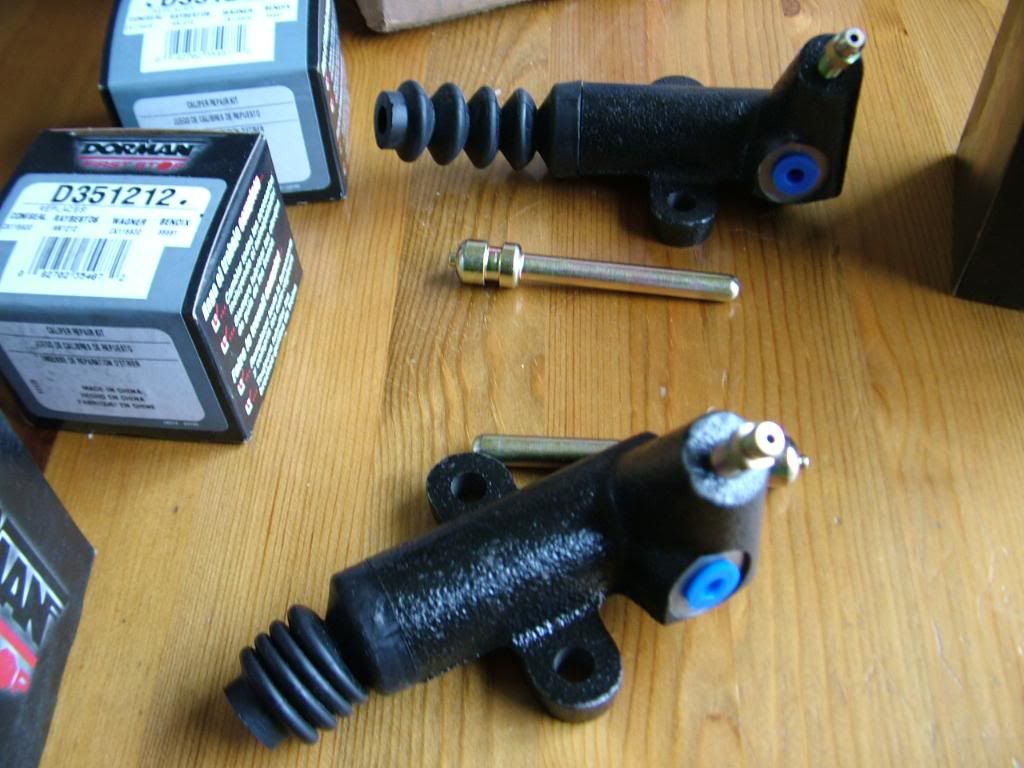

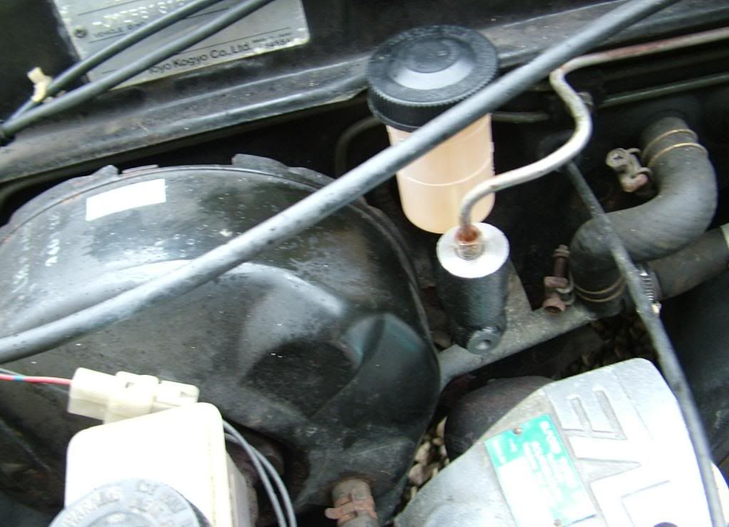

sorted the clutch hydraulics on this car this week after I got the sinking pedal syndrome....
got a slave and master cylinder from the US for a very good price.....
