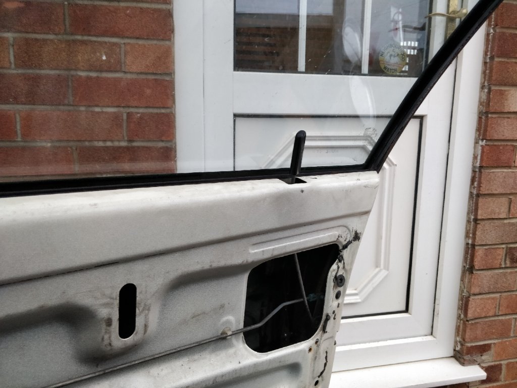

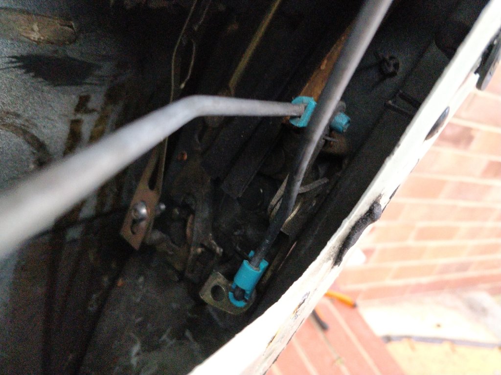

Also fixed the door lock actuator (the inside cabin one), for some reason they were both disconnected and cable tied up. Really annoying having to use the key separately for each door.
They'd also bent it and it took me ages to get the alignment correct again.
Does seem to have improved it, after 20 mins of driving it was starting to get quite hot inside and another 20 mins later on the way home I even hard to turn it down.
I reckon its still gunked up with leaves though.
