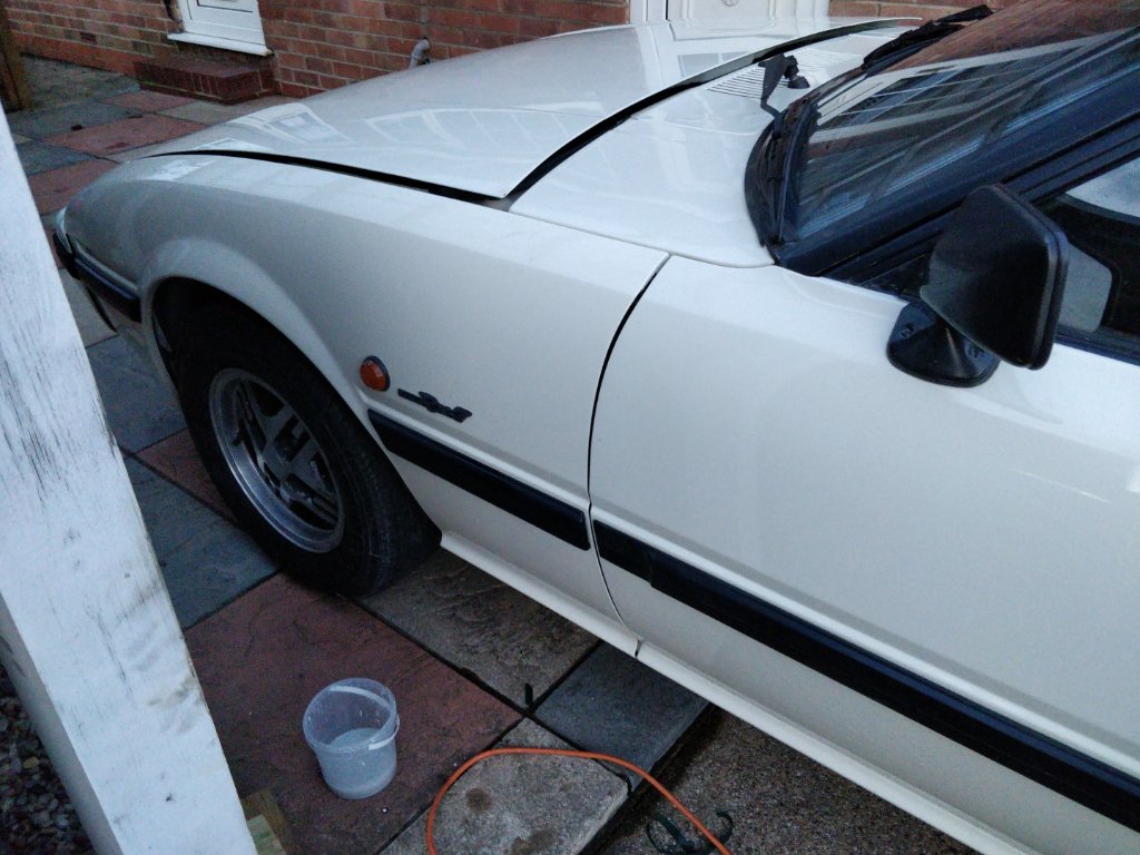

Got to say I'm reasonably happy with that as a first attempt at painting myself.
Just need to reattach mouldings, badges & buff it all up, the colour mismatch isn't noticeably in real life, I think the light must have been weird for the one photo where it looks miles out.
That is good work, spraying is not easy, considering it is being done outdoors in the Autumn it is brilliant! The other thing to remember is that only you know the imperfections............nobody else will (unless you tell them) 0-0

Cheers, now I've got the trims & badges on, the looks are much improved.

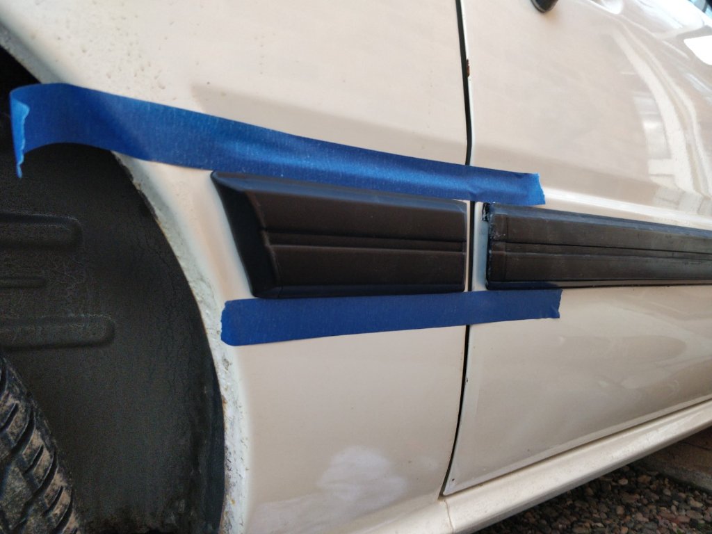

Also some pics with the trim reattached.
I used a double sided trim adhesive tape I found on Amazon that was way cheaper than 3M prices.
