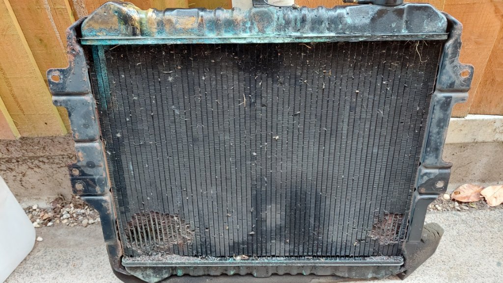

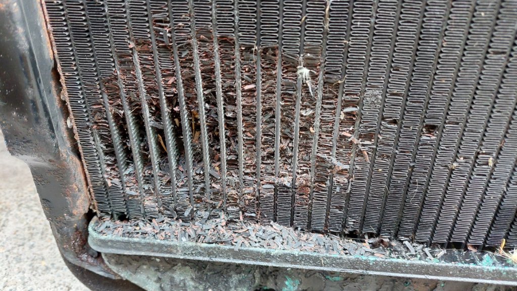

I went into the garage to remove the idler bracket on KIMI 3 (S3), the plan being to replace the bushes with Super Pro poly. Having inspected the bushes they are fine, not original I think, but look like new. However, I noticed a pool of coolant on the sump guard and low level in the expansion tank. The top of the rad tank looked very wet, so I decided to remove the rad and check. This was the what I found:
2021-09-17 17.27.28.jpg (201.42 KiB) Viewed 7091 times
2021-09-17 17.28.04.jpg (224.33 KiB) Viewed 7091 times
A sorry looking mess - just brushing some of the fins around the damaged area was enough to cause them to detach themselves :(
So new rad, or re-core?

Hi Malcolm, I had mine recored but using a 3 core panel replacing the original 2 core, it wasn't cheap if I remember rightly about £275, but kept the original look.
I did phone the Place in Colchester but found one closer to me in Romford.
Good luck
Has thanked: 473 times
Re: New or refurbished radiator
I did the same in 1990. In these times the only option get more cooling.
The 3 core panel will be the best option and so oldschool.

Thanks guys. The Colchester rad place isn't open until Monday, but I'll give them a call then and maybe pop down there to discuss options and get some prices. As I understand it, a "modern core" can be fitted to improve performance, keeping the headers for the original look.

I phoned Colchester Radiator Specialists this morning and they quoted £220 (inc), so I've decided to go that route and have dropped it off this morning. I will collect next Monday (they could have done it sooner, but next Monday suited me). Not super-cheap, but acceptable and they are well-regarded for the quality of their work, having been in business for 30 years. They did a great job on my S2 oil cooler a couple of years back.
At least I know it will fit OK, retain the original look and, most importantly, I can get the car back on the road quickly.
