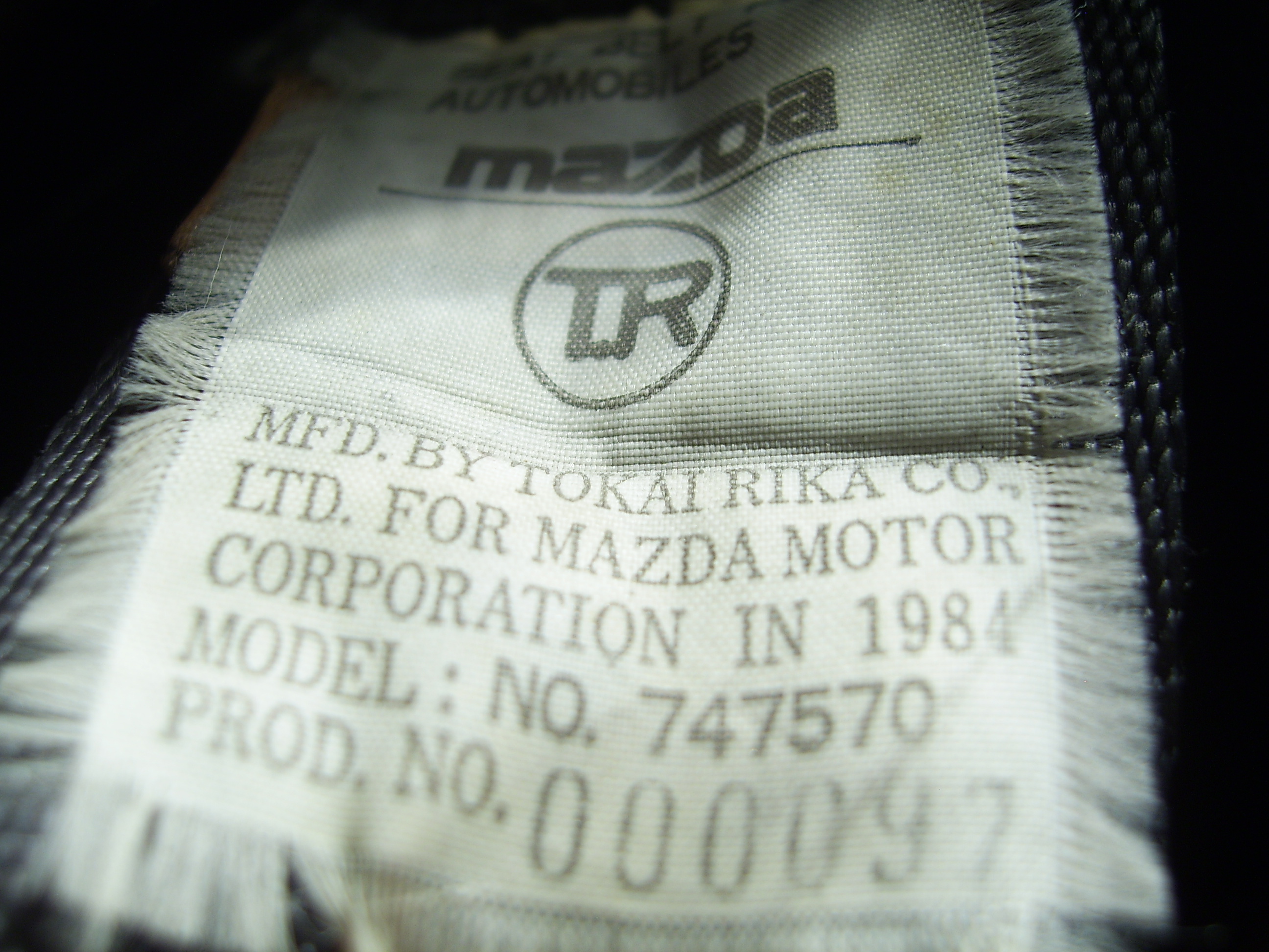

Re: Project Finnish dirtkicker
You can easy control the production number and year. Look on seat belt label . Here is a picture from mine. I think your label is from 1983 or the number is a lot of smaller then mine.

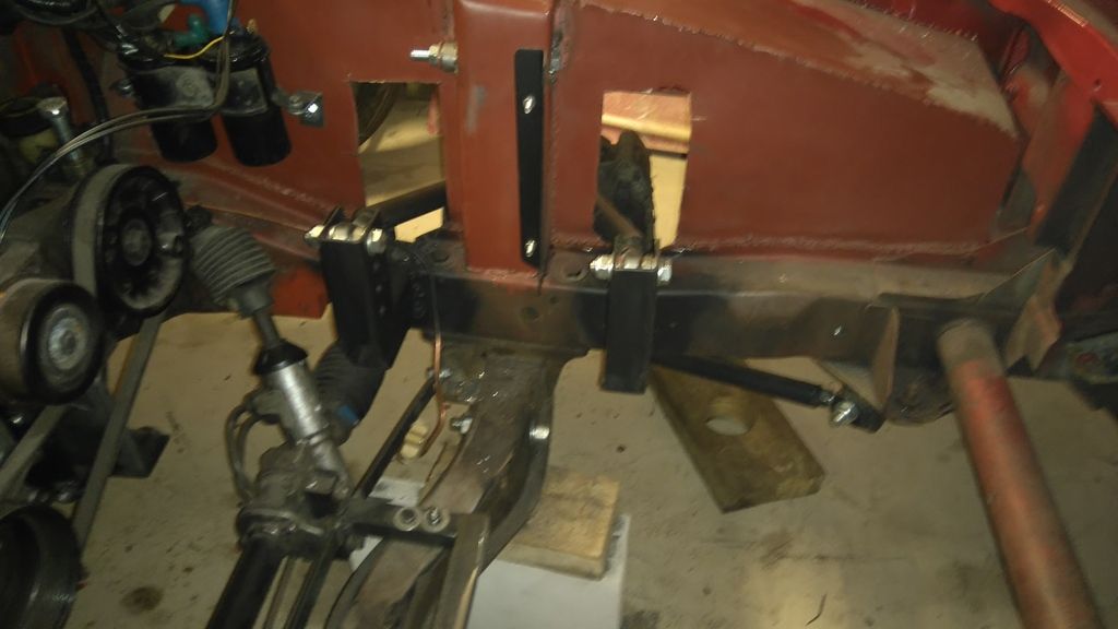

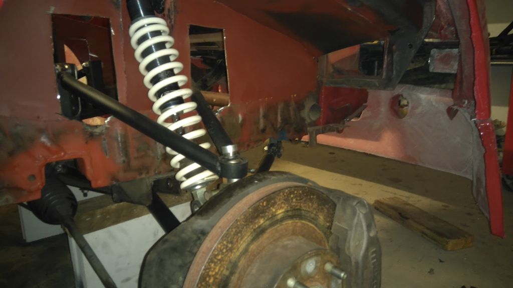

Little update:
Office is almost ready
Front suspension evo 3
Nose is quite "empty" :P

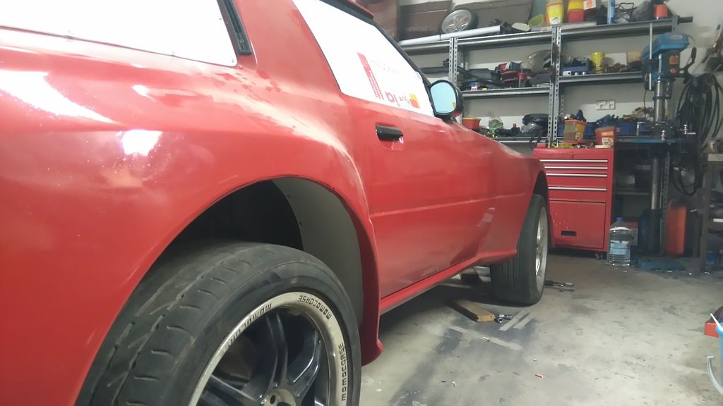

Little update:
Ride height should be something like this. Unfortunatly, springs arent strong enough... But we think we have to cut that spoiler, maybe 10cm so we get more ride height and it wont get ripped off immediately... :)
