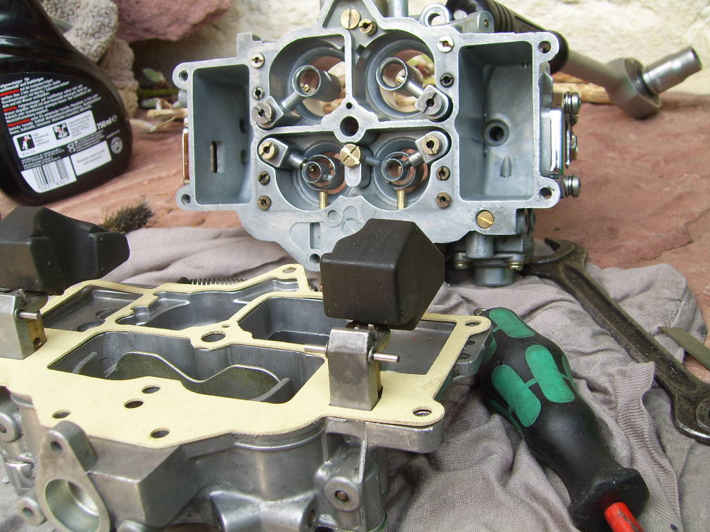

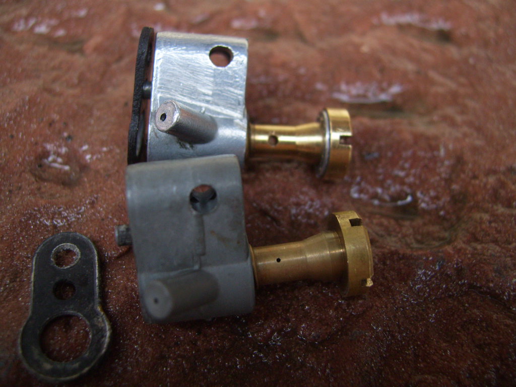

primary venturi 22mm 110mm Jet
secondary venturi 28mm 170mm Jet

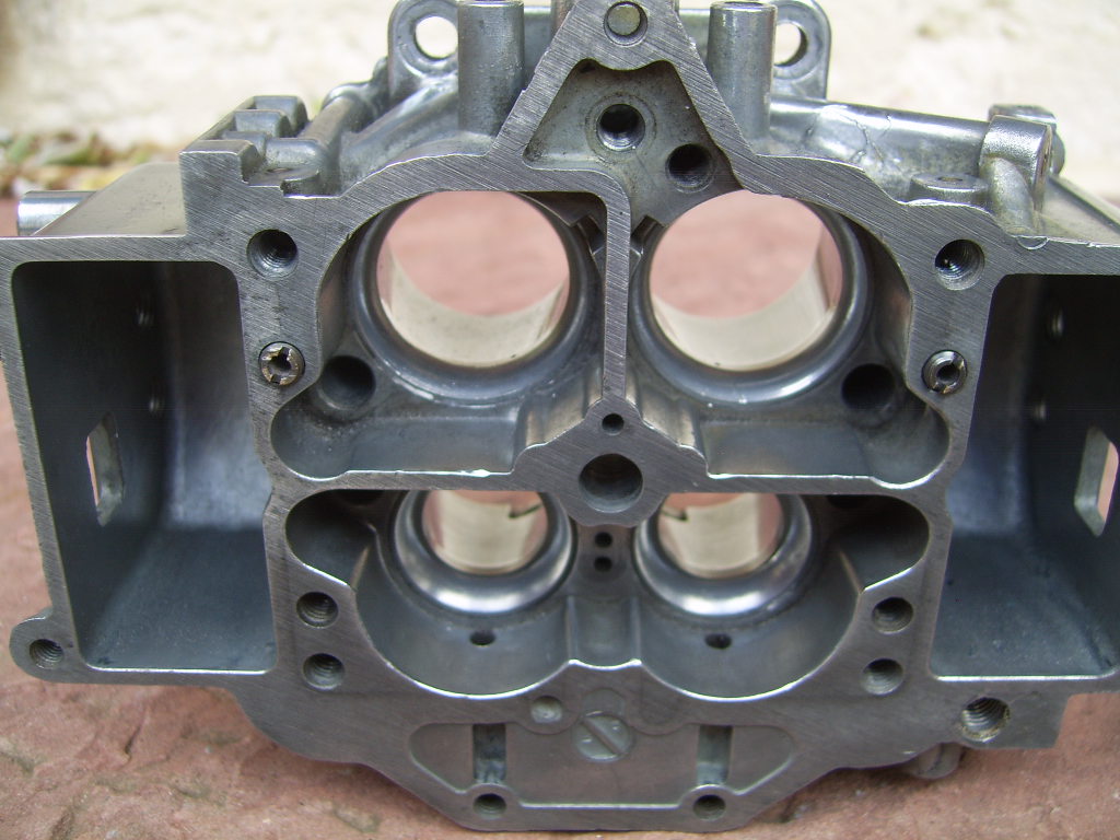

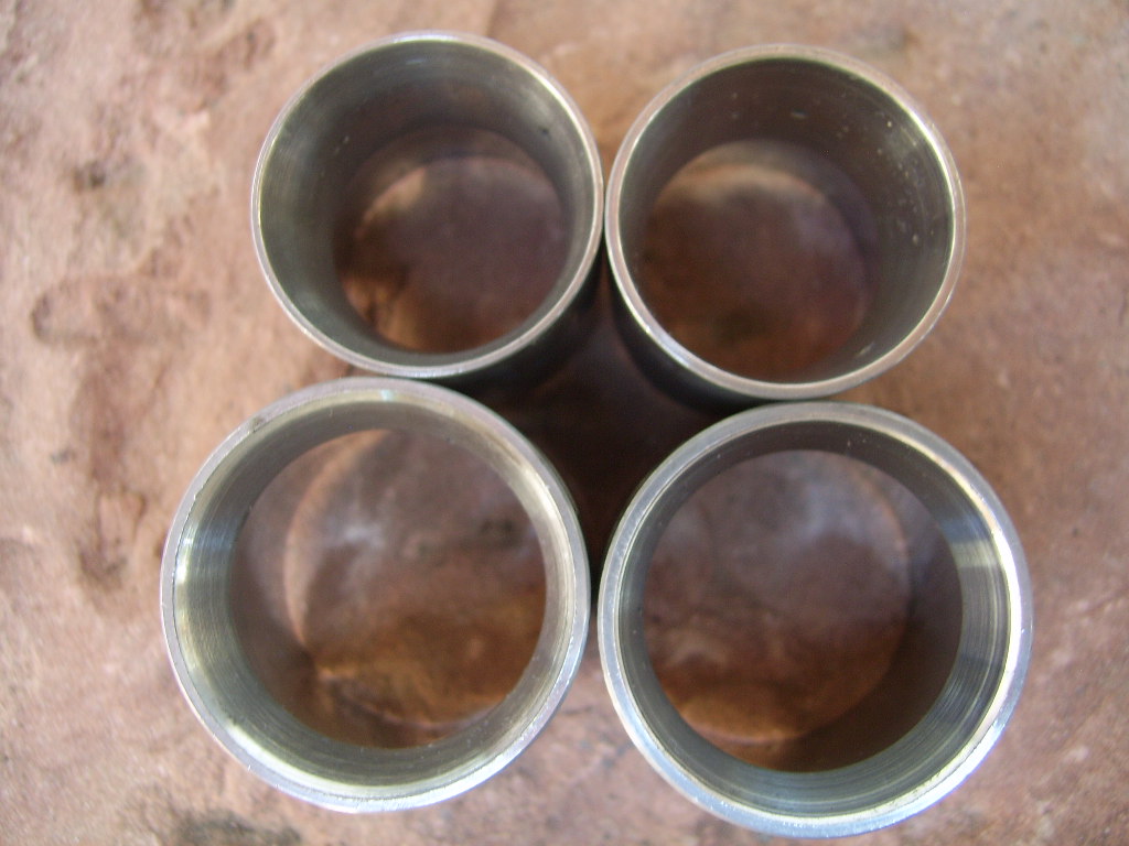

wow, that carb is very clean Thomas, did you have it bead blasted?
ultrasonic bath +enduringness+ polish with
Thomas :lol: :lol: :lol:

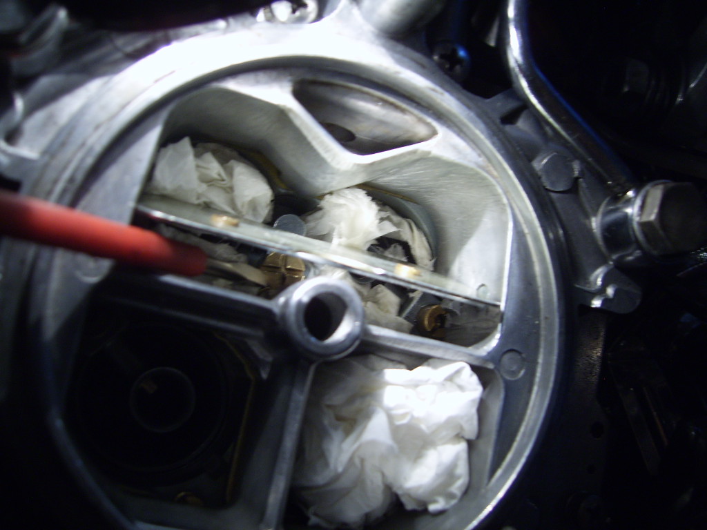

to modify accelarator primary
be possible to change without carburator demontage
additional opening in the aircleaner

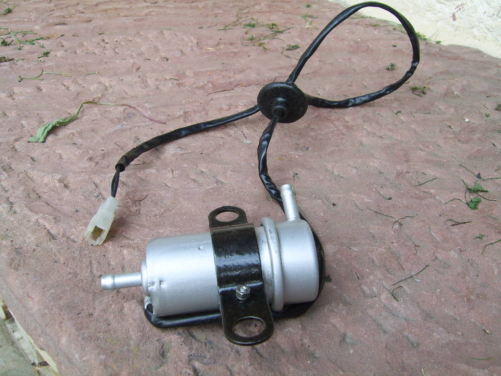

Primary jet 123 + secondary jet 170 works good with super E5 petrol. Nikki works economical and produce enough low torque with the 12A full bridge port for me. Sound is perfect as you can hear on youtube. Test´s with super E10 petrol was shit, I don´t try it again. Fuel pump serie 3 is to small above 8500U/min.
https://www.youtube.com/watch?v=woQ50zuyRDU

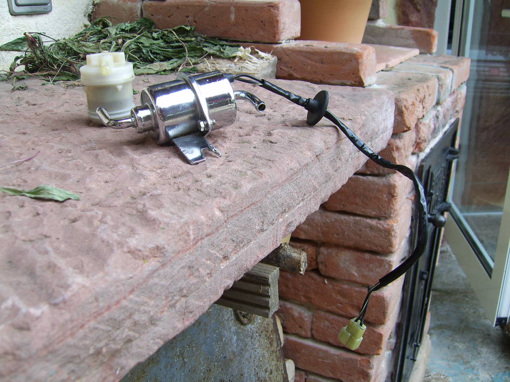

fuelpump serie 2 feedrate 1,100 cc/min
fuel pumpserie 3 feedrate 1,300 cc/min

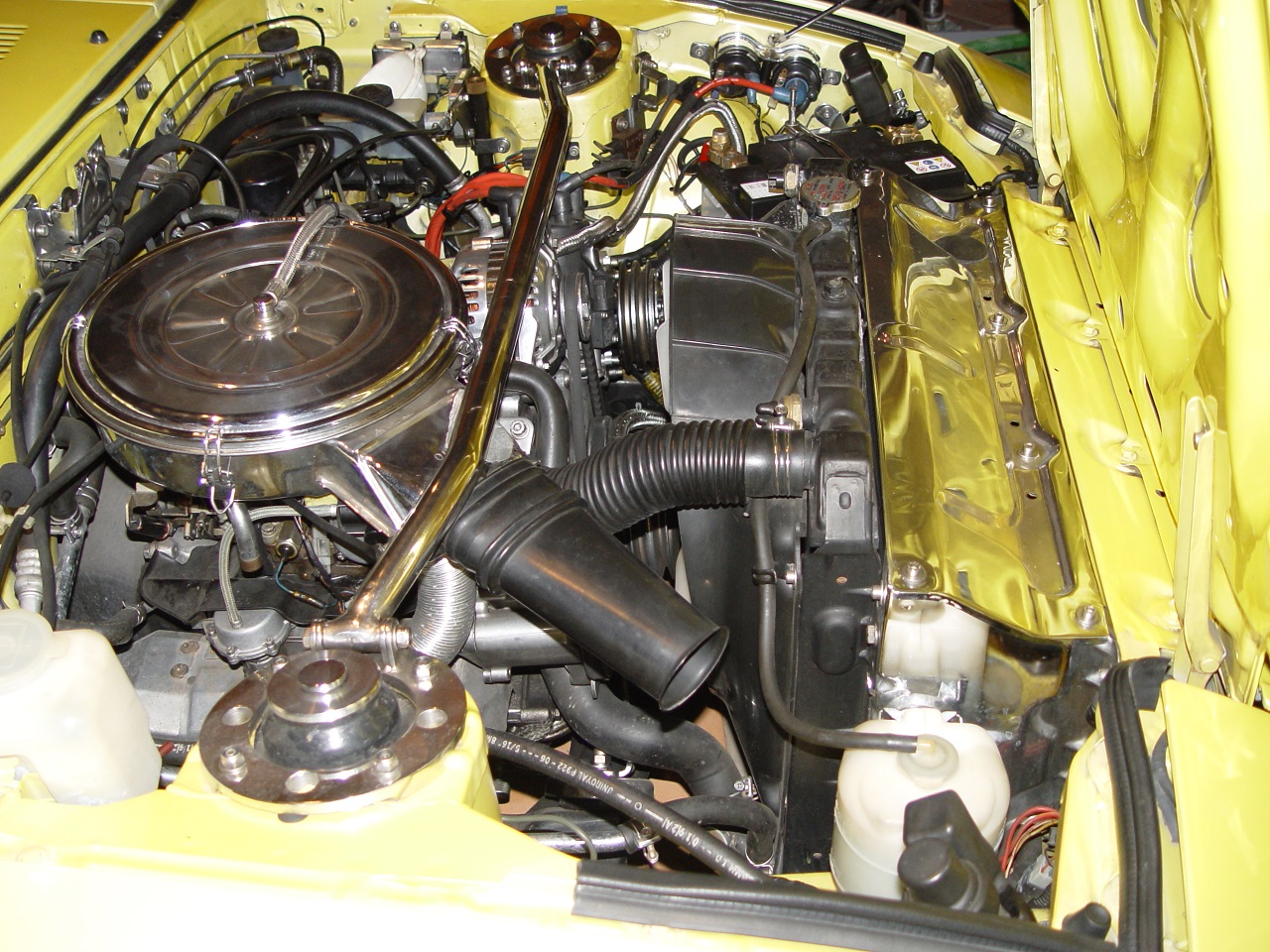

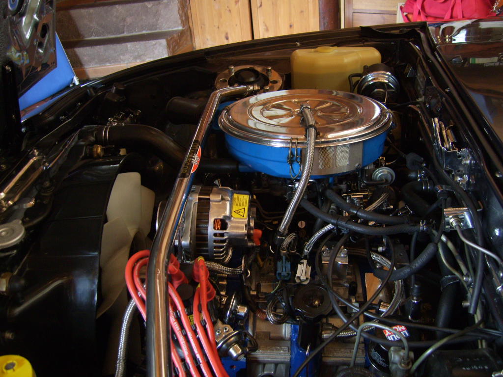

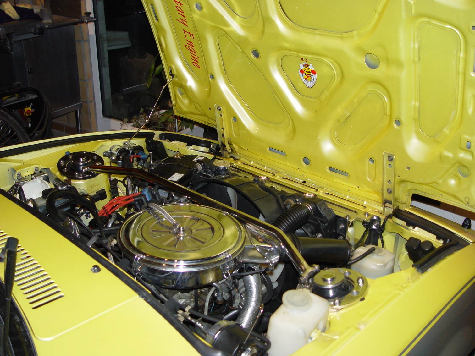

Hi Thomas - I've just read this entire thread and was absolutely fascinated at what you have done and more specifically to the level of quality that you have achieved. To try and put my thoughts into one word, well ........ BRILLIANT !
Awesome W(p Aren't brand new cars supposed to look this good ?
s(c) h[b[
I loved the chromed air cleaner housing, that looks awesome 8-)
