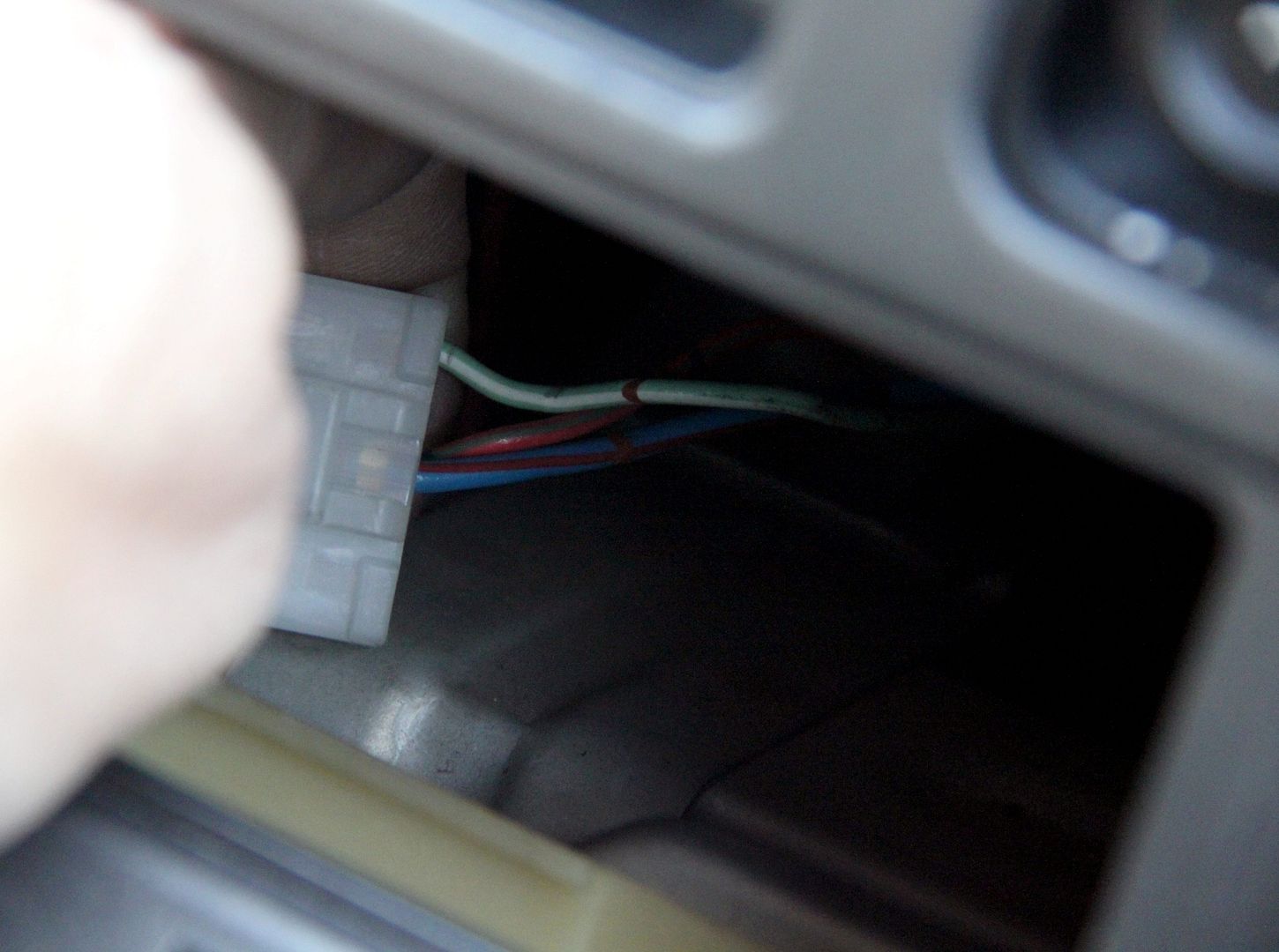

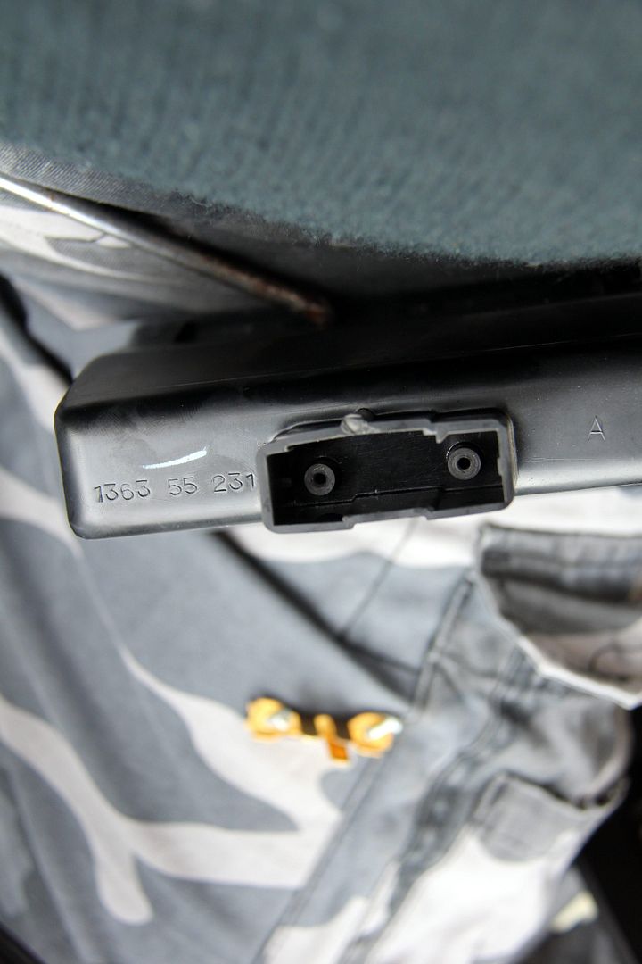

Lucky wrote:Now to the weirdness. The cubby box thing pulls out from a couple of clips (the tray below the ashtray and above the clock, yeah). When I did this I discovered that there's a big nylon electrical plug connected to the back, though the back of the tray itself is blind. Further investigation showed the terminals on the back of the box can be unscrewed;
would this have been a light on some models or something? Seems a lot of effort to go to for no reason I can fathom out. The plug as three wires going into the back of it thus, though I didn't really have time to dismantle the whole dash to see where they went;
myatt1972 wrote:On my old B reg car that Ian cut up the side lights were on permenantly on like DRL's on a Volvo. I tried loads of things to get them off and eventually discovered that unplugging that connector turned them off, very odd !
I've finally gotten around to having a look into this connector as my side lights also stay on all the time also. I unplugged it and they went off :o. I believe its the red/green wire which powers the side lights. The light greenish wire is supplying power to my headunit that was in the car when I bought it. Not sure what it would be normally. The blue/red wire goes up into the loom and I can't figure out where it goes or what it is used for either :lol:. Does anyone else know these days? :? It's still a weird place for it to plug in :lol:
