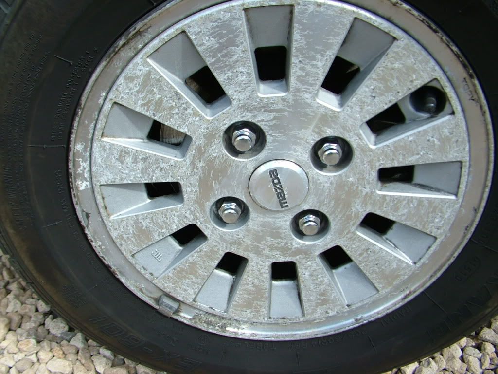

but last weekend, I looked at the wheels and thought that they do let the car down. As I've just done 3 grand on my Jag on repairs and maintenance, I don't want to send another load of £££££'s on the Mazda getting the wheels refurbed so I took one off and had a look at it.
The lacquer had crazed on the wheels like this...
so I got a really fine grit disc on the DA sander and cleaned the old lacquer off...
Next I'm going to put some 2000 grit wet and dry over it and then some cutting compound on the mop.... I reckon it'll come up like a mirror.... the inset bits of the wheel are good so I'll leave them as they are, just clean them up.
A fresh coat of lacquer and they'll be good to go...
Not as good as a machine cut re-face obviously but should be good enough for the time being. We'll see!
I've got a spare set of S3 alloys that I'll probably get professionally refurbed when I've recovered from my open wallet surgery!

It's amazing there was'nt more oxidation under the crazed lacquer,they look miles better already.
They'll lift the whole cars appearance.
