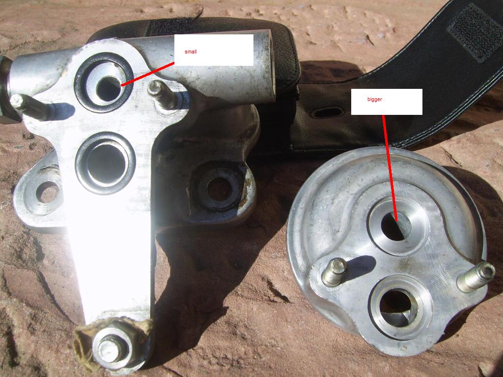

I changed to the filter mount with the bigger hole, hope it´s better with the higher oelpressure.
now the cooled oil reaches the engine lower port.

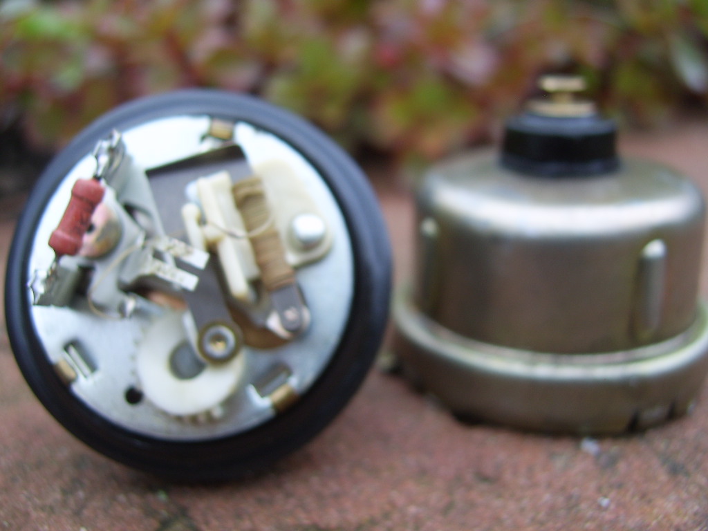

I wanted to know how the oil pressure sensor works. As you can see the senor adjustment is possible.

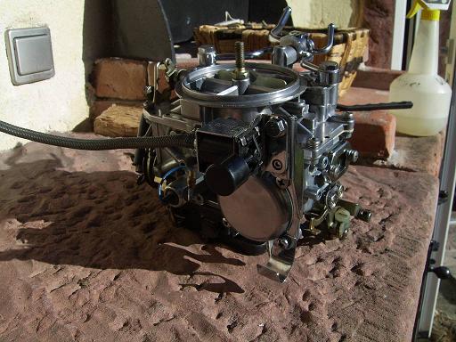

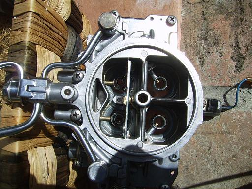

Rebuilt the Spirit R Nikki and the manifold
smaller throttle valve shaft , bigger venturi,bigger primary and secondary fuel jet and accelerator pump.
Carburator 2.JPG (98.55 KiB) Viewed 6618 times
Carburator 3.JPG (91.25 KiB) Viewed 6618 times
