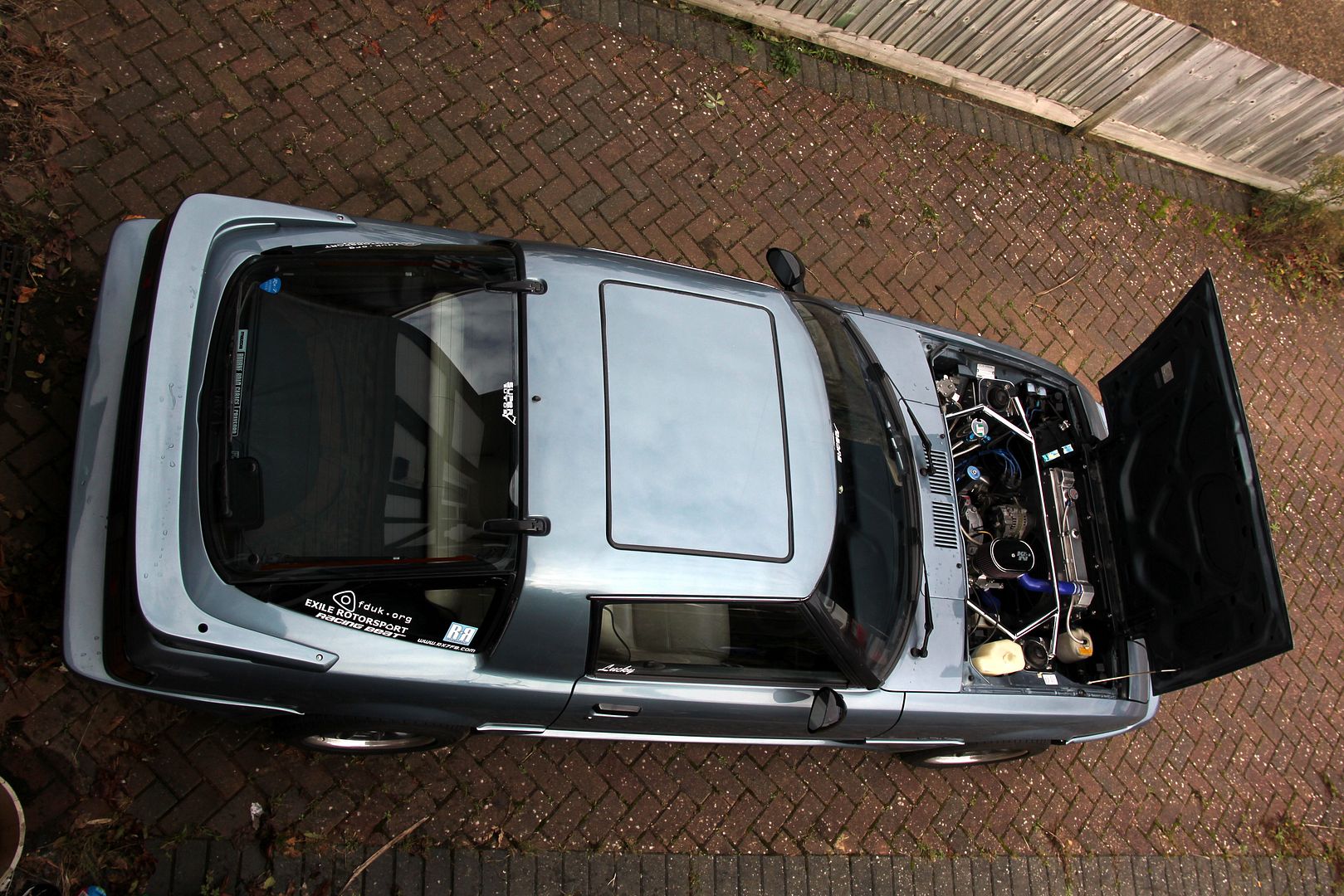

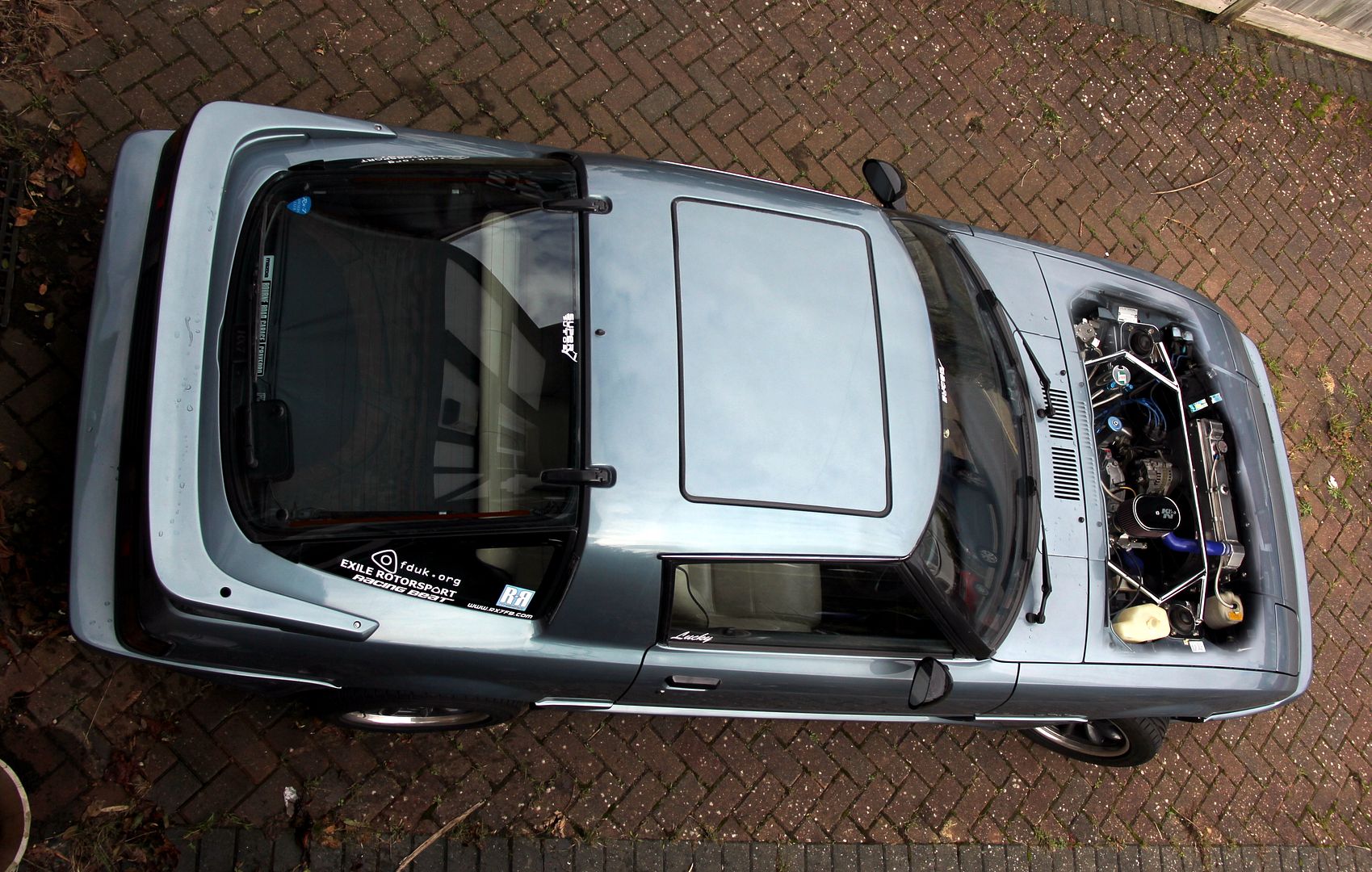

So there we are current and up to date. I took some pics from a slightly unusual angle to celebrate, and even got down to some photoshop trickery. Which seems to have got a mixed reaction, lol. Anyway, I'm happy and I'm loving driving the car, even in this awful weather. She even managed to get me out of the appalling quagmire of a parking field at the Goodwood Breakfast Club after it rained biblically all morning. And that, the joy of driving, is what it's all about. And also a crap advert slogan. Oh yeah... Mazda; the more you see, the more you like. That was the one
