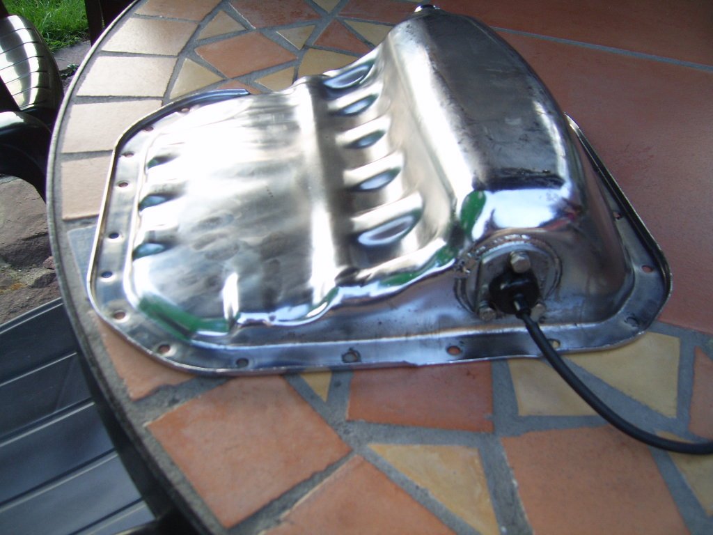

DKWW2000 wrote: Mon May 18, 2020 6:59 pm Thomas.... what colour would you have painted it......maybe a nice Green, Pink or Black. :lol: :lol:
I've chromed it
KiwiDave wrote: Mon May 18, 2020 8:16 pm 'who is going to be looking under your car?' argument, which at the time was quite a reasonable question. 😁
We all here are looking under your car! :oops:
Take it easy as you know i makes a fetish of tidiness. yay
