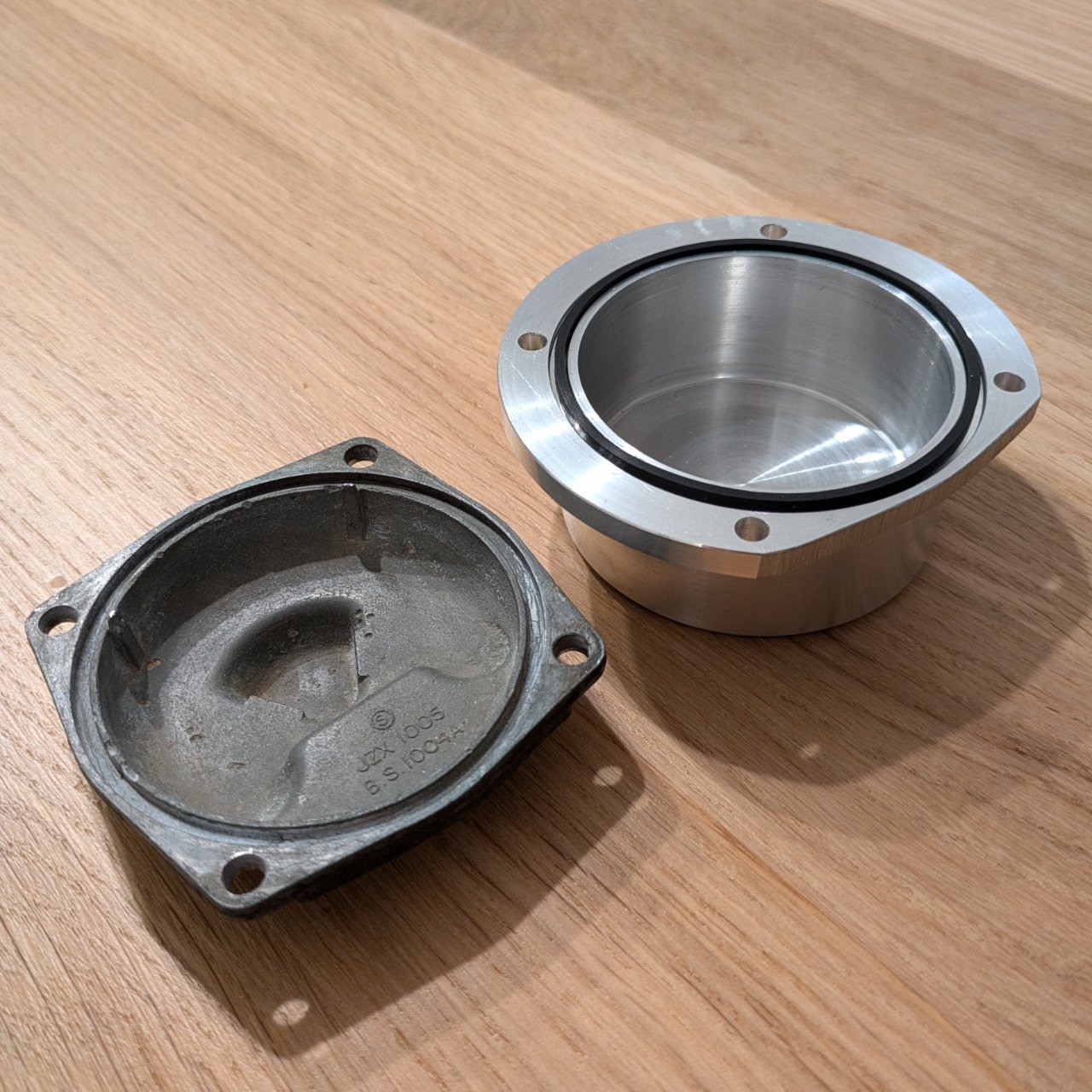

Been busy on other things. Up first for your viewing pleasure, I machined an extended float bowl for the SU carb.
The original "cap" holds 35ml, this new one holds 87ml

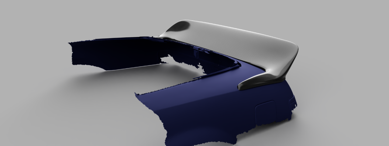

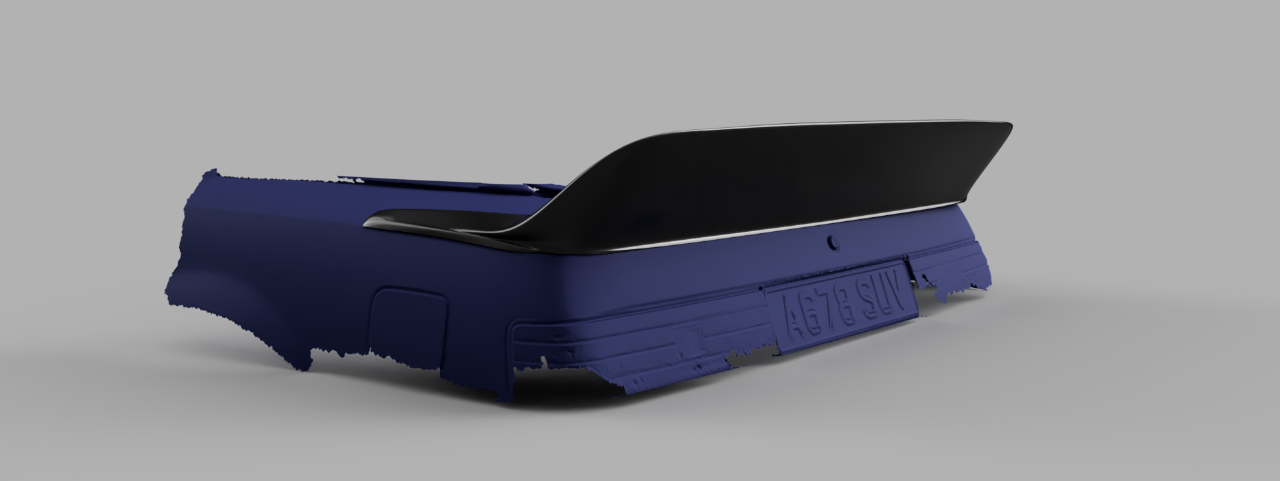

Also been playing with spoiler ideas with the aid of a borrowed 3D scanner and some work in Fusion360
I've yet to 3D print some section to check fitment to the body and get a feel for it in the flesh. If it works I'll probably print the whole thing in ABS, skim with filler and paint.
Yes it's not aerodynamically sound, but it's more about the aesthetic.
Peace and love x

Mean as. I do like a bit of machining. I'm a no spoiler kinda guy, but I like the creativity behind yours aye g-l
