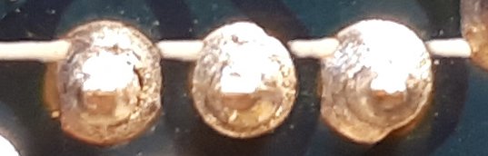

				Took about 30 minutes to locate it, but I found the pesky dry joint and fixed it
 It was nowhere near the FM module that I first suspected.
Very satisfying to get back to my old electronics troubleshooting days! I had the circuit diagrams, which had some helpful notes about expected voltages ate various points. I quickly spotted the FM module wasn't receiving the 8 volt power input it should have when FM is selected. I traced back the primary source of the voltage to an IC pin and it was fine, then traced it to 3 pin 2SD571 NPN transistor being used as a drop down voltage regulator. As soon as I touched a voltage probe onto one of the 3 pins of that transistor, bingo, FM sprang into life
If you look closely at the left solder joint you can see the tell-tale black mark, showing the joint has a void and is compromised.

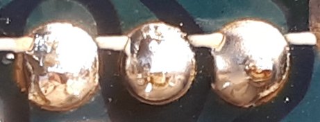

I re-flowed all three joints - FM now solid as a rock!

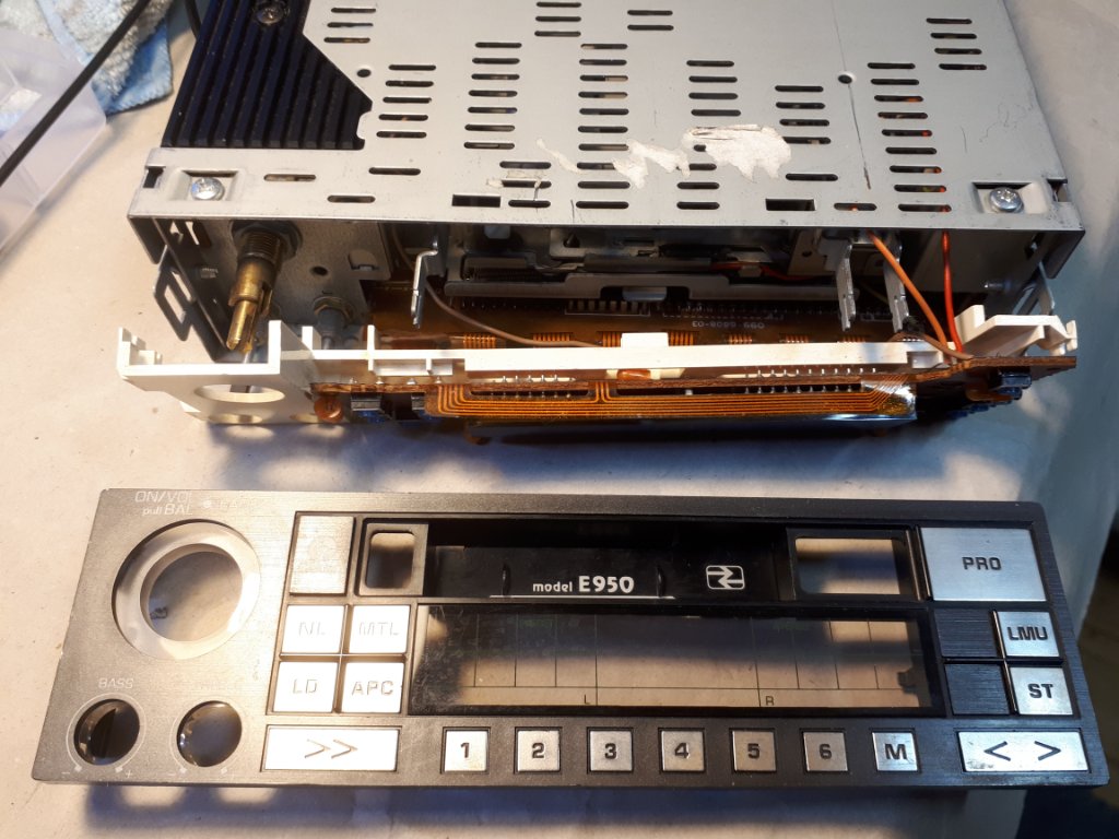

Whilst everything was still in piecse, I decided to remove the front panel and remove 35 years worth of grime before reassembling everything.
						- 2020-03-20 18.11.04.jpg (178.34 KiB) Viewed 13569 times
All cleaned up and back together. That was a right old game. I think a masochist designed that casing

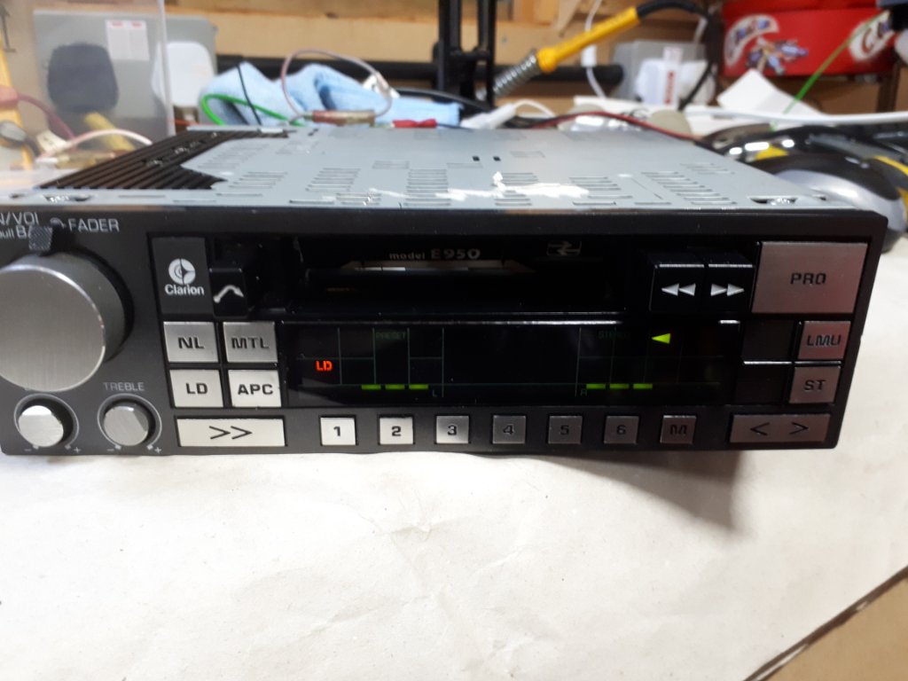

Bonus
  Ian, I was wrong, this model DOES have the rather cool LED sound level indicators!
						- 2020-03-20 19.15.37.jpg (122.08 KiB) Viewed 13569 times
