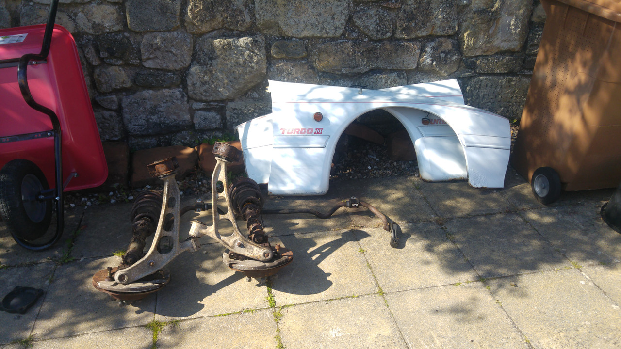

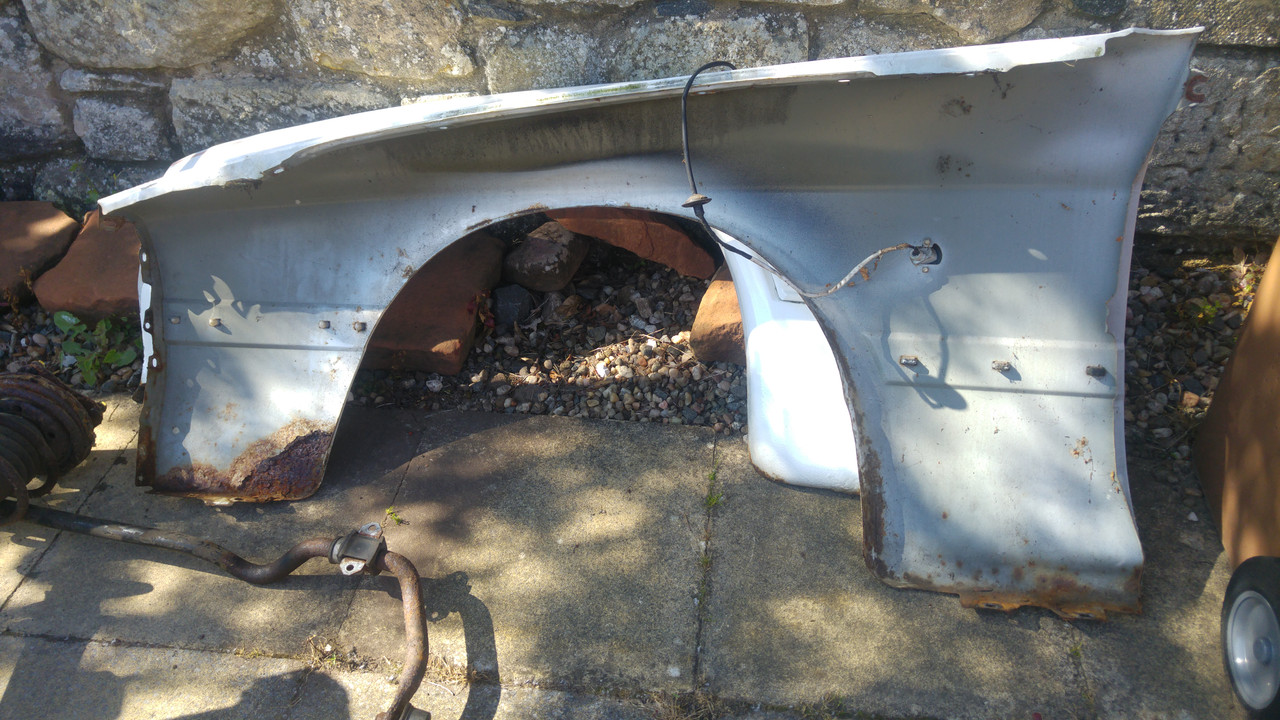

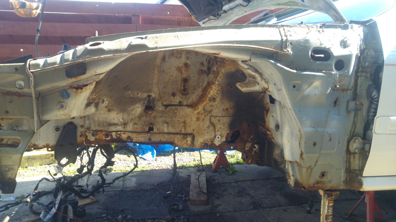

Ok so I'm pretty sure I've got all the parts off I need off. I have no excuses at all now but to get the Grinder out ... Scary times, a few more pics for interest since my writing isn't particularly interesting :crazy:
Before the car goes back together I'll need to spend time derusting and replacing bushes etc...
I'm not sure on the condition of the wings, they look pretty rotten at the bottom..
And I'm still undecided on hydrate 80 vs bilit hamber rust removal gel for after the rusts been grinded off as much as possible....
Some pics
Rich

ian65 wrote: Sat Jul 27, 2019 6:54 pm it doesn't look too bad for a convertible... both of the verts I had were like sieves
I thought it looked horrendous at first.. But I don't know if I've been smoking something or just getting used to the holes but I'm sure it's getting more fixable the more I look at it ...
The wings look like I'll need to do some sore of repair...

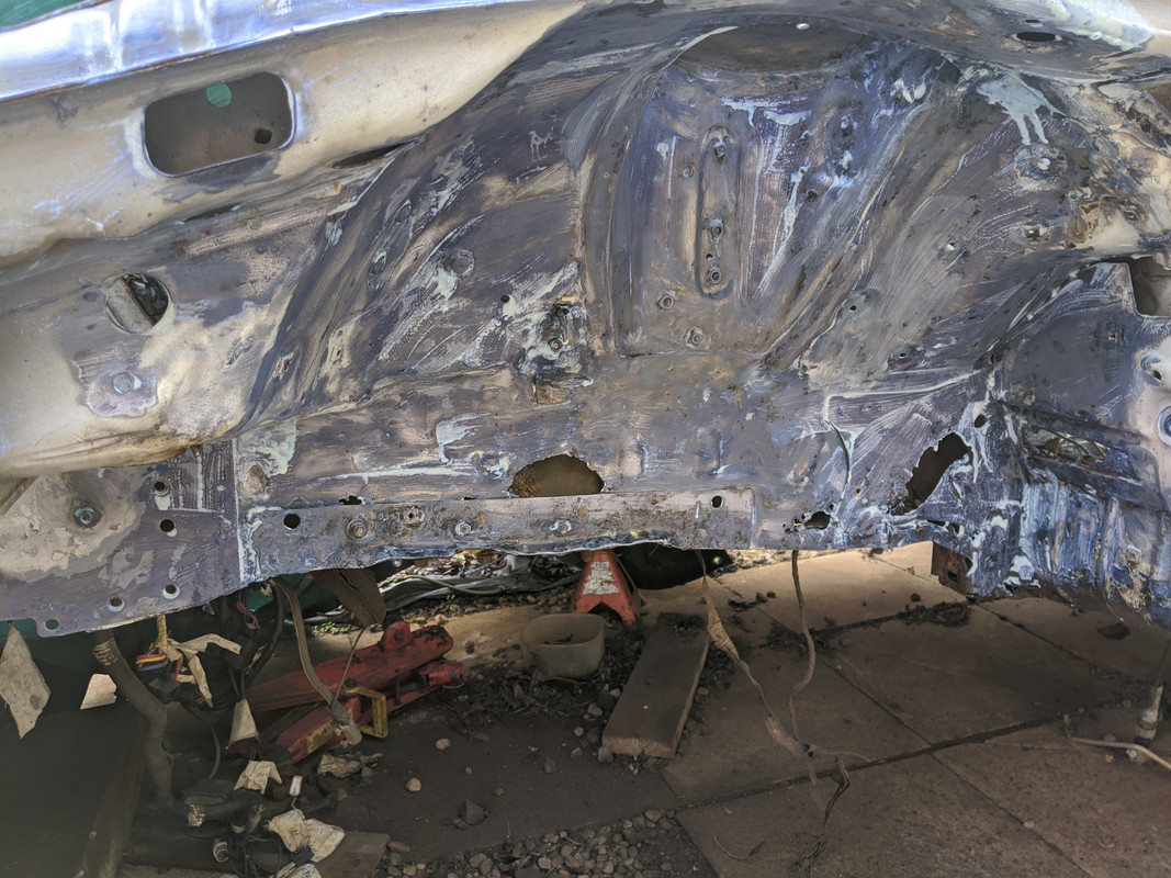

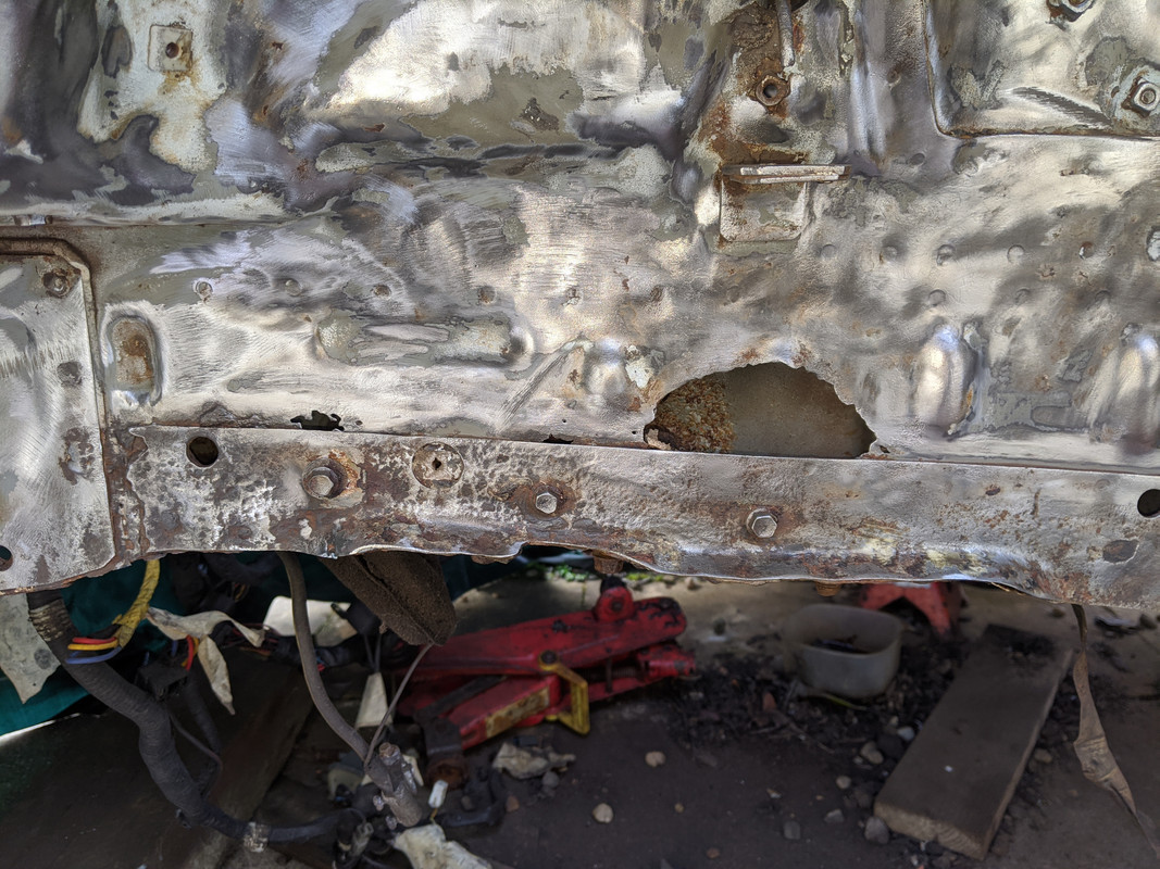

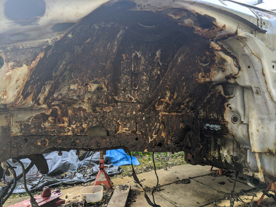

It's amazing how much work can be summed up with a couple of pictures. But I'm definitely at the stage where I can't really ignore having to cut out metal next :lol:
So in the following pictures I stripped the inner arches with a grinder back to.metal.
made up a home brew Billit Hamber detox mixture, treated the metal and rusted areas.
Cleared it off and re hit it with a grinder revealing more holes and covered the area with posphuric acid
So it has some protection now, just a quick coat of epoxy primer over the next few days if this weather holds :thumbup:

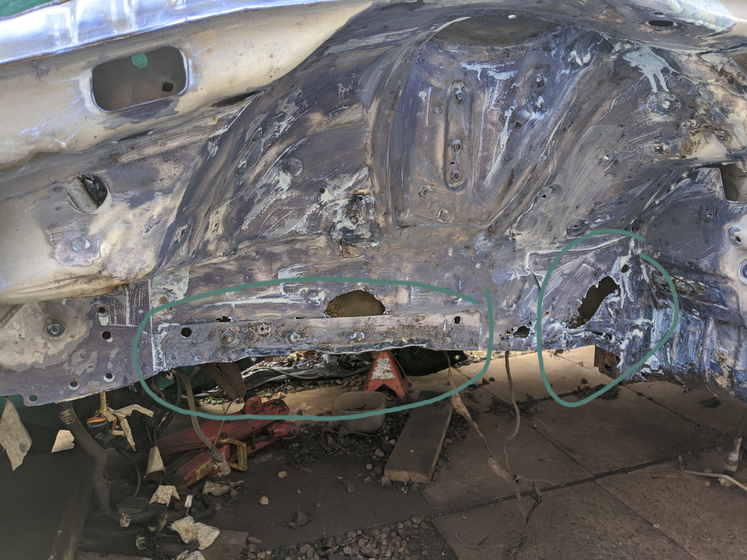

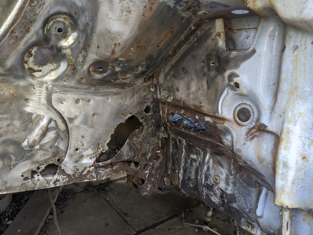

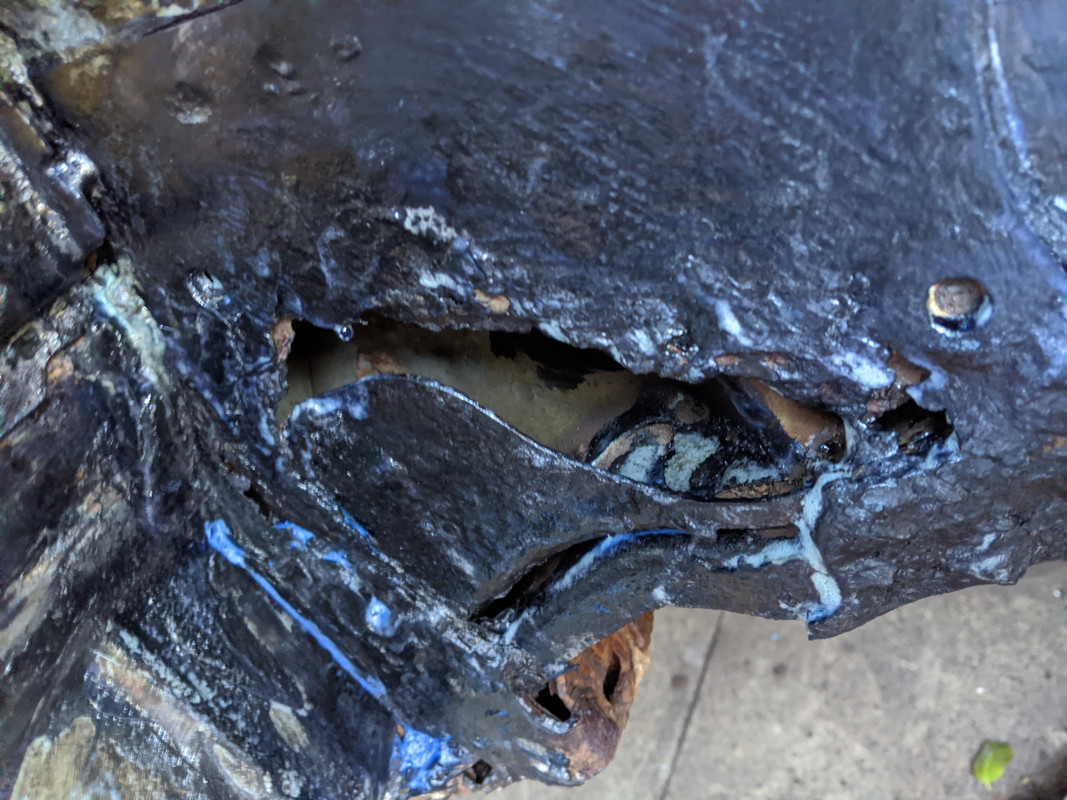

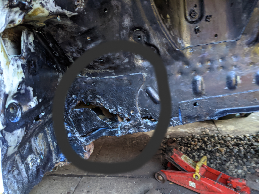

So my next thought is to drill the spot drills out of these tow bits of metal... See what lurks.
Can anyone advise if it's ment to be solid behind here?
And a close up of it helps
Rich
